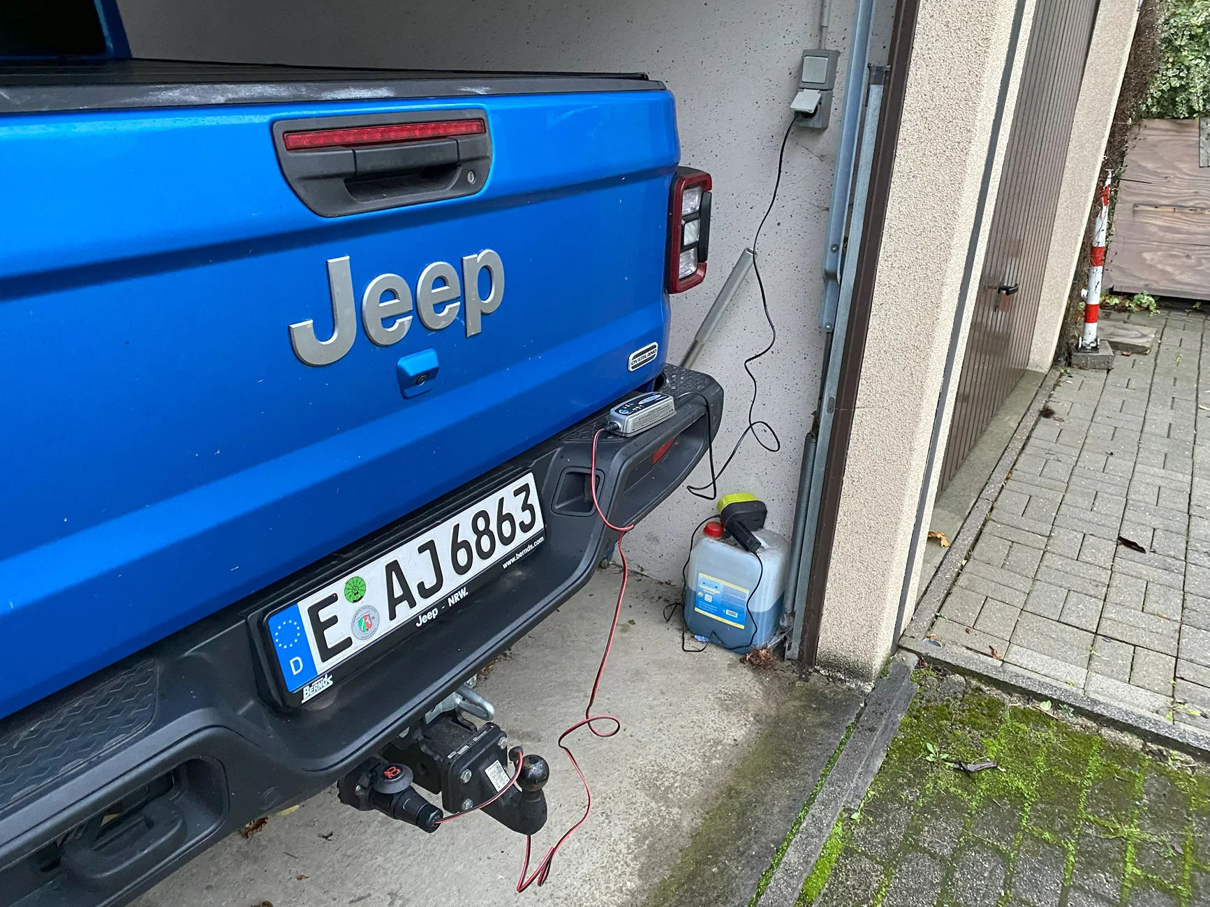

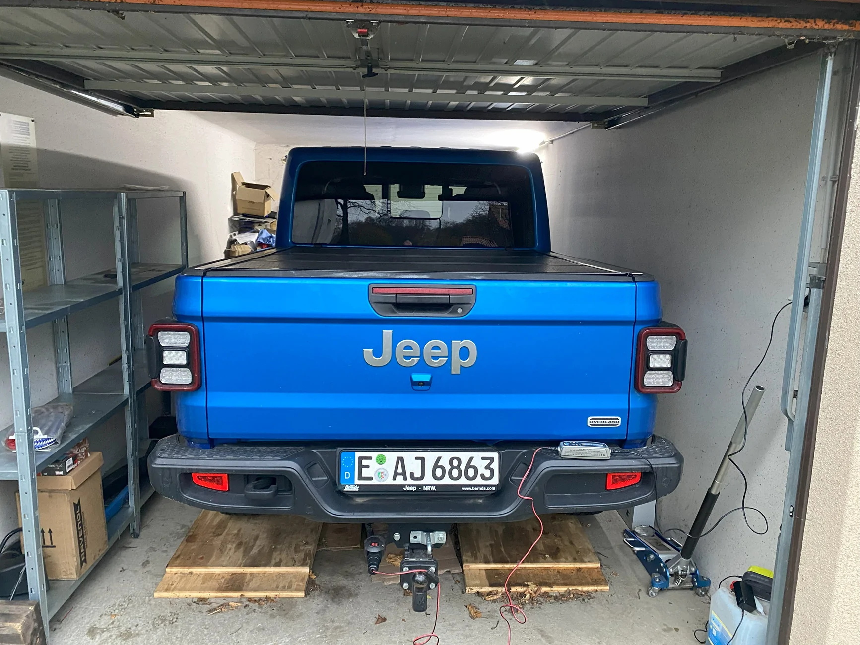

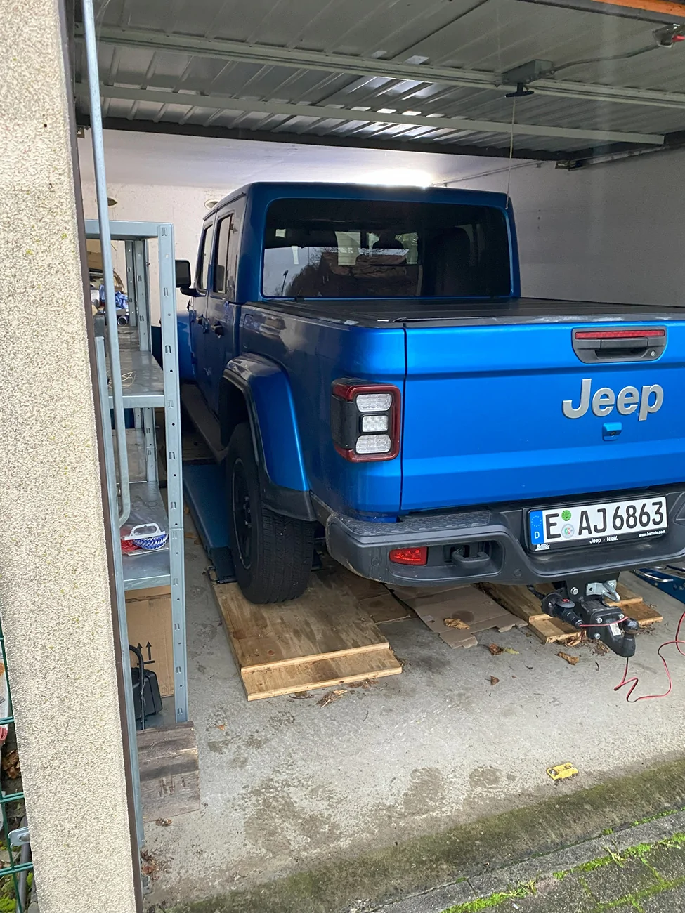

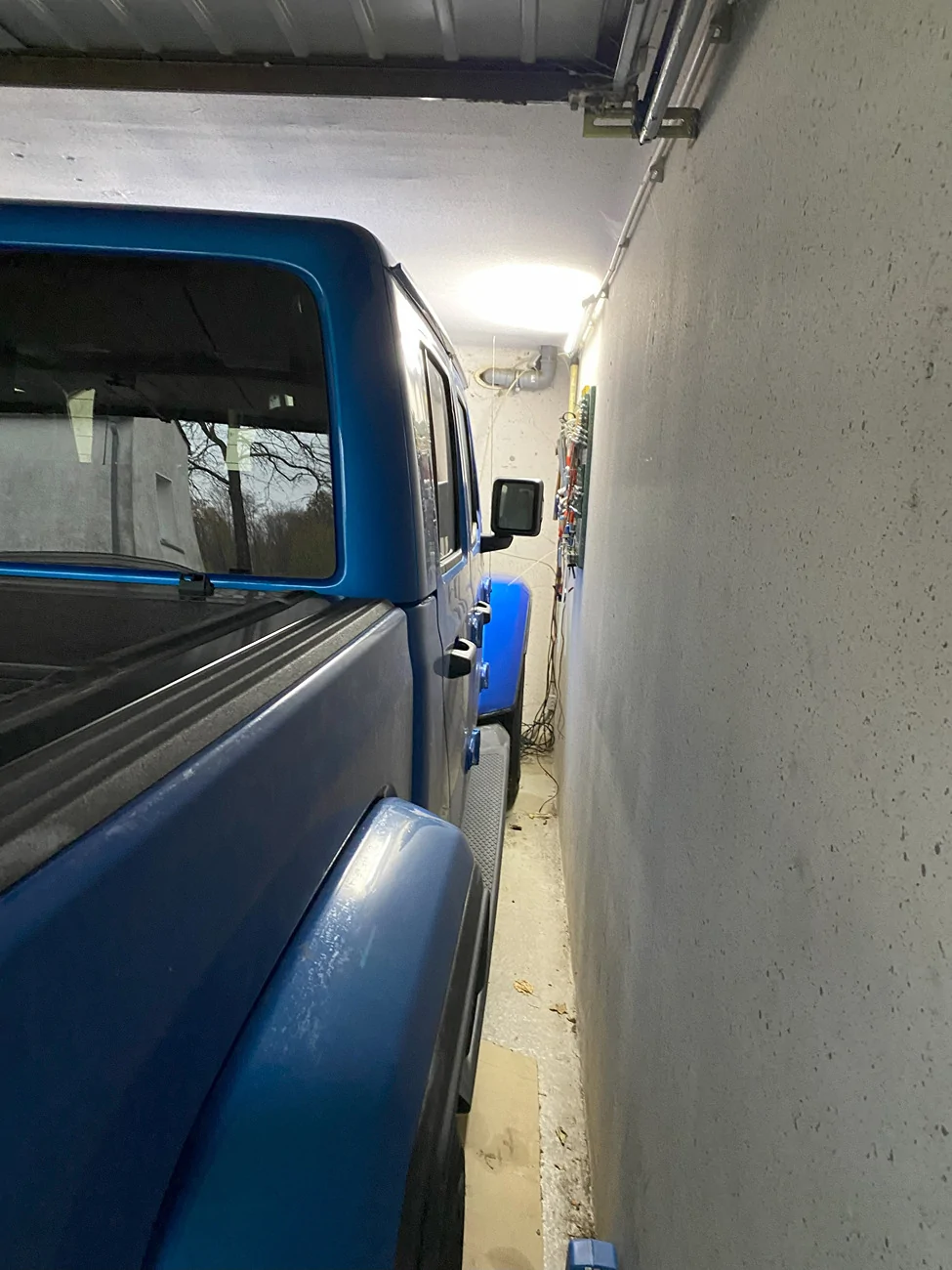

Seems that you have plenty of space, I have not even 1 inch spare.
Jeep Gladiator Stellantis sells VM Motori... IMG_4805
Jeep Gladiator Stellantis sells VM Motori... IMG_4806
Jeep Gladiator Stellantis sells VM Motori... IMG_4807
Jeep Gladiator Stellantis sells VM Motori... IMG_4808

In deed.
When I (regretfully) sold her
Jeep Gladiator Stellantis sells VM Motori... C5Z06-P_Hohe-8
I thought, give it a try, the Gladiator is not as wide as the Corvette and just a little bit longer.
And it figures out that it fits ...
