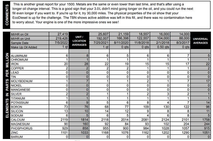

To be fair, the gen 2 EcoDiesel is not picky about oil. It's oil recommendation/specification already lists a low SAPS oil. Rotella T6 isn't high quality oil, but it could easily stay in specification for 10,000-mile intervals on a stock truck. We've seen Rotella T6 survive longer intervals on a deleted truck. Below, you'll see T6 lasing 14,000, 16,000, 18,557, 21,159, 25,607, and even 27,419-mile intervals!
