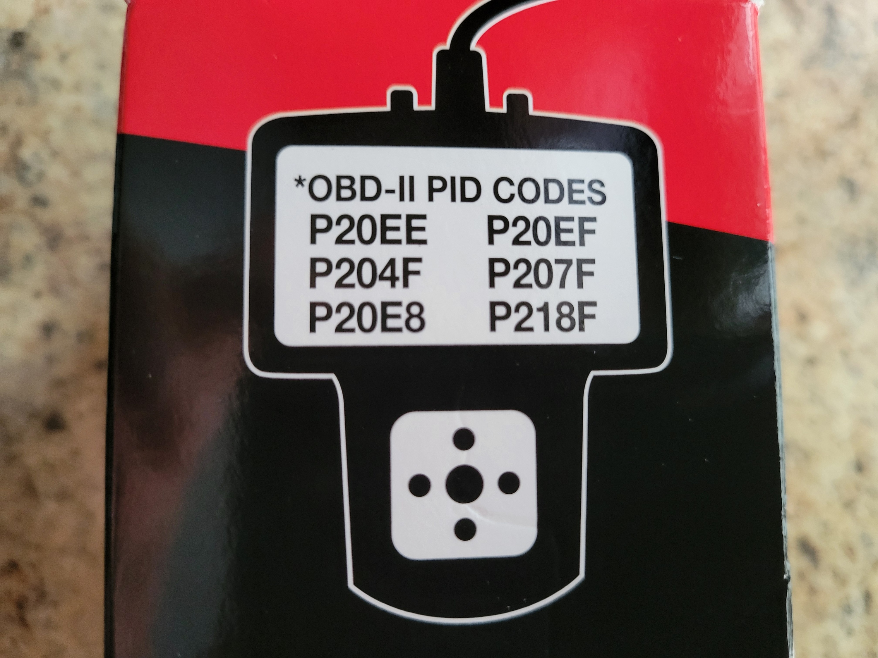

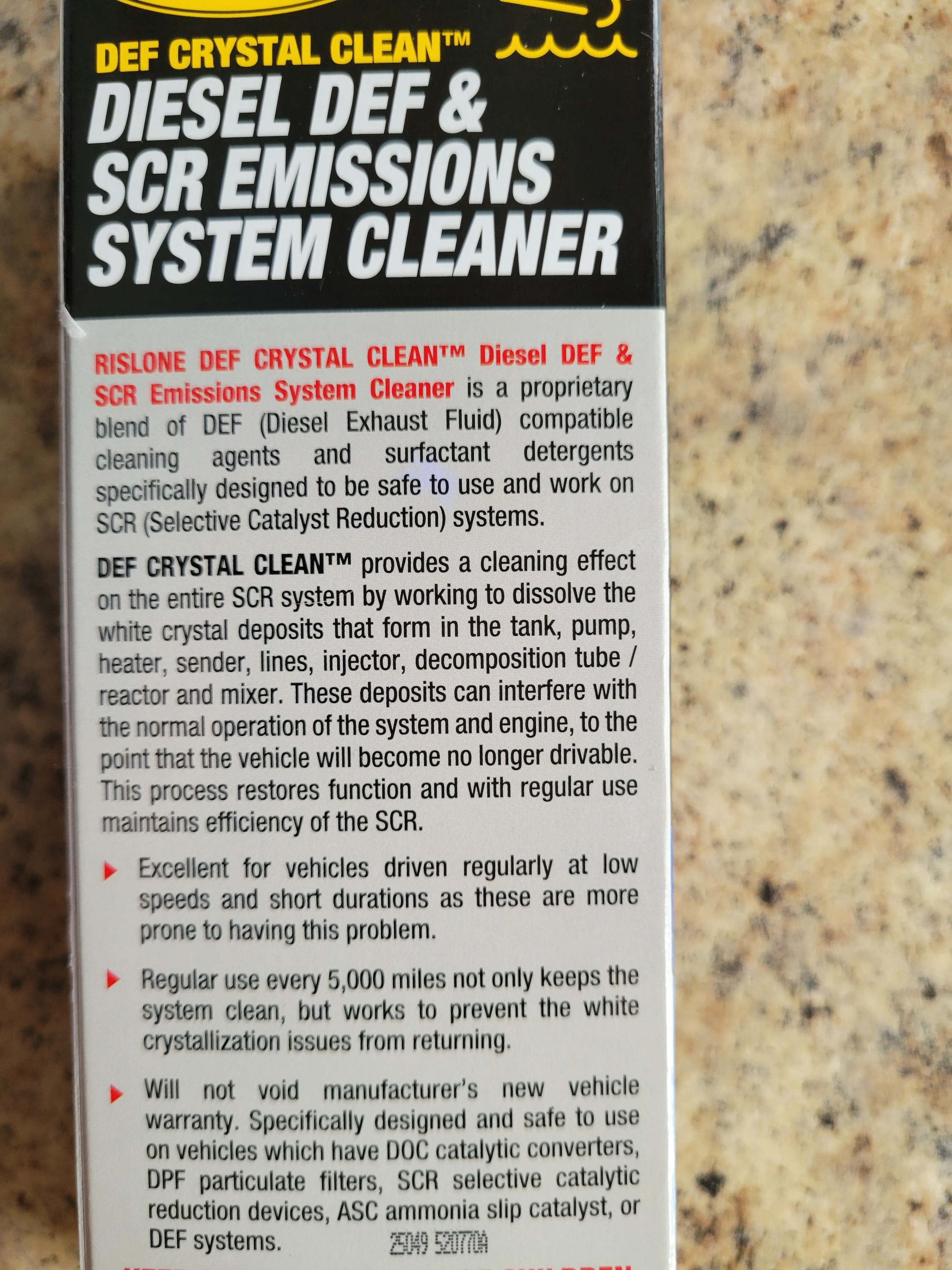

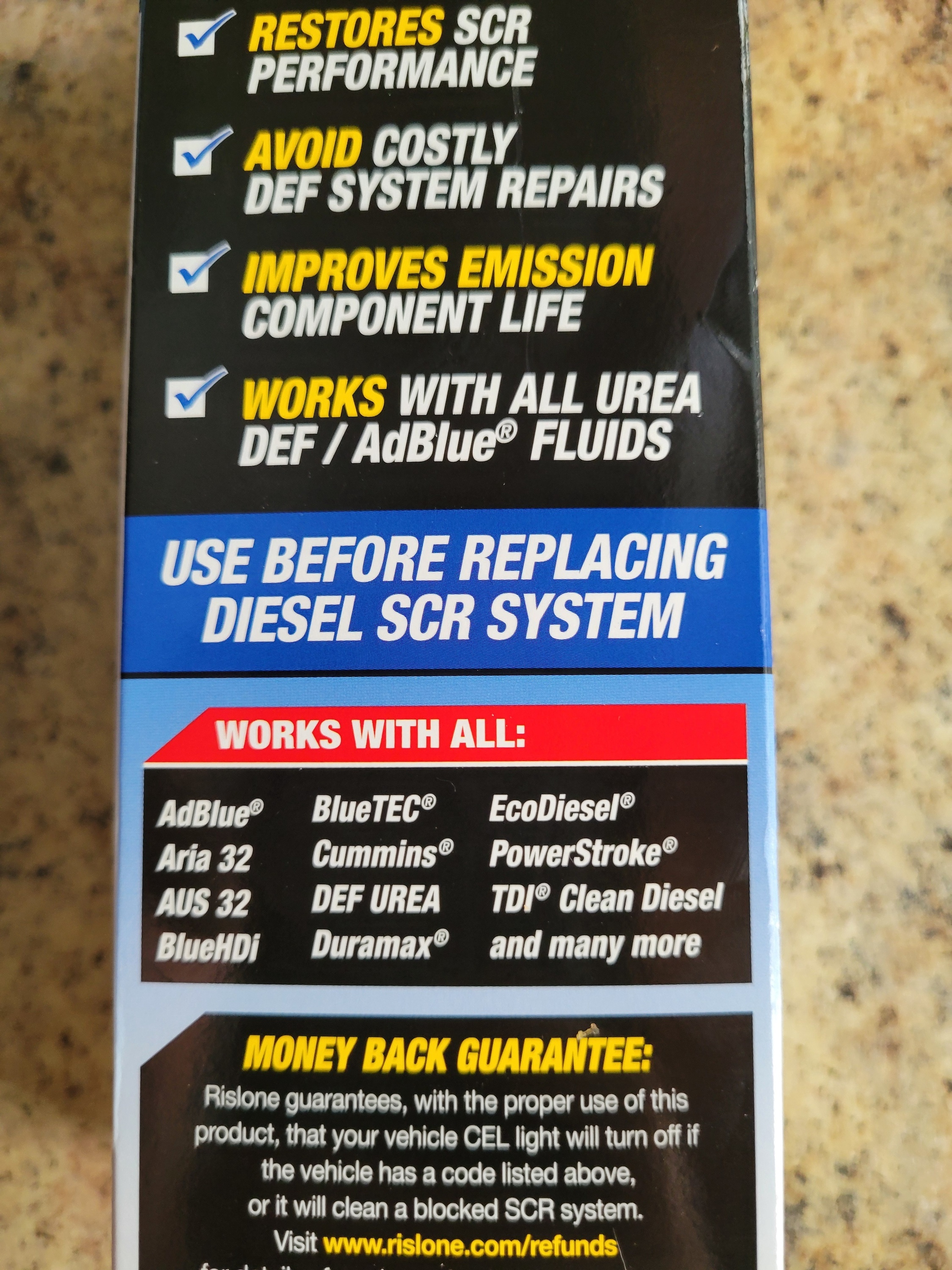

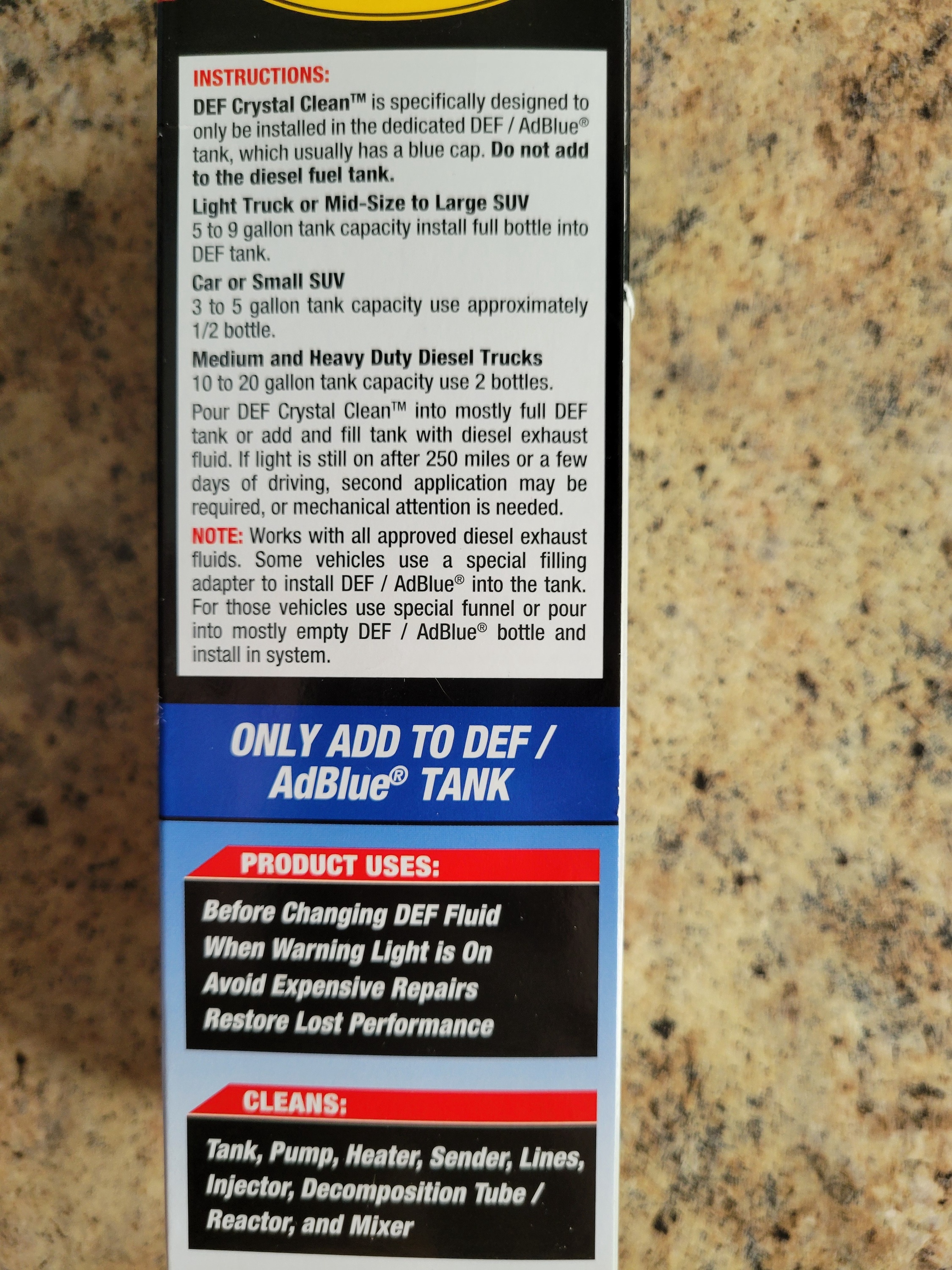

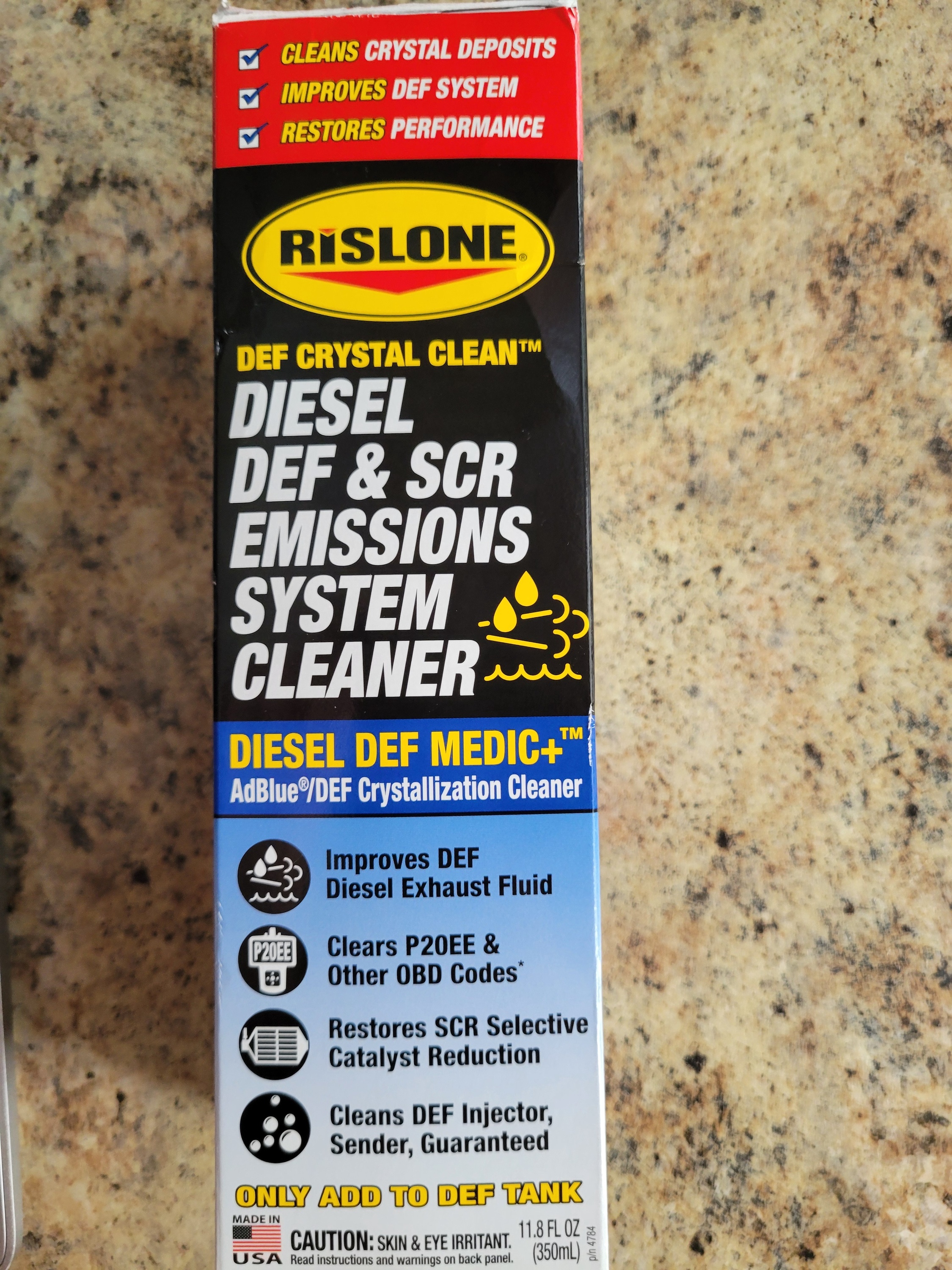

Am I the only MF'er here who checks his DEF gauge? Running out of DEF is about as dumb as running out of fuel.
It would be purely neglect to run out of DEF since the system issues a low-level warning. I typically top mine off when it gets down to the 1/2 mark.
I also highly recommend using Rislone DEF & SCR Cleaner every 5,000 miles. This stuff is magic in the bottle.

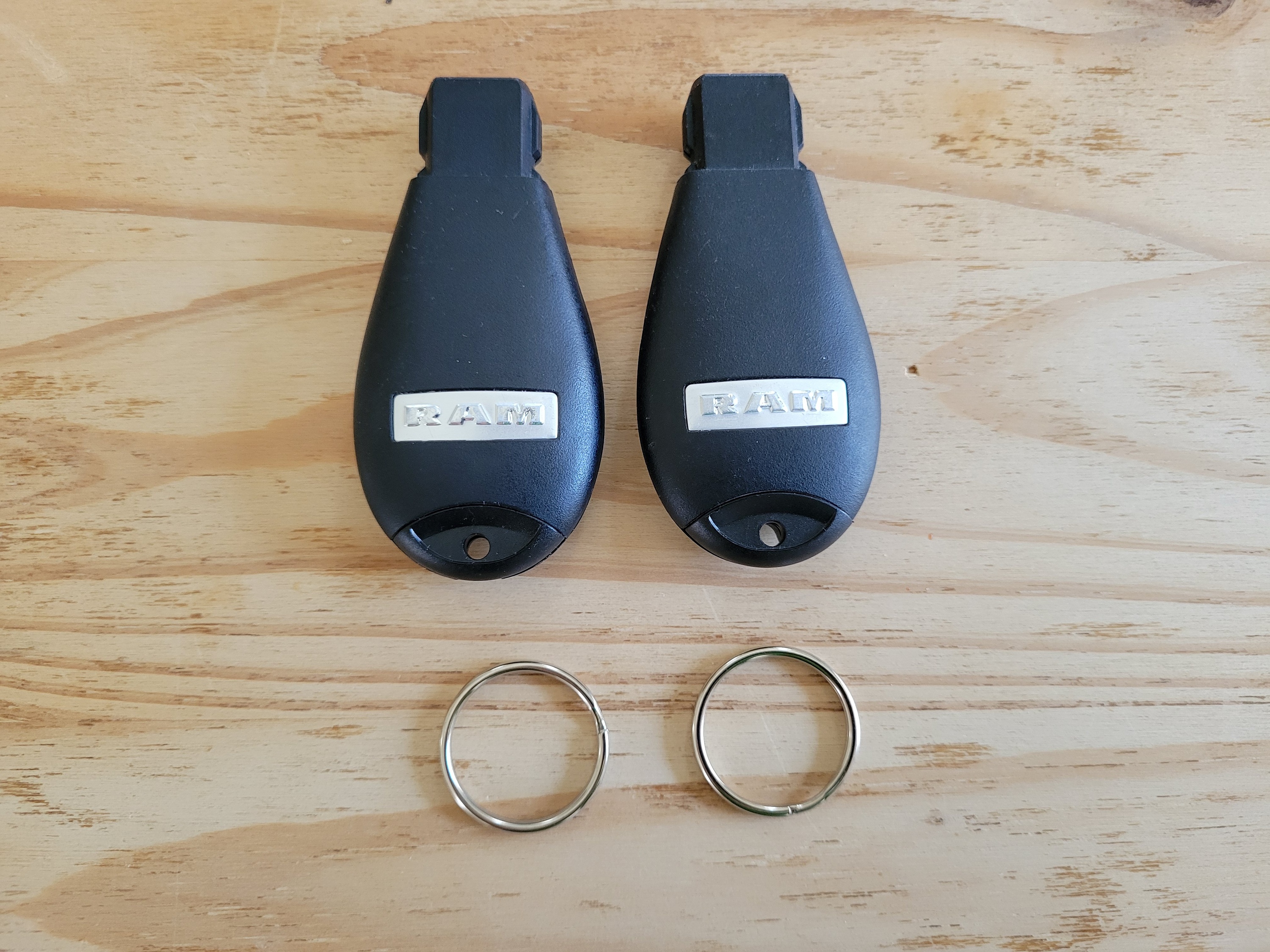

$99.98 Key fobs for 2 seems a steal, or what was wrong?
I had one of the original key fobs fail. After taking it apart, I noticed that one of the contacts had separated. Since the truck is a daily driver, I decided it was time to order two new Mopar key fobs. I then used AlfaOBD to program them.

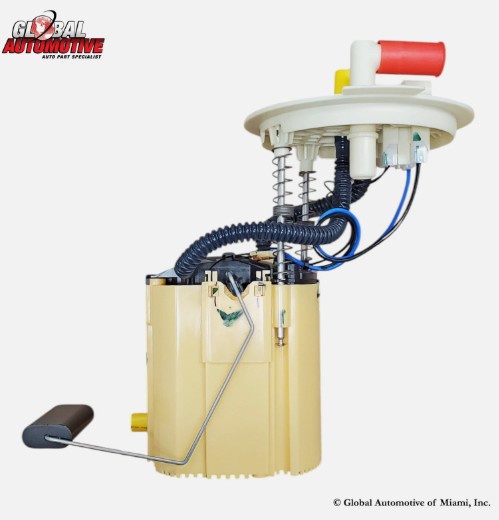

Here's what the lift pump looks like:
Yeah it's weird, I was researching these a while back and kept coming up with nothing, and combined with Google stating the gladi doesn't have a lift pump so I just assumed they didn't. Turns out it depends which computer I use if the parts catalogs fully load. Work laptop, nope doesn't fully load, personal surface pro and then it fully loads.
Strange.
I'm using Platinum DEF. Are you as well and using the DEF Crystal Clean every 5k Miles?
I use both Platinum and Rislone DEF & SCR Cleaner. And yes, I try to stick to that 5,000-mile recommendation. The 2015 Ram has an 8-gallon DEF tank and the 2020 Ram and 2023 Jeep EcoDiesels have a 5-gallon tank. I use one bottle per vehicle.
Between three vehicles, we've been averaging just over 2 gallons of DEF per month. Starting in 2026, I'll separate DEF usage based on vehicle.
