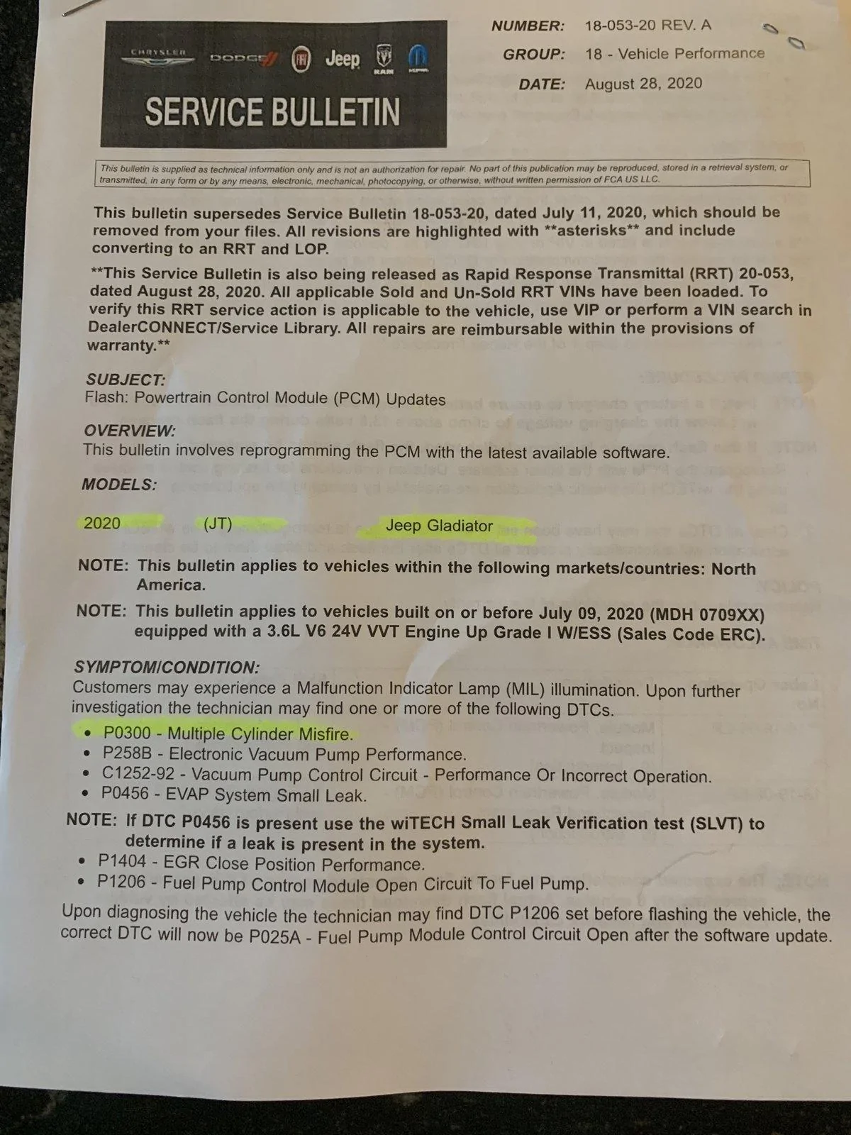

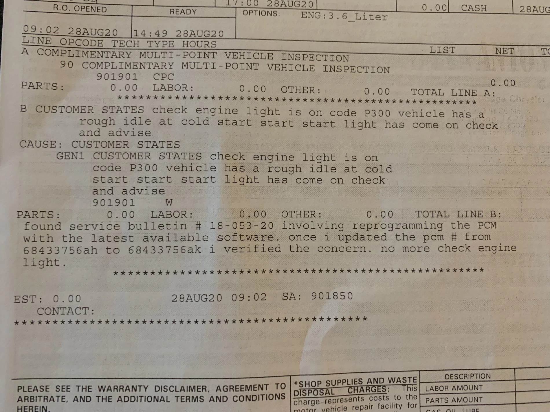

Just got back home. Dealer told me they flashed it and drove around to make sure it was fine, mileage was identical to when I dropped it off - they maybe did a circle of the parking lot, but sure as hell didn’t drive it anywhere else.
That said, whatever they did to the PCM is making it feel peppy as hell. He told me they sent me a video of the testing showing all cylinders firing properly, but I got no video. They said, “maybe it will show up later.”
I’m attaching what they did as well as the updated TSB with the update released today. You’ll see it is directly related to the P0300. The service manager told me these P0300 codes are erroneous and are not right... so this flash will “fix” the firing and make sure the computer doesn’t get it wrong anymore. This entire thread proves otherwise, but I just wanted to give all the info I have. I put about 40 miles on it driving home, not a single issue yet.

Hmmm - a search of NHTSA does show a TSB about the engine miss and points to a PCM update - specifically mentions the codes talked about in this thread and others. Blames it on PCM software. I downloaded the PDF for the TSB and according to this the dealer is to upgrade the PCM - several things are impacted resulting in the same errors as mentioned here.
I noticed they have the one from July 11th, 2020 but not the Rev A that replaced it on August 28th, 2020.
