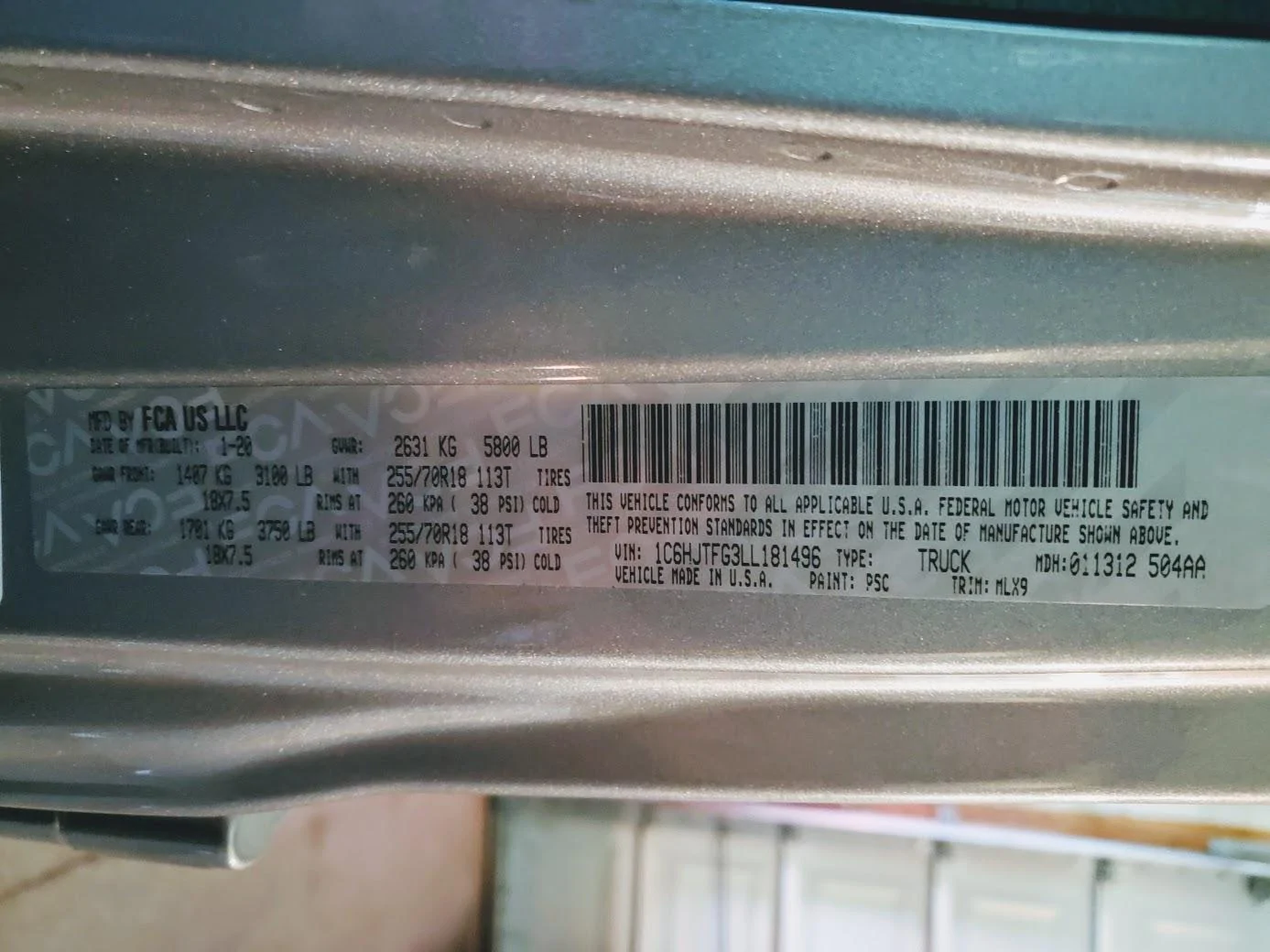

I've noticed the ESS messages since I got the vehicle on 8/11/2020. I've also noticed hesitation/miss-fires when at low speed and not fully warmed up. Yesterday was the first time I got the CEL. SOOO excited I get to play this game. =(
Build date: 01/12/2020 12:00pm (from MDH)
Engine build country: Mexico (per window sticker)
Mileage when it first occurred: 176
How many times has it occurred: 1
What exact codes did it throw: P0300
Is the issue on going? Y
If so, what has been done to try to solve the issue? Nothing yet, scheduling with service now.
Was the issue ever fully resolved? N
Jeep Gladiator Survey- For those with misfire issues 1599239480126
Scheduled to take it in on Tuesday morning (9/8). We'll see what happens after they flash the PCM. Fingers crossed.

Full build date is on the door frame decal - look for MDH which will be upper right as you stand upright, or lower right if you tip your head to read the decal as printed.
MDH is Month, Day/Date, Hour.
If it reads 101514 that means 10th month, 15th day, 14th hour (2 pm)
I have several post here explaining this with pictures and people still can seem to figure it out. I'm seriously thinking that this survey is just a lost cause at this point. You can lead a horse to water..... :facepalm: :headbang:
