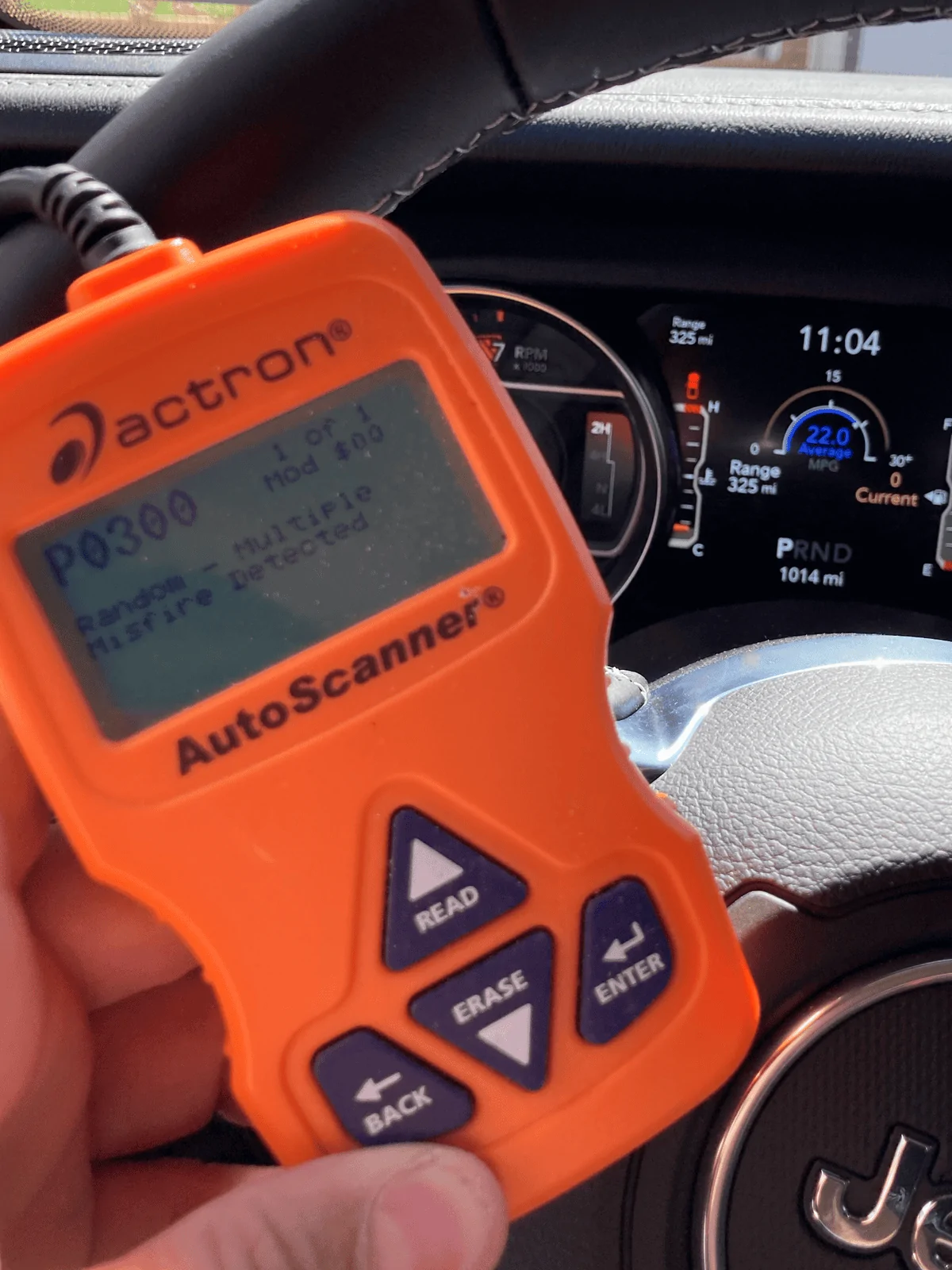

Since I purchased my truck I have always though that the idle was quite rough but never thought much of it. I have also had the AutoStart/Stop Disabled on several occasions but once again didn't' think much of it. My check engine light then came on but went off 2 days later. It came back on the next day. Used JScan to check for codes. I had P0300 pending and P0300. When I saw it was a misfire I remembered I see this thread often but have never explored it.

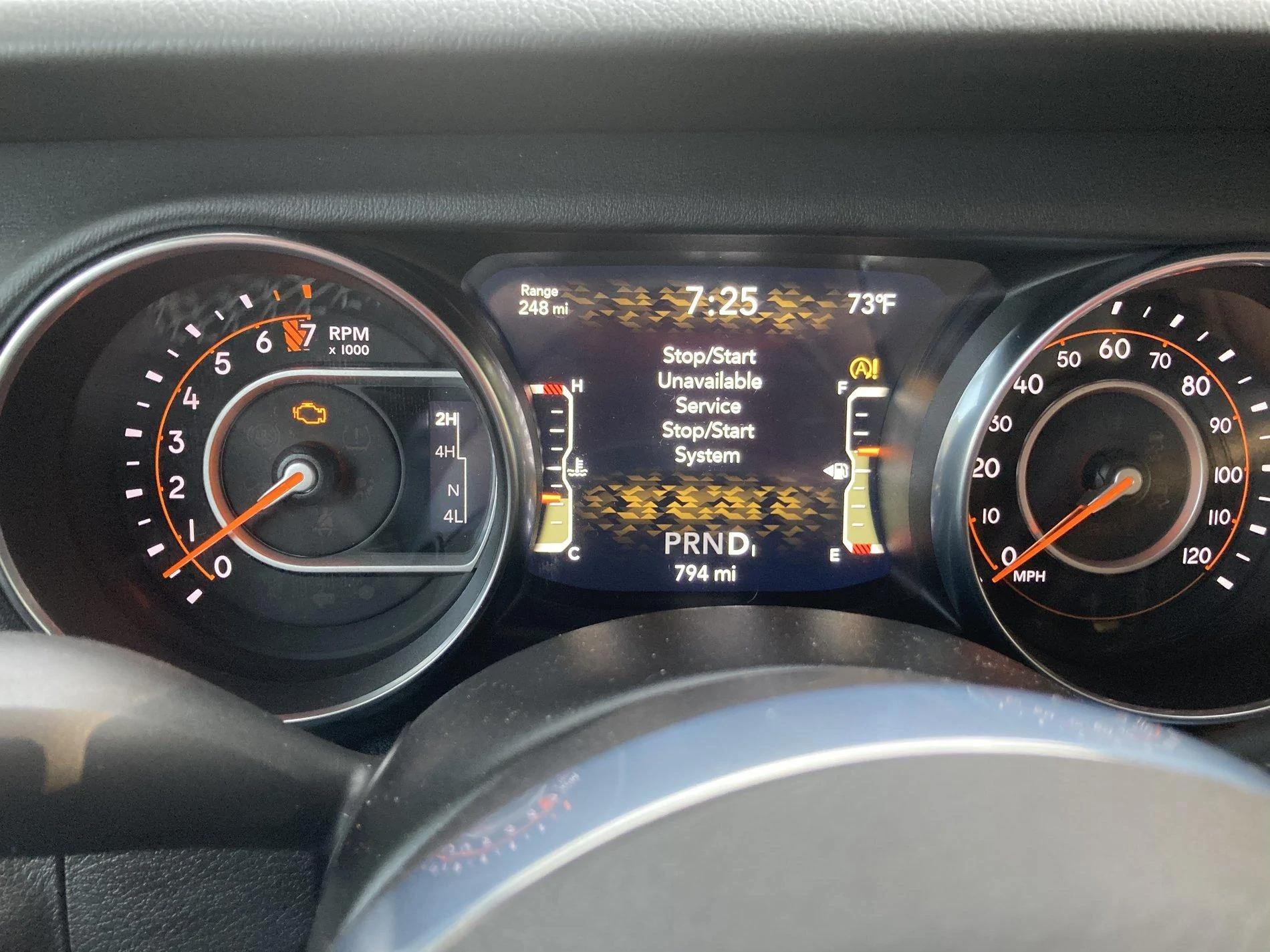

Mine goes in tomorrow. stop/start issues intermittently since about 450 miles and the Check Engine Light came on on Thursday at just under 800 miles. both lights are off now and I put over 100 miles on it yesterday without issue. Although, it feels like there’s a slightly rough idle and a stumble at idle. I guess I’ll see what they want to do. CEL isn’t currently on, but I want them to read the saved code and record it in the system so it’s established as a problem. I read the code and is P0300 as I feared.

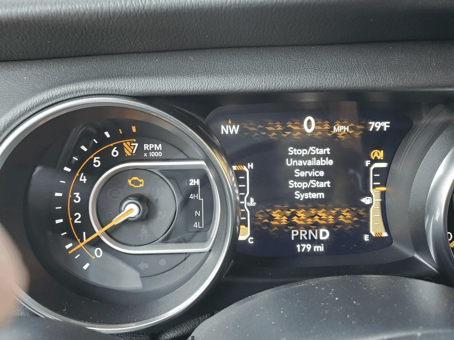

Well mine finally got it's second outbreak of P0300 today. ESS has been giving errors every time since yesterday and sure enough, P0300 was right behind. This time however, it sounded like it wanted to stall and I barely made it home. Only put 2000 km on this JTR and this is the second time I will have to bring it in for this error. Last time they didn't do anything besides clear it however, so can't say I am surprised it's back. Guess I will have to change my plans to drive across the province next week now.
