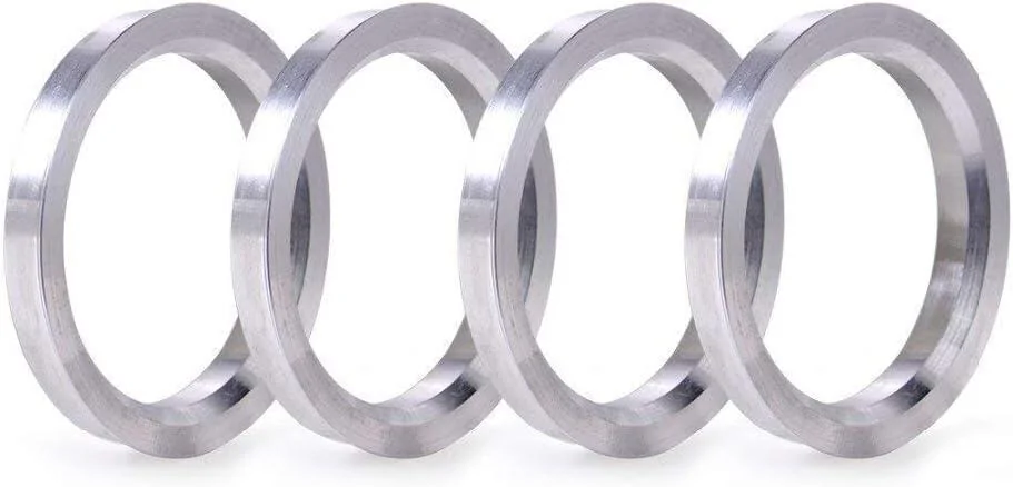

I've been doing this almost to a T all my life. The only thing I did different was
1. not skip a lug nut
2. tighten them finger tight first, rotating the wheel several times
3. lastly use the lug nut wrench to tighten them again before lowering to the ground and finally torquing them.
I think my grandad taught me that around 1980. I despise tire shops torquing them and won't let a shop rotate my tires ever.
The big thing is to give the wheel a chance to center on all of the lug nuts. Tire shops mostly hit the first lug nut with their impact wrench, locking the wheel into position referenced to just that one lug nut.
I was having a similar problem as the original poster on my 2004 TJ until I learned to use4 this procedure to install the wheels. The big clue for me was that my tires were wearing out-of-round. I would recommend that Jeepers get hub centric adapter for your aftermarket wheels (if they are not hub centric).
