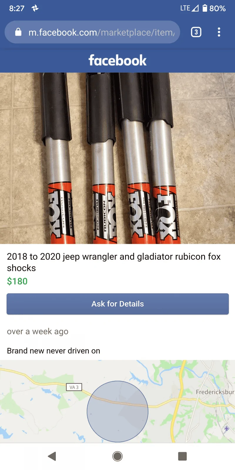

Not sure if your serious here...
I am serious, you can find them on Craigslist, letgo, offerup, and marketplace. I haven't had any problems finding them when looking for Jeep Gladiator parts. Plenty of takeoffs to find. Here's one of at least 6 listings on Marketplace in my area that has them for sale. Brand new for $180, just saying not sure why they removed them but the did.

Thats not the part I was questioning. I already said I was buying em cheap.
Seriously people lift there jeeps & with lift for offroad comes new shocks & then the factory Rubicon shocks get sold cheap.
My point is most I've talked to that removed them didn't need to remove them as they didn't go much higher in Lift, only maybe a 1.5" spacer lift and still removed the shocks. So why remove them if they are such a good ride over say Max Tow Shocks. I know what your saying, on a well built rig then yeah it makes since if your going 3 or more inches on a $3000-$8000 build then they would come off, I'm talking about the ones that are only going with a minor lift, which is the majority of what I'm seeing for sale in my area. I was seriously considering swapping mine until I noticed the trend and started questioning myself about if I really needed them or not. Then I went and test drove a few Rubicons and realized, not a difference really in ride quality other than a nice leather seat.
