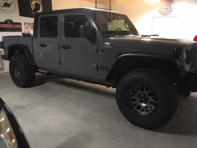

Sport S Max Tow with bushwacker flat fenders, 35's and NO lift. Have since switched to Rubi take off wheels so im not throwing road debri onto the jeep so much. Rides almost stock
Jeep Gladiator Suspension/Lift for 35's with emphasis for On-Road manners. F2
Those fenders look good. I have been debating on grabbing a set of tube fenders, but haven’t came across any I really dig. I’m going to check those out.

Got the Rubi Take off Shocks & front coils installed along with a daystar 3/4" front spacer. Got about 1 1/4" total lift in the front end & the back end of course stayed the same. There is now right about 1/2" rake down from back to front so its just about right for me.
Only drove it about a mile after so I dont really have a feel for how it handles, but seemed fine so far.

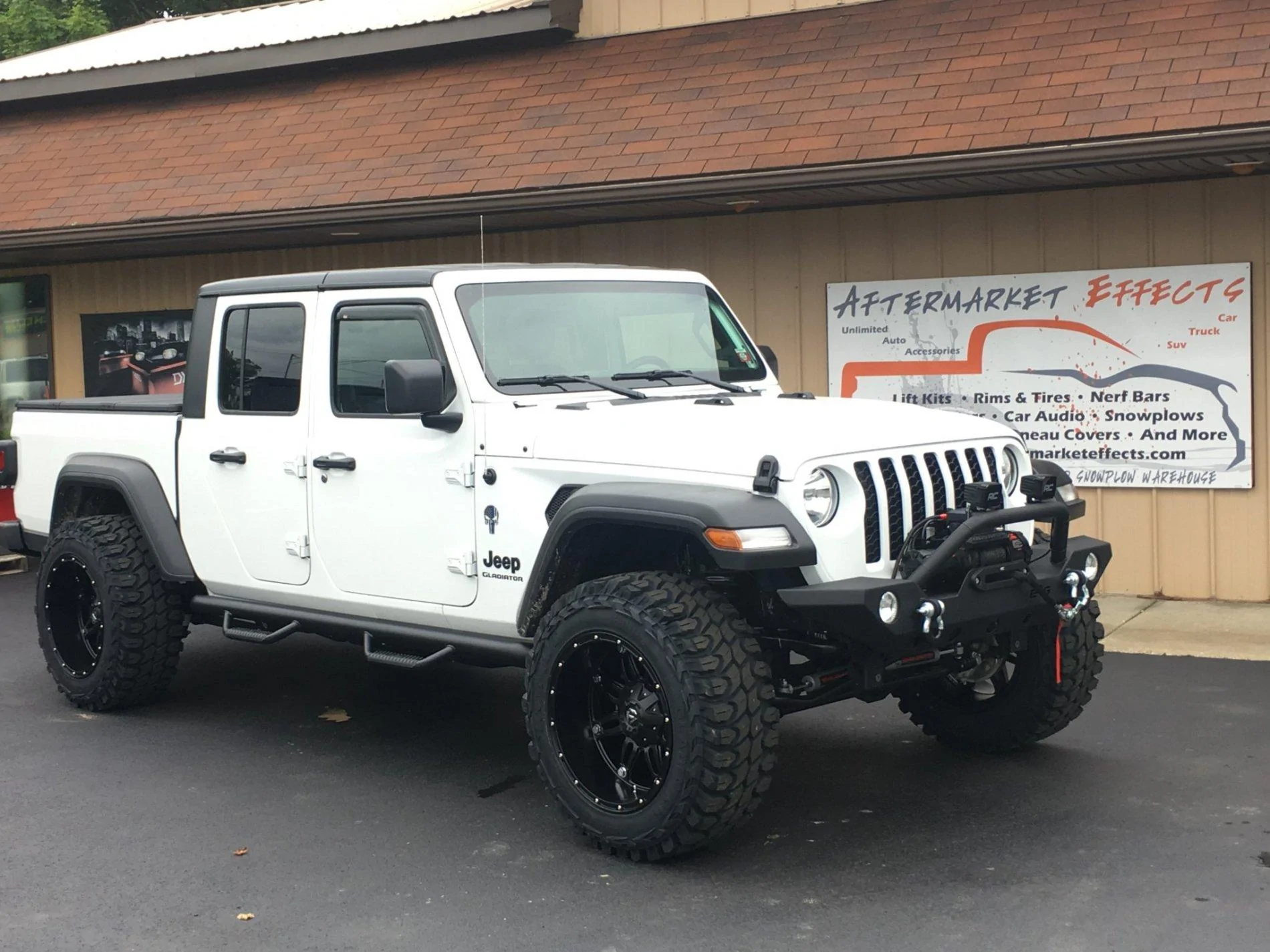

Rough Country 2.5" Lift with Dual Steering Stabilizer . 35X12.50R20 Tires.
Great look. I just ordered the same Skyjacker lift kit today, but with the 295/70 Ridges to keep the tires tucked in a bit. I added a steering stabilizer, but was not putting in a track bar for now. Did you add either of those to your rig? I'm also doing the speedometer correction as I pull trailers often and want to maintain good shift points, but not sure how important that would have been.
I added a dual steering stabilizer

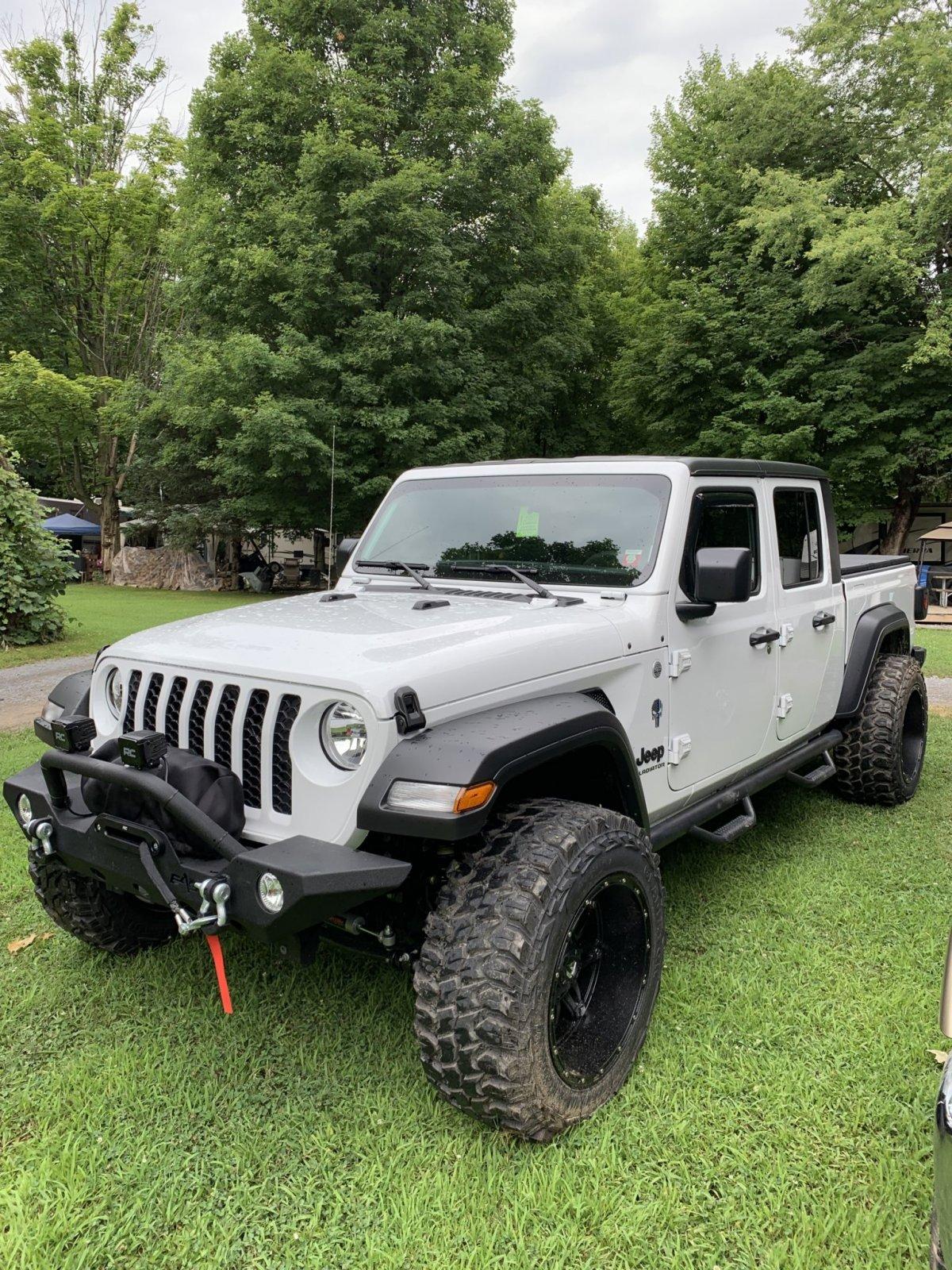

Aaaaannnndddd a month later now I am looking for a real lift.
What I have looks great and is fine on the road, but after one trail run I want bigger tires & more flex. Ordered a full bellypan already just to go a bit overboard on protecting the JT. Sometime in the next few days I am going to order a legitimate lift in the 2.5-3" range.
Already started buying parts for mine. Got all the front -end parts (Evo Mfg.) and the rear 1.5" lift JKS coils bought yesterday, and should be coming in this week.
I love the spacer lift, and there's nothing wrong with them, I just love tinkering and modifying vehicles. And at the time when I bought my JTR and the spacer lift, I still had LOTS of debt, and wasn't able to afford a "real" lift. Now that I've sold my Harley and eliminated about 2/3 of my debts, I can afford to start piecing it all together.
