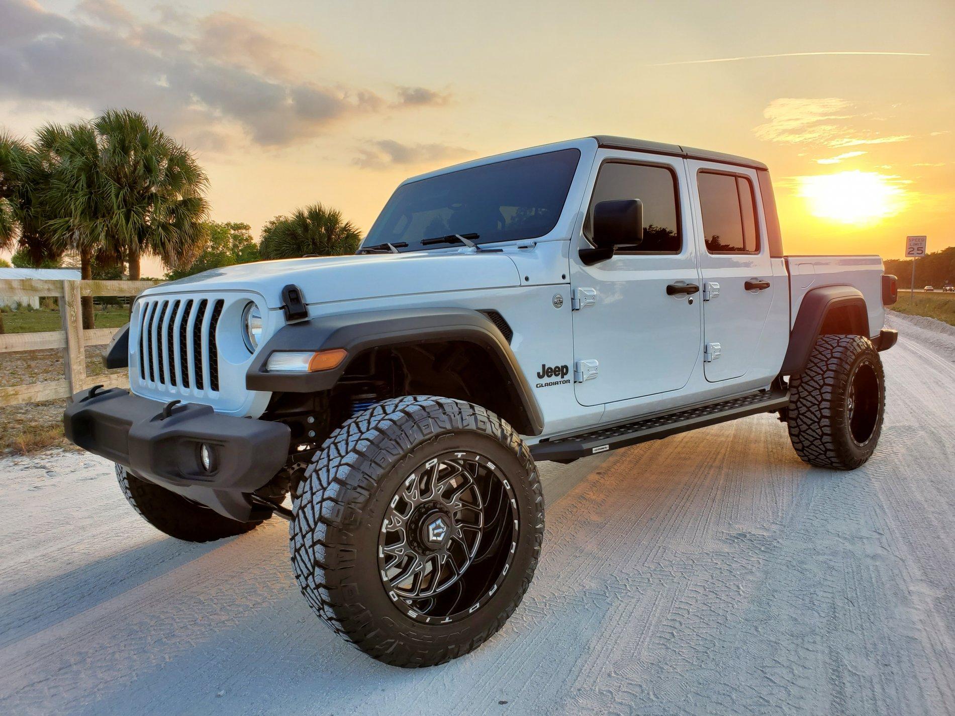

I have a sport s (non max tow) with 2.5" Skyjacker suspension lift G251PBLT with a jks adjustable track bar on 35x12.50x20 Nitto Ridge Grapplers and 20x12 Tis 544bm rims -44 offset. Zero rubbing or trimming. Rides great, I highly recommend this setup. The lift comes with all new coil springs and shocks, currently on sale from Morris 4x4 for like $400. I wouldn't run spacers when you can get a real lift kit for near the same price. When getting an alignment make sure you go to a good shop that will install a camber/caster sleeve. Crappy franchise shops will tell you that you can only adjust the toe. They are wrong. Fyi I powder coated my coils blue, they come black.

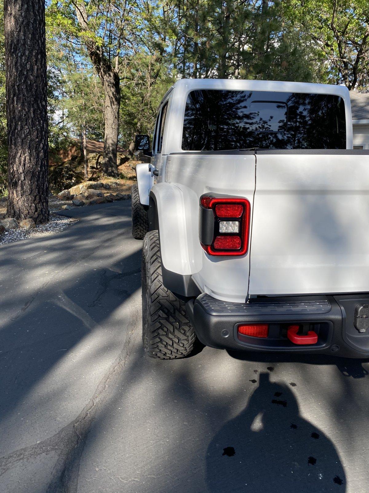

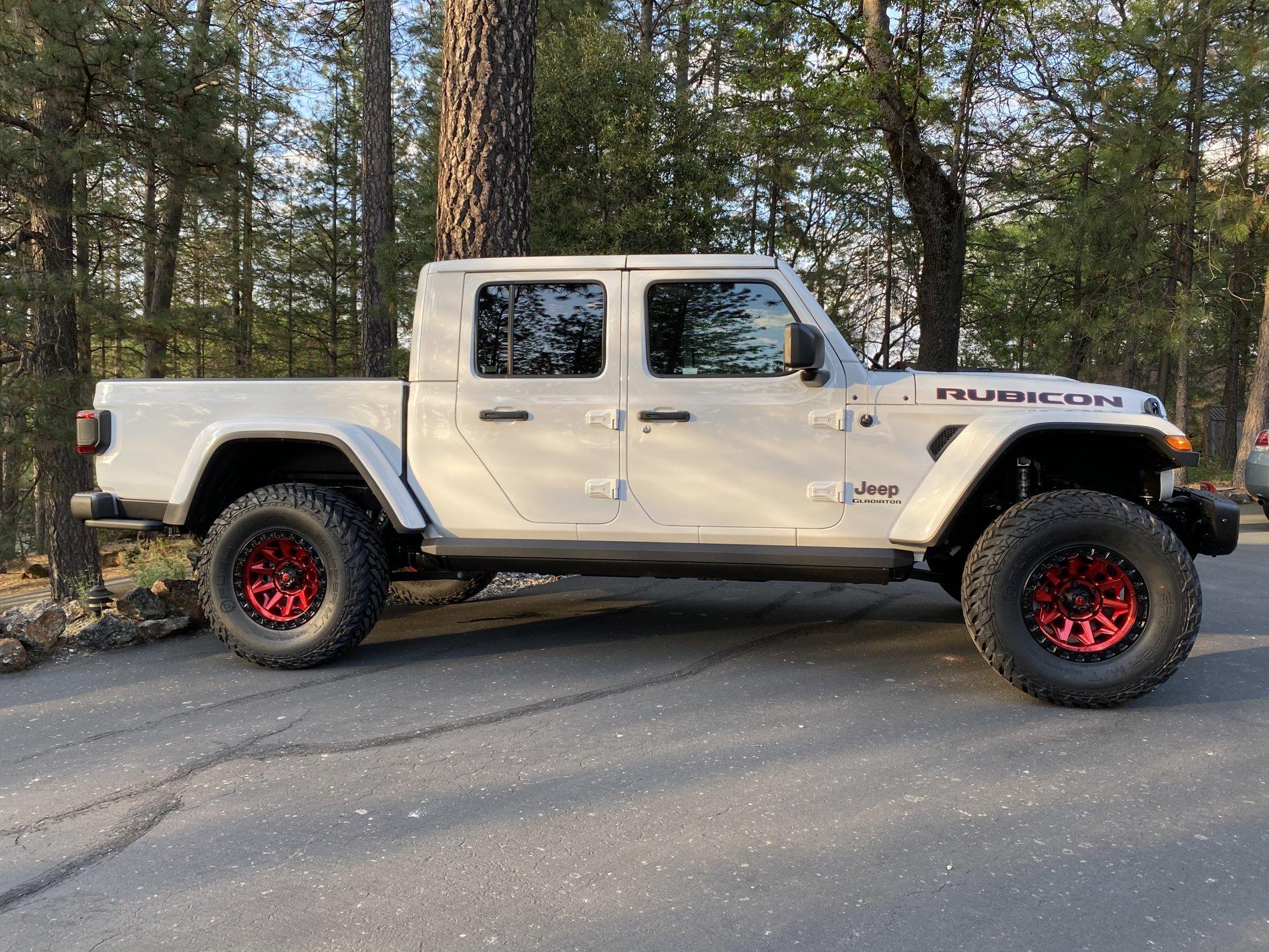

I went with the Mopar 2” lift, 17x9 +1MM/5” backside Fuel Covert wheels and 35x12.50-17 Fuel Gripper M/T tires. The ride is super nice and the stance is just about right for me.
