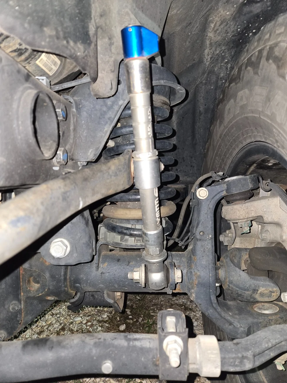

Jeep Gladiator swaybar front disconnects........... 1000010497

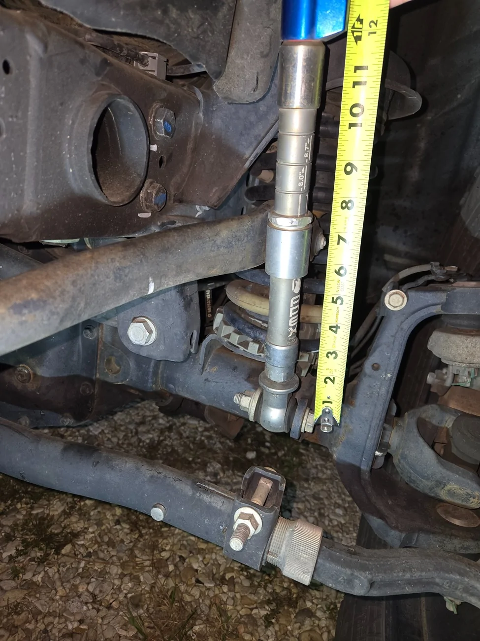

Jeep Gladiator swaybar front disconnects........... 1759193495891-0c
Looks like the brackets add at least another inch

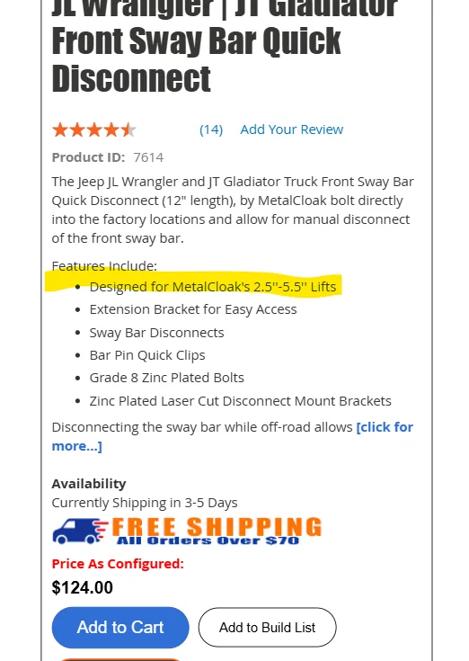

The only disconnects I found from your company say this - (and I don't run a lift at all - so the links are short)
Jeep Gladiator swaybar front disconnects........... 1759255939784-5r
Love the looks and - no cutting of the stock axle link mounts, but with no lift, they'd be way too long.

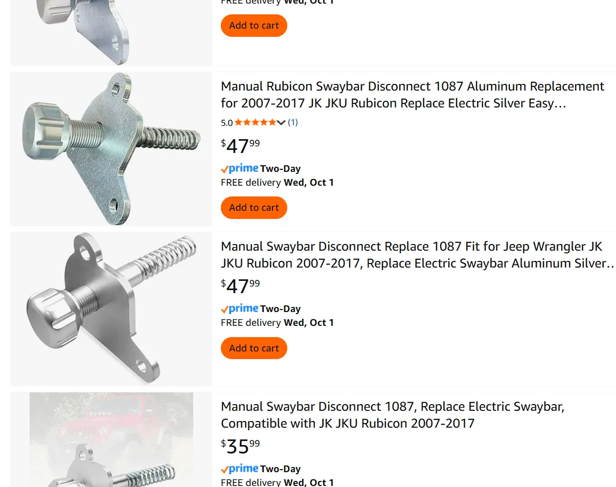

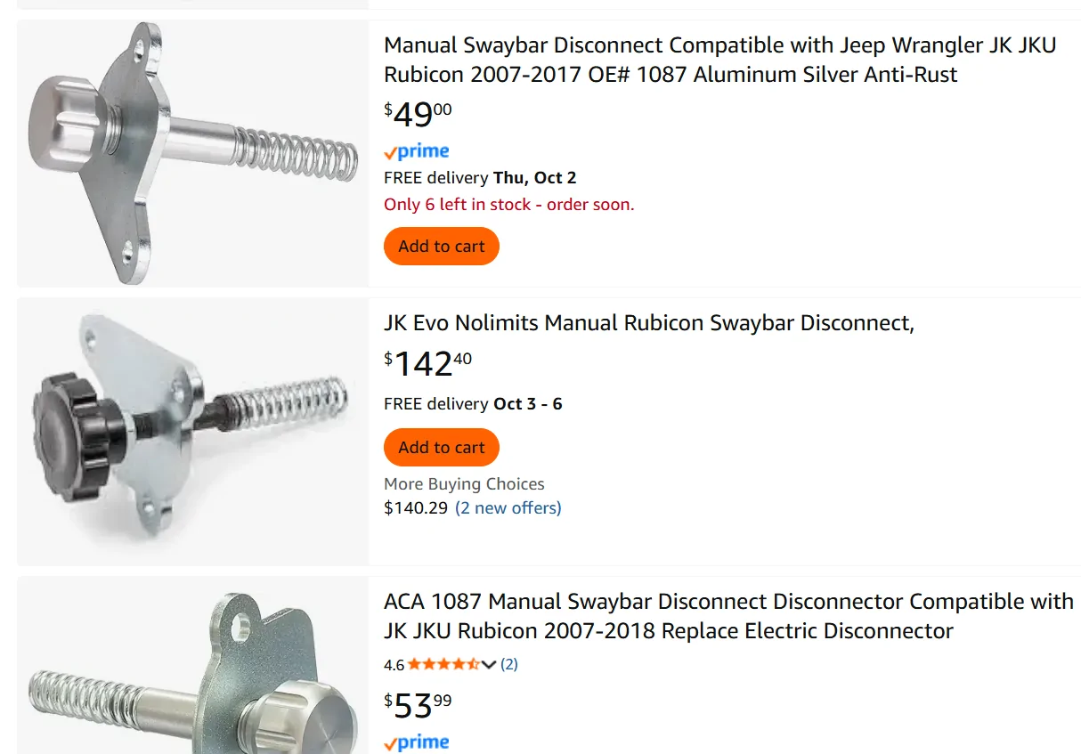

Rubi disconnect with the Evo manual release would have been the route I'd go if I had found one for less than a small fortune.
40,445
53,879
Go to Amazon and type in "jeep rubicon manual sway bar disconnect" LOL - wow.
(one guy in a different Wrangler forum even made his own with a steel plate, a nut and an eye bolt with a spring on the end)
