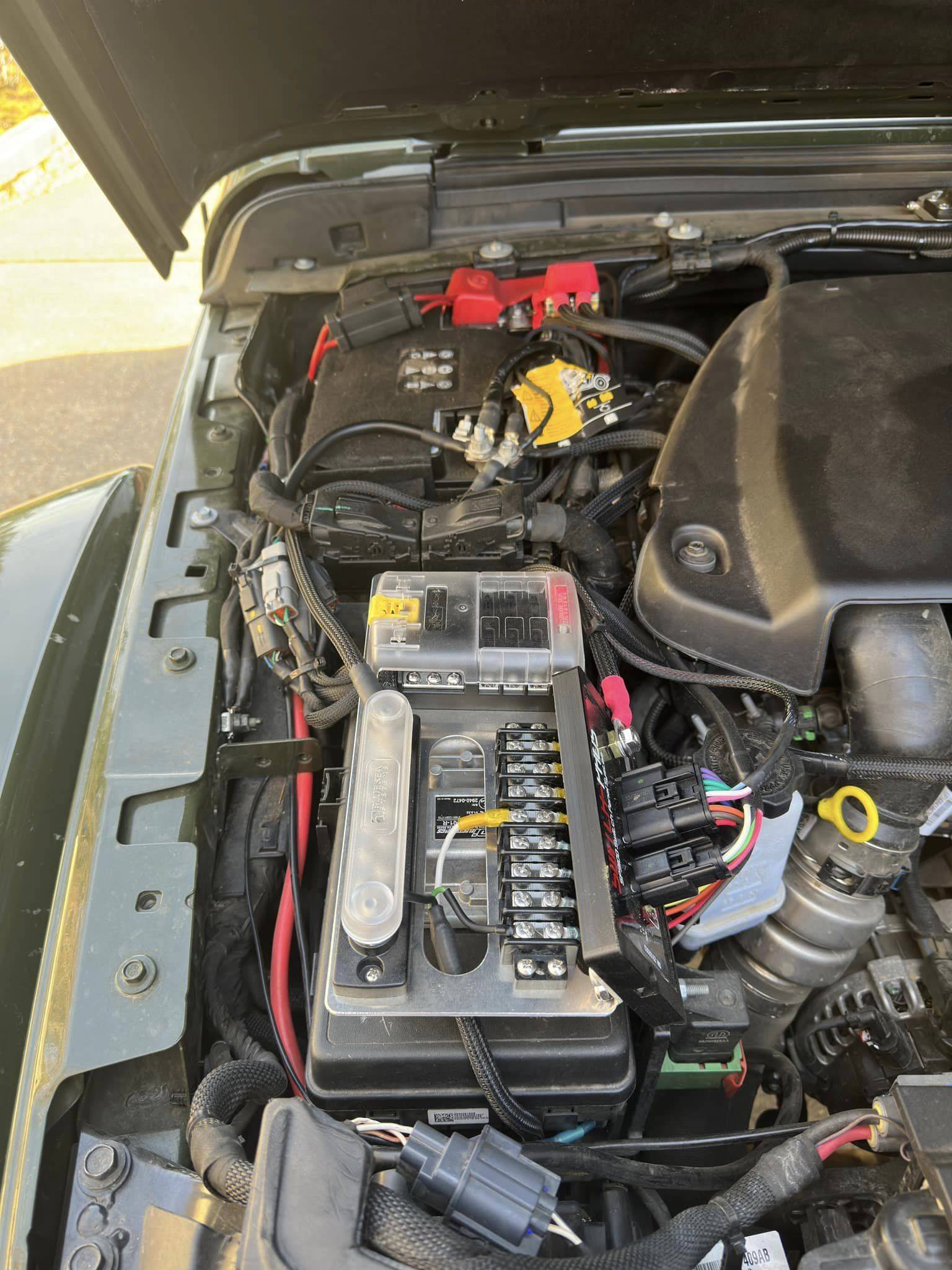

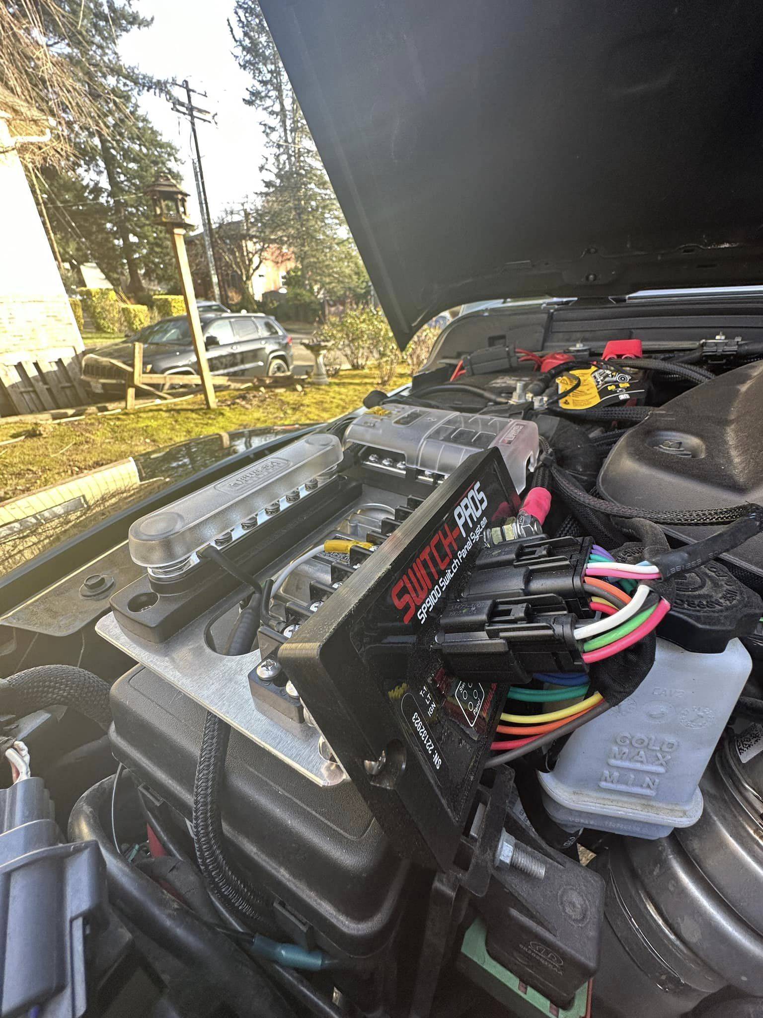

I don't think I have seen anyone else on here try this before, so I wanted to make sure to share it with y'all.
I know some Diesel members have been interested in a Powetrays style solution for the SwitchPro that would fit in our engine bays. I decided to try and make their universal mount fit over the fuse box, and it was a resounding success.
Powertrays was instrumental in me figuring this out, is considering modifying my install slightly to create a kit for JL/JT diesel owners since their gas motor tray doesn't fit ours.

Cool, so should we wait for a diesel version or use this?
Could you give more details on how this is attached?
I’d reach out to powertrays, no idea how long it’ll be before they do something. The universal kit works well enough.

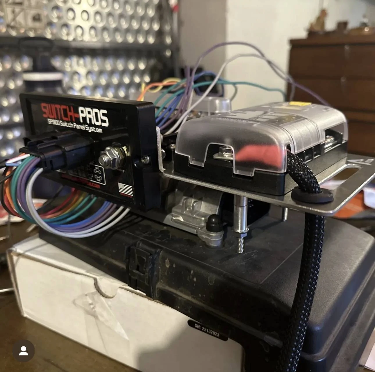

It’s attached using 1.5 inch risers bolted to the top of the fuse box lid, sealed with rubber washers. The normal kit comes with .75 inch risers, that’s all you need. I doubled my risers to clear my SDI EClick controller.

i got the risers from powertrays with the universal kit, I just asked for 8 instead of 4.
with the SDI underneath, there’s a couple other things you’ll have to do, and you will have some clearance issues most likely, but it does work.

here’s a side view when I was marking my drilling locations on the lid. I did end up trimming the bolts down and using a thinner nut, the clearances are pretty tight over some of the relays inside.
