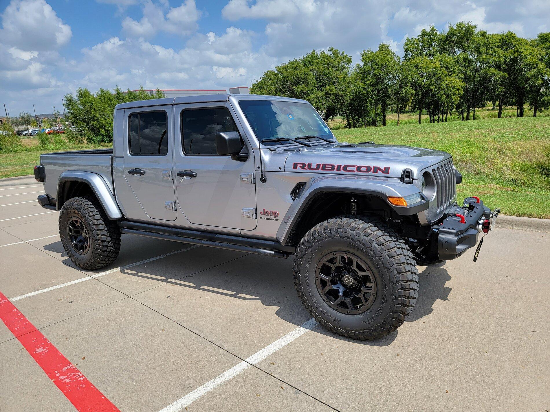

Mine on 37's with the 2-inch Mopar lift, and V6 w/auto trans. I don't do any extreme off roading that requires more flex than this kit provides, and it didn't break the bank. This is all you'll need for 37's on the Rubi. It's definitely slower "off the line" with the bigger tires, but I knew that going in. I've lost 8th gear for the most part, but I don't do a lot of interstate driving, so no big deal for me. But, I probably will re-gear at some point down the road. For now I'm just picking/choosing additional suspension parts to beef up what's already there (upgraded ball joints, etc.). I love the way it handles/rides with this lift/tire combo.
I installed the lift myself because I love wrenching on my own ride when I can, and I like breaking my knuckles and bleeding any chance I get. My undercarriage would look like a hazmat scene under a black light. But I saved some $$$, and I loved every minute of it.
Did you recalibrate your speedometer?

What's missing? I thought it's complete. No one else has mentioned it wasn't complete.
Just my thoughts, and many others dont agree. My thoughts are if I stayed w/33's the mopar would be complete/fine.... but with adding 37's I fell it needs a little more, even if just for piece of mind. Check this video out, explains things better than me.... lol But mainly, I'm talking about adding track bars and steering damper/stablelizer. Keep in mind, I have no real world experience with this, just trying to do my homework before mine delivers (so I got awhile).
