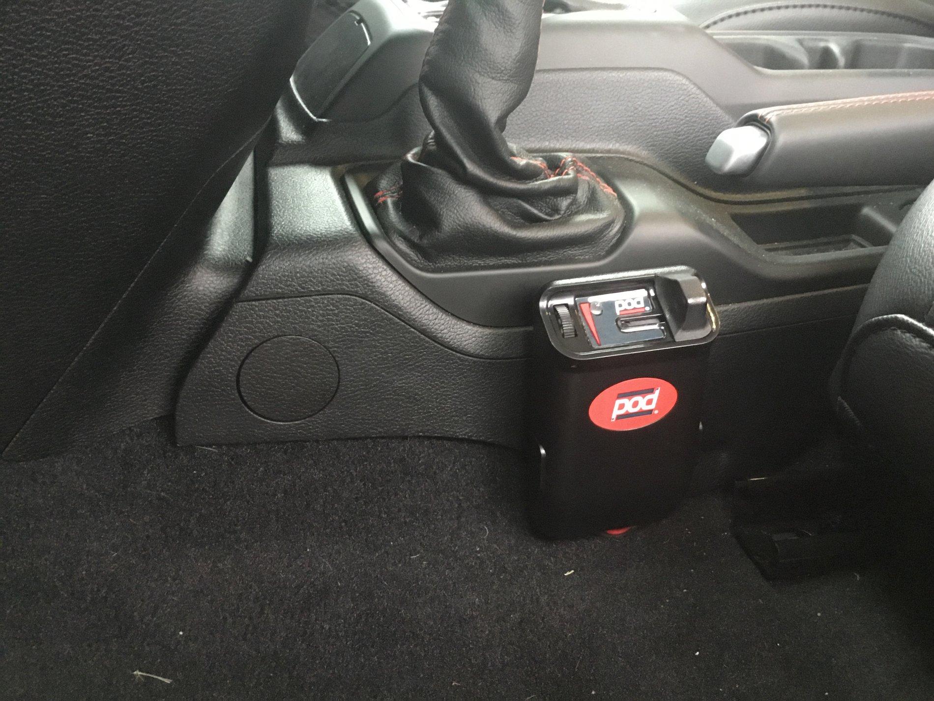

Harness works great.
Velcro attachment to the side of the center console for the brake controller.
No feedback... clean quick easy job. Have less the 10 minutes time for the installation.
Clean install, easy to reach too. Question though. I thought brake controllers had to be installed facing in the direction that the vehicle is travelling, or at least close too it. I have a Tekonsha P3 prodigy controller on my Gladiator, and the install instructions stated this as well. I think there is some sort of gravity controlled mercury type switch inside that can detect when the vehicle is slowing down that also triggers the brakes to activate. Food for thought. Maybe thats just the Tekonsha controllers? I have mine mounted on the knee panel under the steering wheel, just left of center. I can still see it while driving, and is within easy reach in case I want to use the manual brake lever, or make adjustments. The prodigy controller stays on for about 15 minutes, then turns off automatically, but I remove mine between uses and just unplug it from the Tekonsha harness, and tuck the harness up under the dash.

Modern controllers use accelerometers, not mercury switches. The Tekonsha POD series can be mounted in literally any direction (that's what he has). Others can be mounted off-axis as far as up/down, but still need to face forward. Read the docs for your own controller before installing it.
