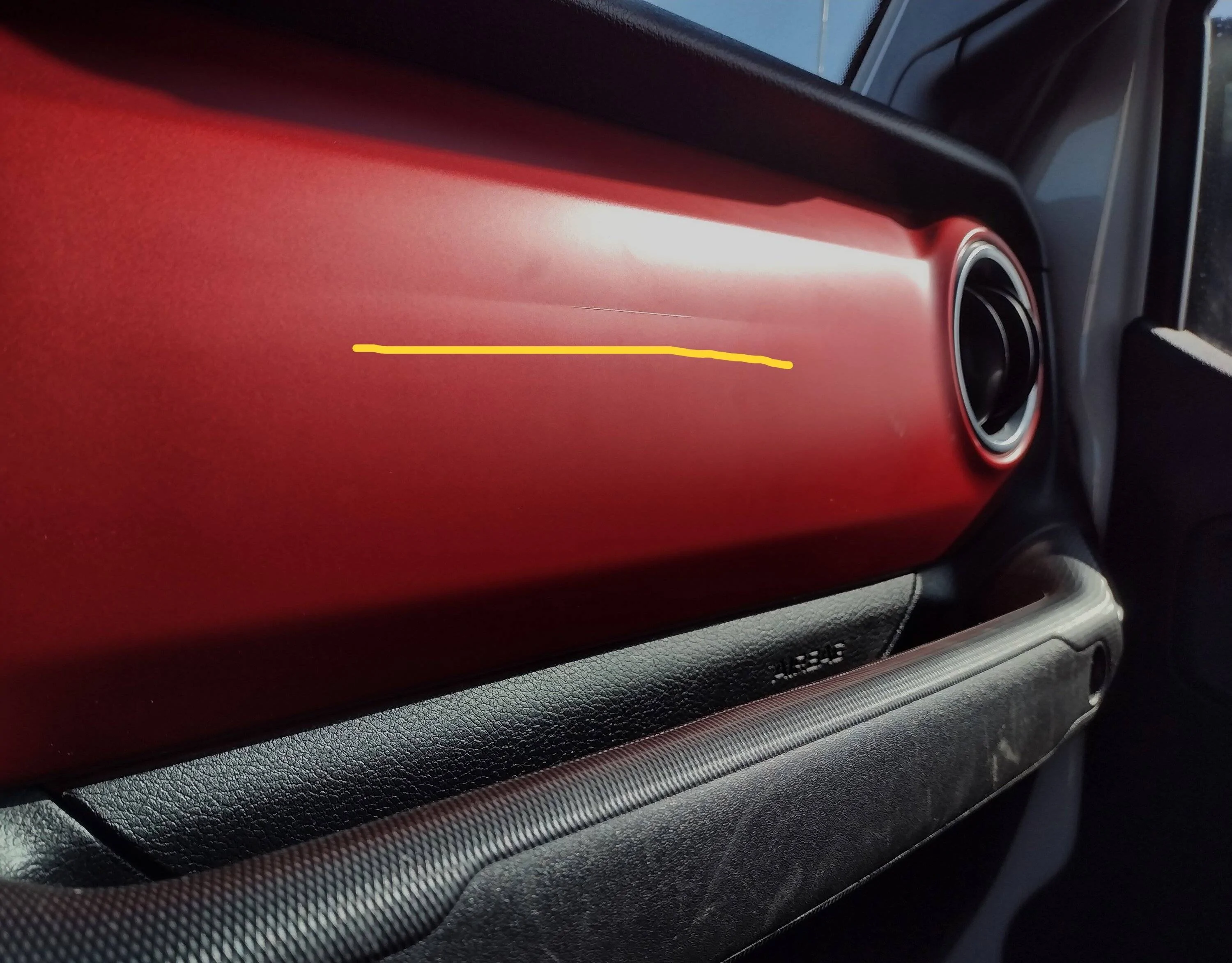

5. Passenger side dash, above the, "Oh Shoot!?" bar (which showed the most wear and tear in the interior), there is a crease or dent in the panel there. Believe that is the airbag location. Look at the pic I attached, right above the yellow line I drew. Is that a 'defect' with that panel or airbag? Something happening on Gladiators there? Or likely just something was sitting on the passenger seat and fell forward and smacked it.

The air bag is below the red dash panel, and behind the grab handle. I don't think it coems out of the red dash. That mark is an Uh Oh from a previous owner.

5: looks like something hit it, pretty hard. It’s bent on the split location for the airbag. Would be worth asking to see if they will replace it it as it it will most likely be weak there now and get worse over time.
The bag splits the red portion in have at the seam shown in the picture.
Defect/damage.
