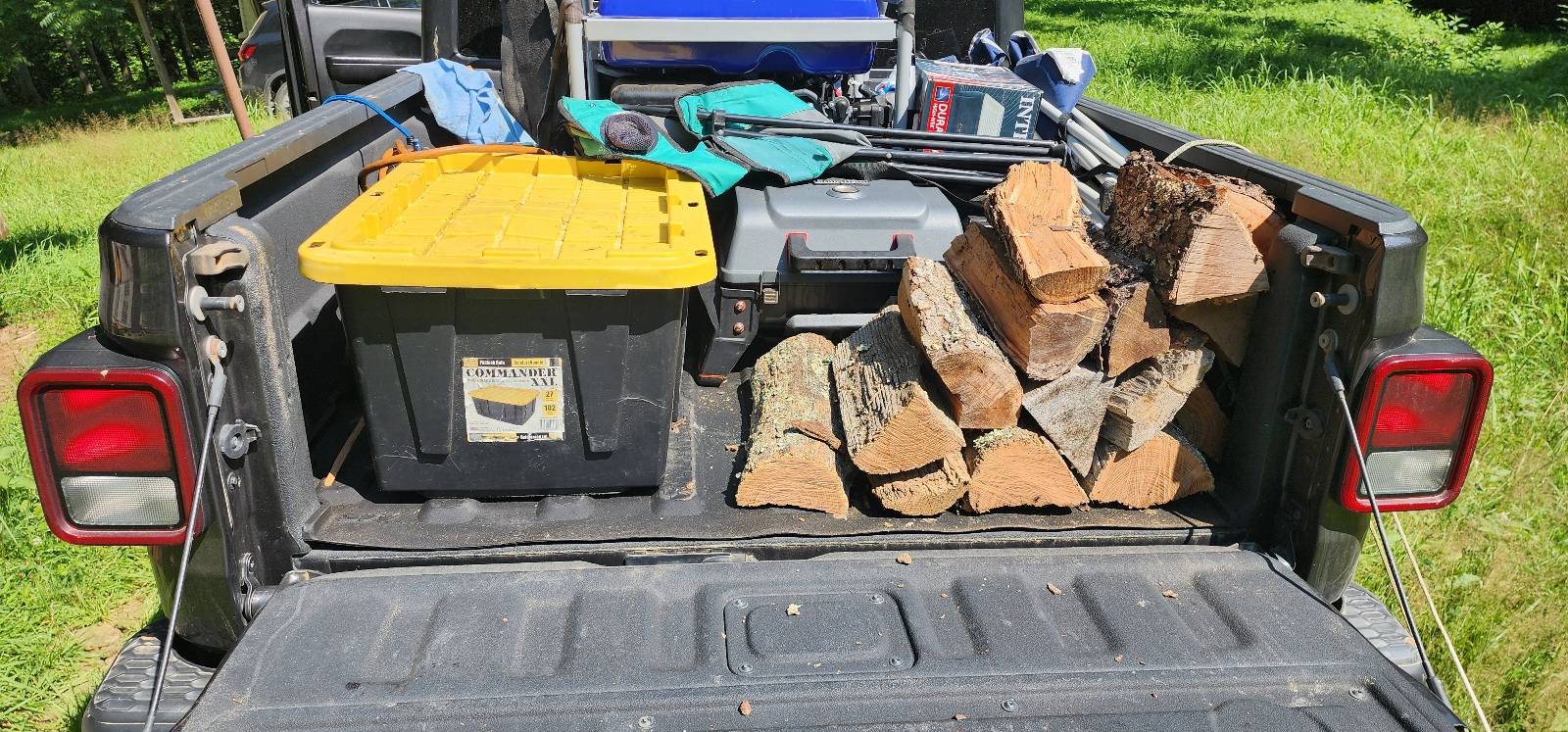

But I digress to each their own. I tow some with mine but most of the time its a payload . I dont exact weight I had in it the other day but I didn't notice to much of a problem at all. It did squat a couple inches. I already threw a bunch of my fire wood out before snapping this pic.
