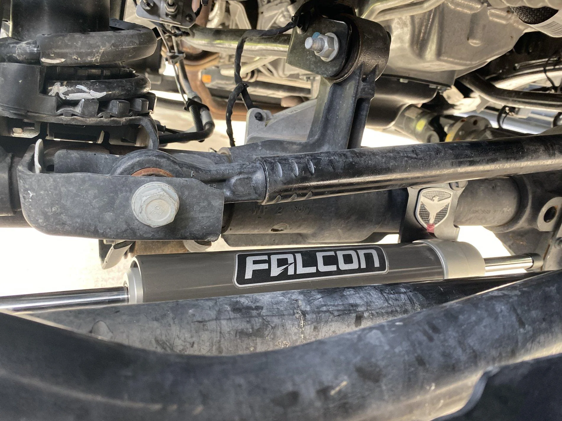

Anyone have any experience with the Rough Country N3 of Skyjacker M95 dual steering stabilizers. Will either do the Job satisfactory compared to the pricey Fox 2.0 dual stabilizer. Please post you reviews and opinions
IMO... don’t do it... it’s a horrible gimmick. I bought the RC dual for my 99 WJ. The steering wheel never centered after it and I had to fight the steering wheel all the time. I went back to a single stabilizer and it was smooth as butter again.
My .02 on the single pass through stabilizers... love them. I’ve had the fox ats and the falcon 2.2 on 2 different jeep JK’s. They were awesome but I never ever adjusted them after I got them set in the middle position on or off road.

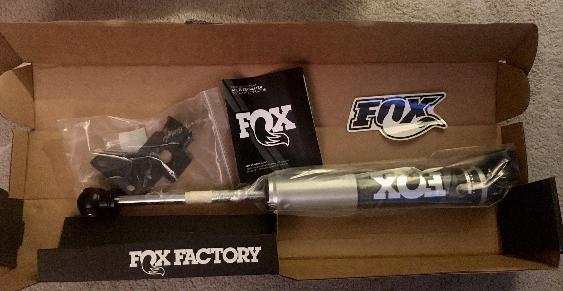

The Ice Cream Man in the Brown Truck stopped in front of my house. Got a new flavor:
Can’t wait for my Destroyer!
Jeep Gladiator Those complaining about the steering... get the Fox Steering Stabilizer 814294EA-10E1-4365-AF3D-98500182B1B4
40,498
54,011
Now that's funny. (had to post to compensate for my envy, I guess)
