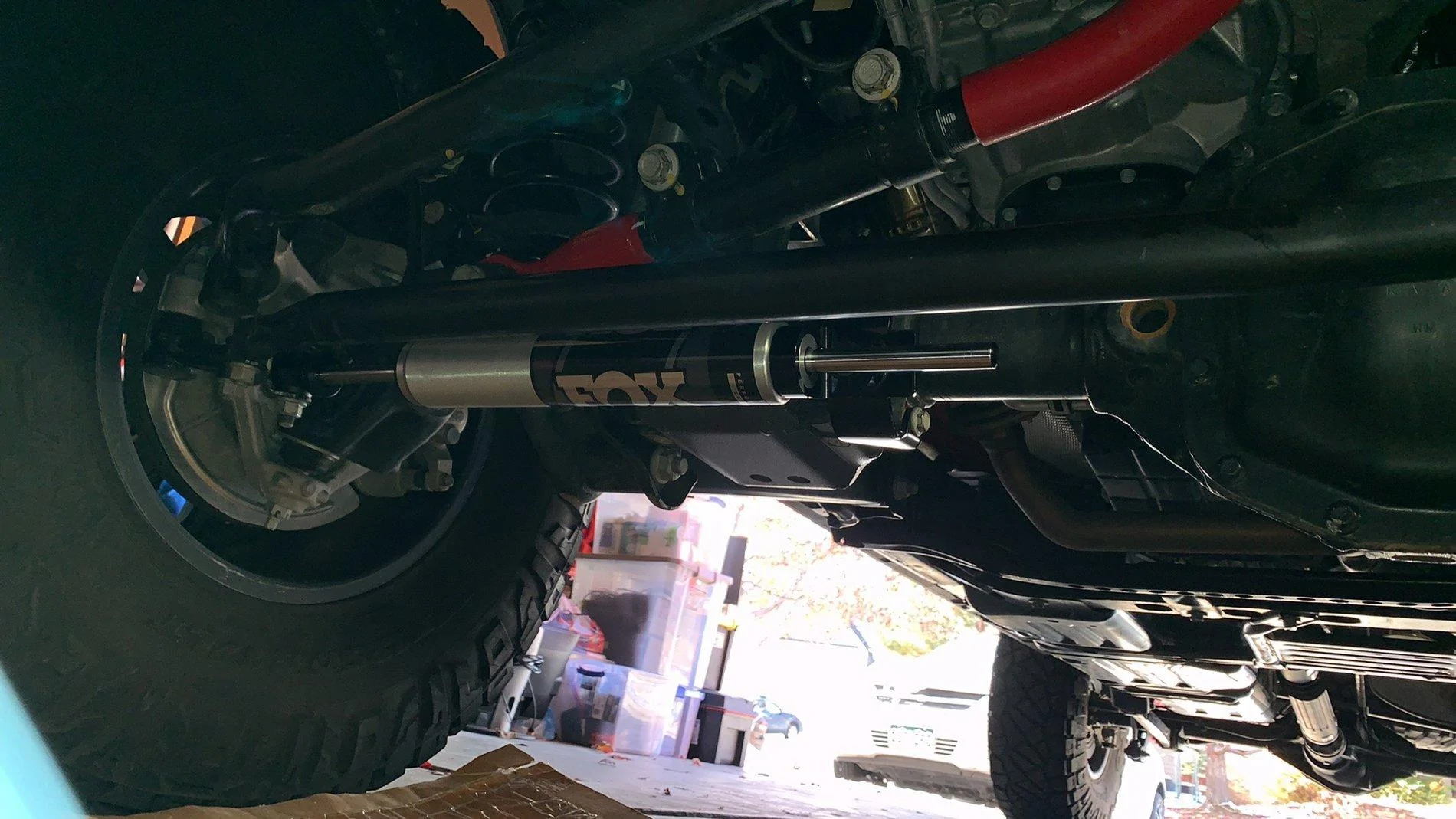

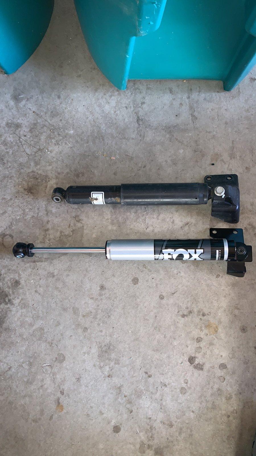

Just threw my fox TS stabilizer on today... took about half an hour. I did have to jack up the frame a little bit on the drivers side to get one of the bolts out due to the trackbar in the way. Definitely fun to do.
It made some interesting differences while driving. The steering wheel feels lighter/smoother in hand but over bumps cracks a lot of shake went away.(I am on 37’s). Also less input is needed to go straight and I’m not as worried to let go of the steering wheel.
Overall... I like it and now all my shock/dampeners match so there is that too lmao.
