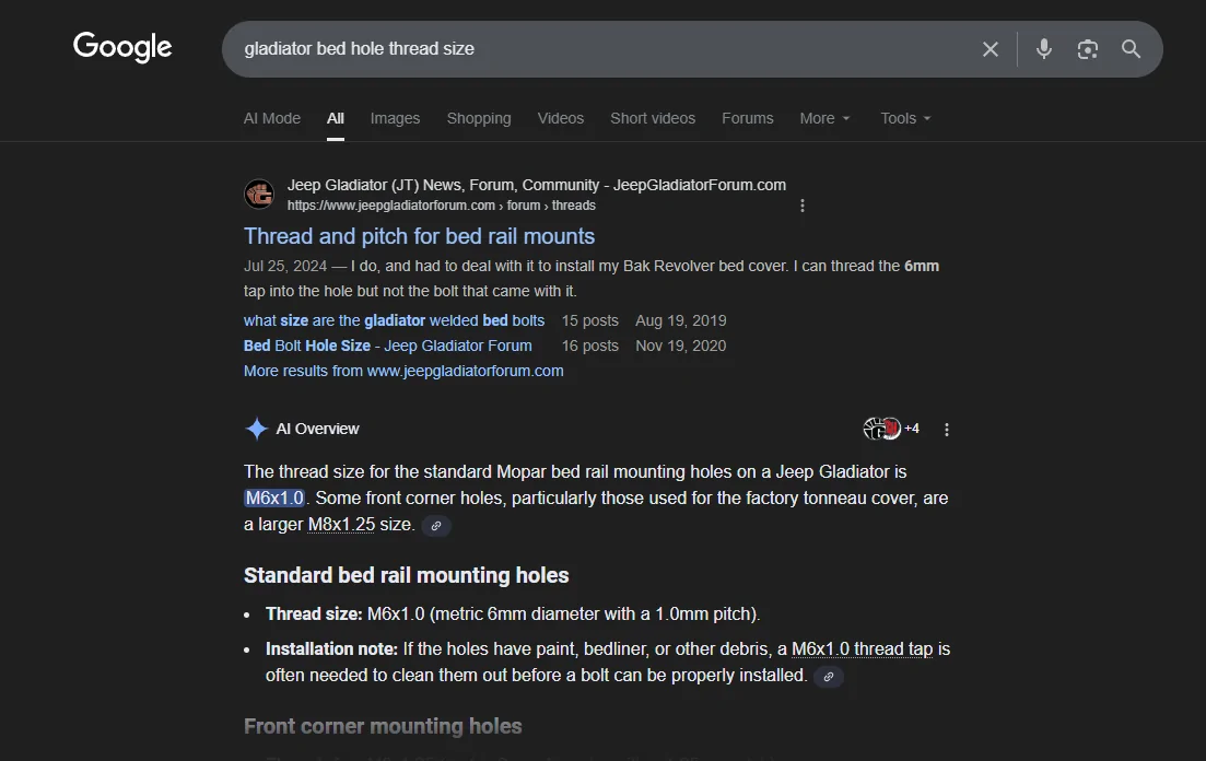

Google is amazing.

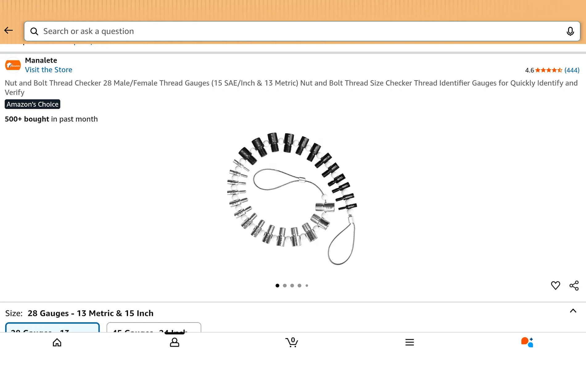

https://a.co/d/ariRF2o
Google's AI is pretty good though on a lot of stuff.

Thank you, I tried that and got conflicting answers so thank you Muppet for the answer.

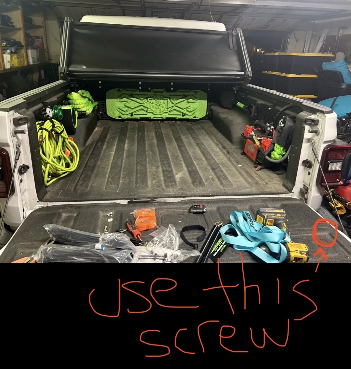

You don’t have to do any of that stuff. Just remove one of the screws from the tailgate and chase all your holes with that, then reinstall the screw and you’re set. I did all of my holes this way when installing my bed molle

Factory bed liner 👍🏻
Had no problem pulling out the first screw I tried, so there was no reason to try any others.
