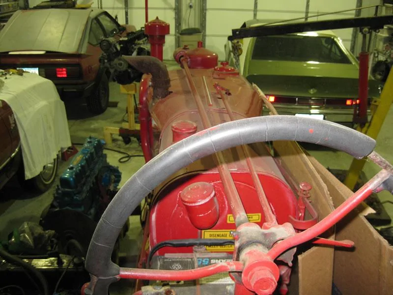

If that engine was warmed up, it likely did "ok" on kerosene. I've sold several things that were made to run on kerosene. The issue is that they don't START well on it. Normally there was a small tank for gasoline and a valve you turned after the engine was warmed up to switch from the gas tank to the kerosene tank for running. My McCormick-Deering 1.5 hp M engine had a small dual-chamber mixer (instead of a carb) and you put a few ounces of gas in the "carb", started it, let it get a bit warm and then turn the valve in the mixer/carb and it would then run on the kerosene in the tank.
I sold this tractor a few years back (I have regretted it, dang I wish I had it back) - the part of the tank closest to you holds a couple gallons of gas while the main tank is kerosene.
And the blue engine on the floor to the left of the tractor - a NOS 258 JEEP ENGINE, never in a vehicle, it had never been bolted to a transmission or had engine mounts on it. The exhaust manifold had a paper tag on it.
