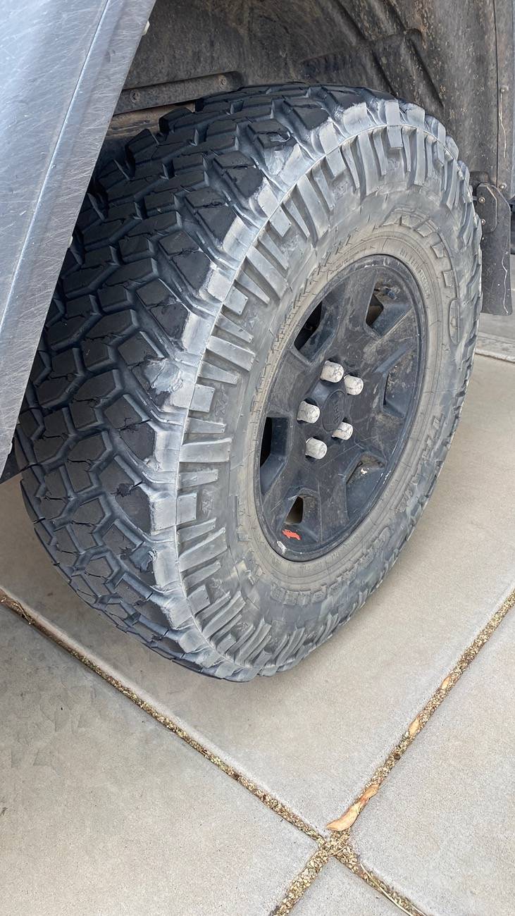

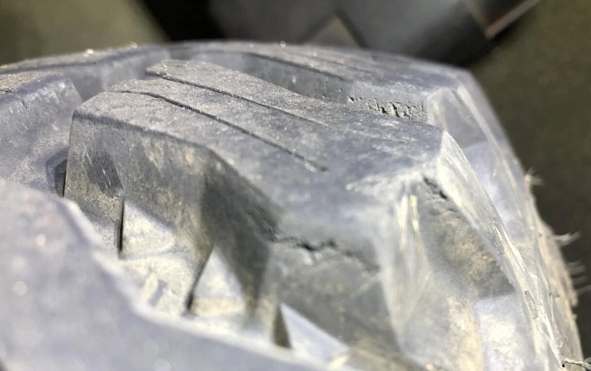

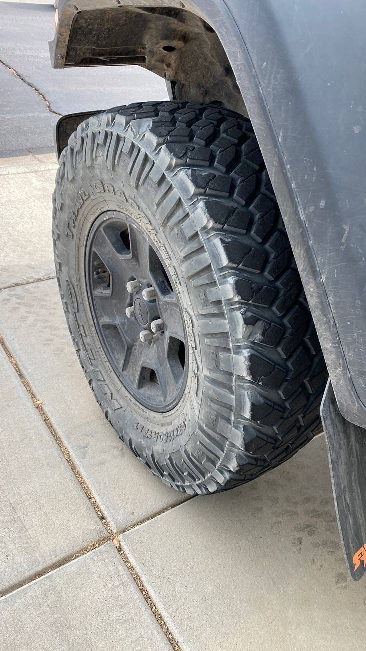

After my last off road adventure, I noticed I have some tire chunking going on. I have a couple of areas on each tire as shown in the attached photos. I have never experienced this having really never off roaded on rocky trails till my last trip out. Is this just a cosmetic thing and tires still safe? I do have an upcoming appointment with @Discount Tire , I did purchase the road hazzard certificates. Any advice?

Thanks Bleda, Hot Springs and Kansas Rocks definitely much different than the trails here in Florida.

That’s pretty much the norm with rock crawling. I’ve never had issues with tires looking anything like that.

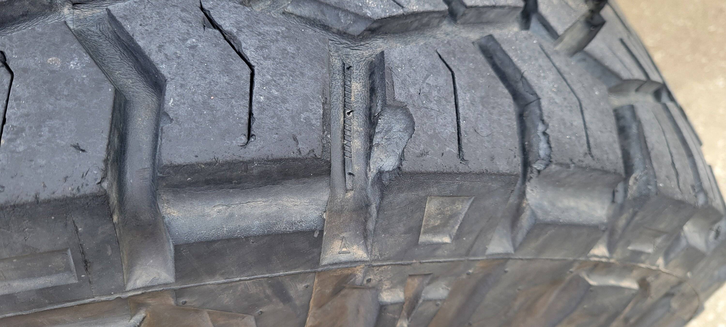

I agree that varying amounts of tire chunking is fairly common when wheeling in rocky areas. Some tires seem to be more susceptible to larger chunks coming off, likely due to the rubber compound used or the age of the tires. For example, my old KM2s lost chunks like what is shown in your pictures, but my current Baja Boss ATs just get leading edge 'pitting", like so:

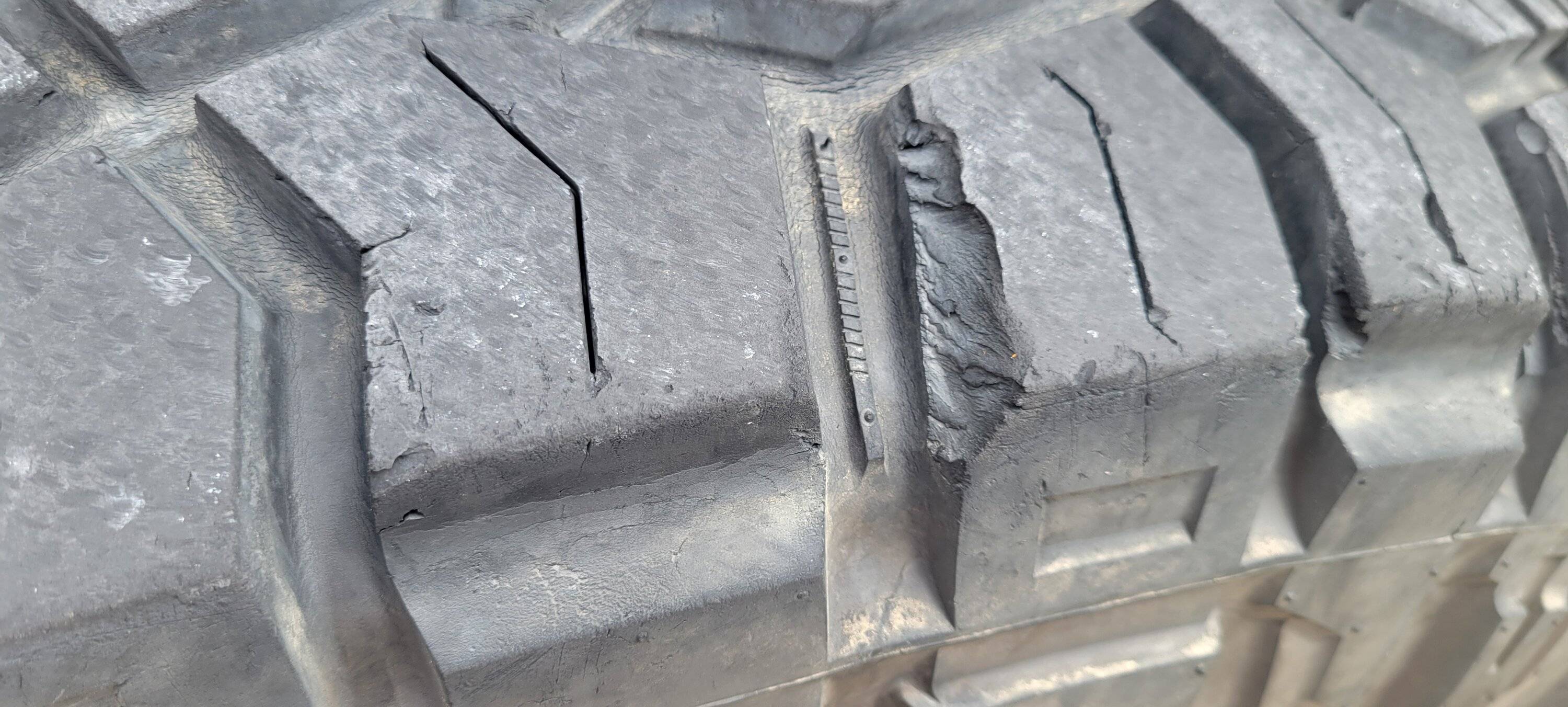

Your tires seem to have a decent amount of rubber cracking around the base of the tread blocks. How old are they?

I was about to ask mileage on tires, the cracking in tread makes me think they have pretty good mileage on them and maybe getting old and”brittle”? My factory Falkens look better then that tread and I just spent both days last weekend in the rocks trying to tear them up, but nothing no chunks….Jack
[/QUOTE]
2 Years old with 20
K on them.

Chunking happens - some tires are more prone to it due to the rubber compound, but any tire will chunk if you abuse it on harsh terrain. Generally chunking does not make a tire unsafe unless you are ripping entire lugs off.
I agree with the above post that pointed out the cracking/dry rot, which is an indication of an old tire. Tire rubber gets hard as it ages, oxidizes, and is damaged by UV; that means they don't grip well and can even come apart.

The tires looks ok. Chunking the tread blocks is normal off roading in the rocks. Depending on the age of the tires. The cracking between the blocks could be from flexing of the tread blocks.

I agree with others that the chunking shown is a cosmetic issue only, and to be expected when used on rocks. The weather cracking appears minor to me as well, and in my experience it's common to see on tires that see use off pavement, especially in mud or when used aired down.
