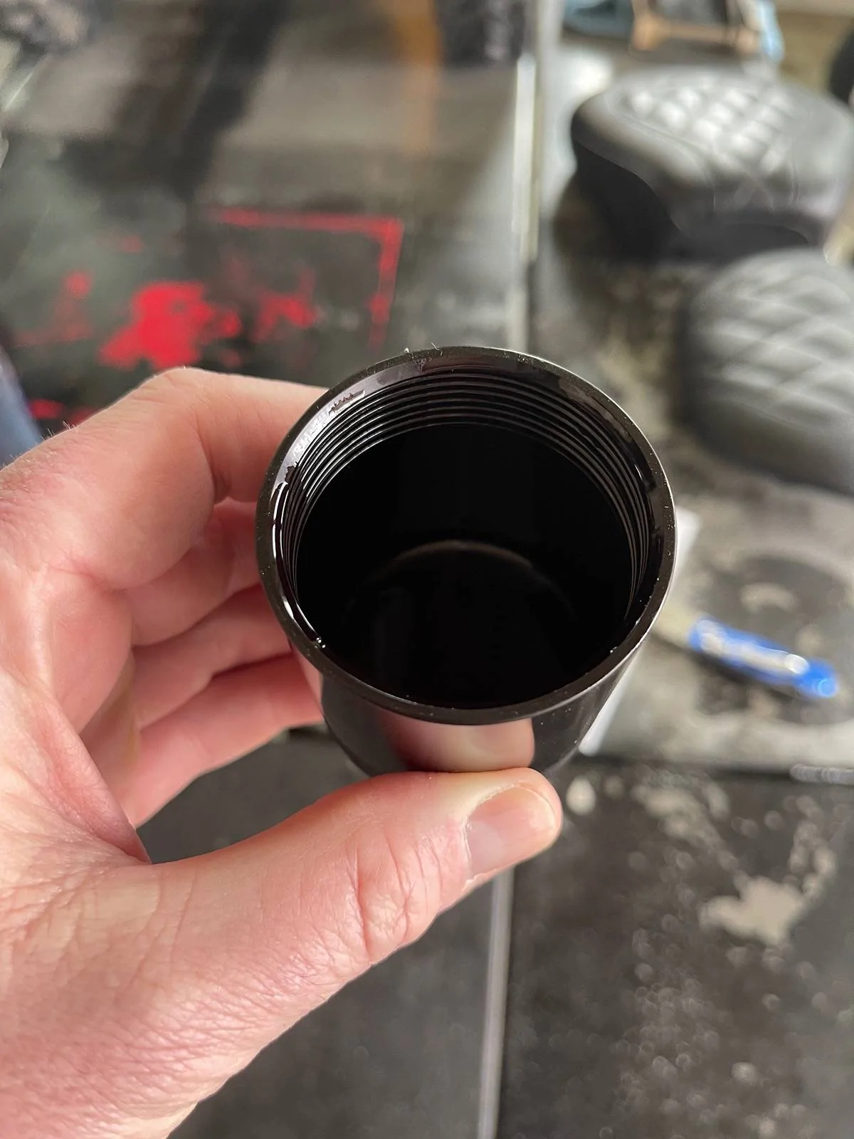

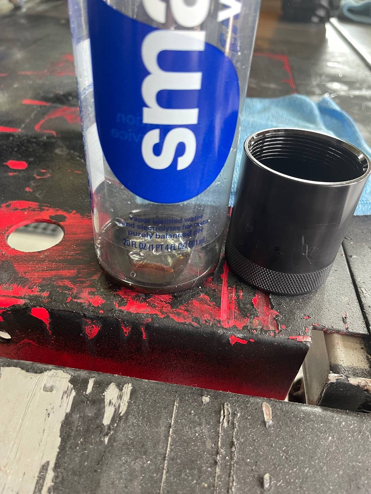

Just checked my J&L Oil Separator at 5-600 miles since install and this is what came out. Not a lot for sure (maybe an 1/8th of the small can) but it is doing what it says. I plan to re-check every couple months, noting mileage at empties.

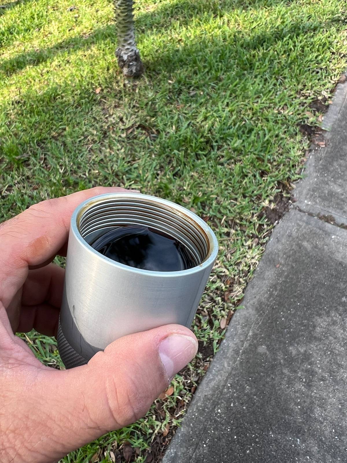

I just installed one last month and it caught all this in three weeks.
like shadow said above, that’s not purely oil.
It’s an emulsion of oil and water.
If that’s purely oil you have a bigger problem that needs repairs.
