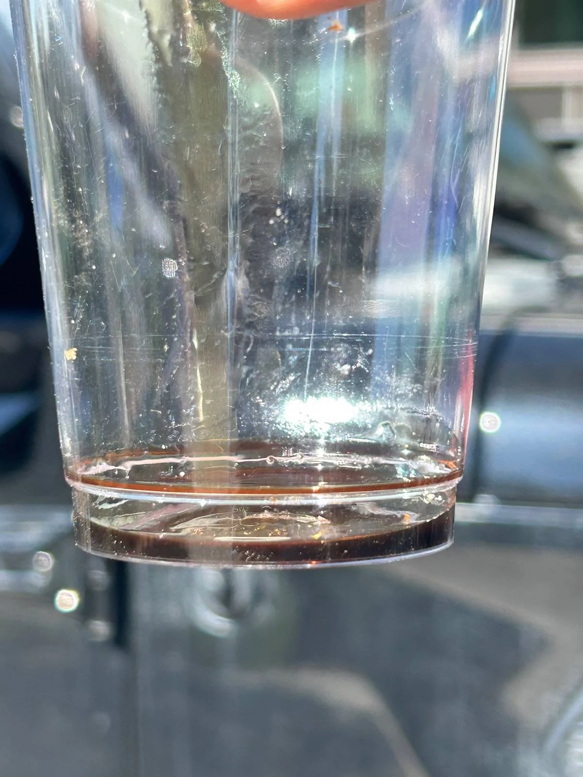

I installed the Mishimoto can on my 3.6L 2020 JTR about 3 weeks ago. Very easy install and the drain hose and stopcock make it very easy to empty. I’ve driven about 500 miles in that time. This morning I emptied about 1/2 ounce. Maybe this is all for naught and maybe too little too late (as my engine has about 55,000 miles on it), but I figured it can’t hurt.

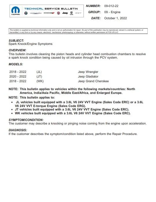

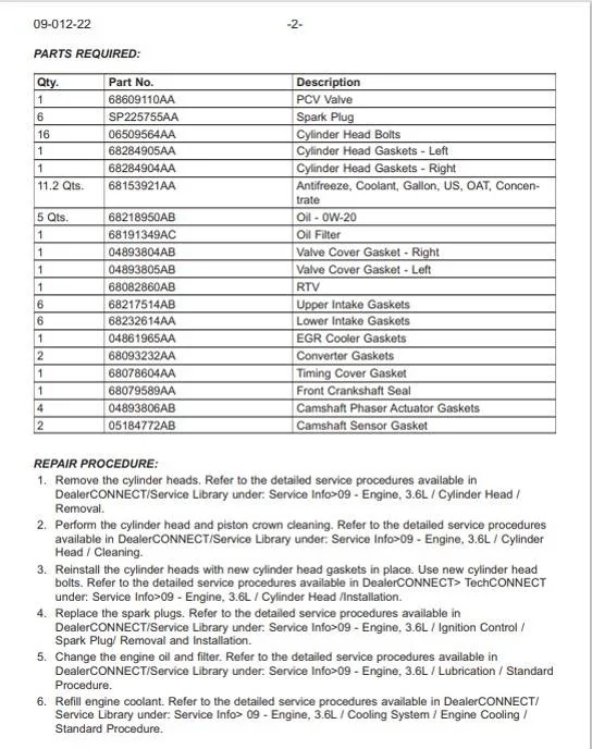

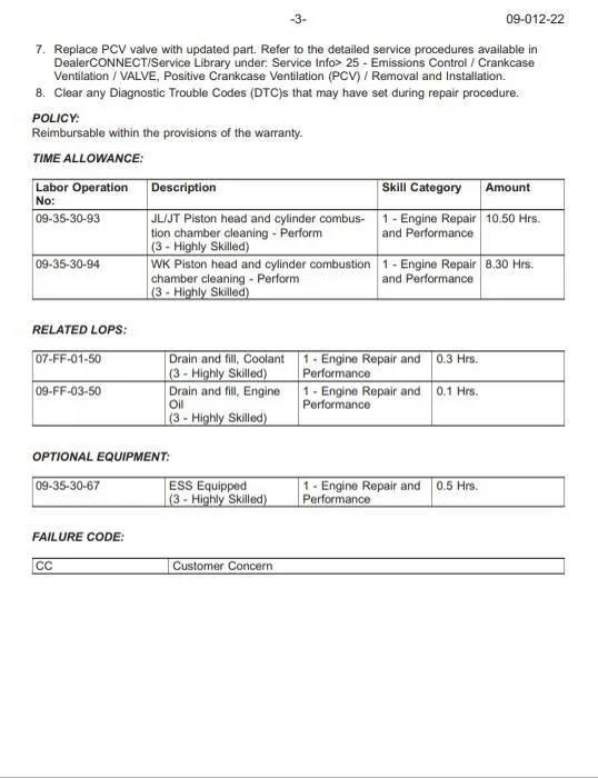

Curious since the only replies are those that have spent money on a catch can and the ones trying to justify installing one. Has anyone have say over 60000 miles on their gladiator without a catch can and if so are you seeing and negative effects such as crusted intake that has to have been cleaned or similar
Yes, I started getting EGR errors around 60K miles, and I replaced the EGR and the EGR sensor. The sensor especially had some carbon crud on it. My PCV line did have oil in it. I was not burning oil, about 1/4 of a quart every 3.5K or 4K miles. I did install the Mishimoto catch can, and i really like it. Especially, how easy it is to drain the can with the built in drain hose. I get a 1 or 2 ounces of oil every 1500 miles or so. There is a TSB out on our PCV valve for carbon build up. There is an updated part number for a new PCV. You might want to try that. For some reason this new PCV is $120 vs. the old PCV being $30.... lol... Note: I am assuming the new PCV will have a tighter spring which in turn will create a little more crank pressure before releasing pressure to the hose... I decided to stick with the old PCV and go with the catch can, since, I do not want to suddently get oil leaks from my gaskets, ie. due to more crank case pressure... ... I am attaching the TSB with the Part numbers, so, you can read it.
