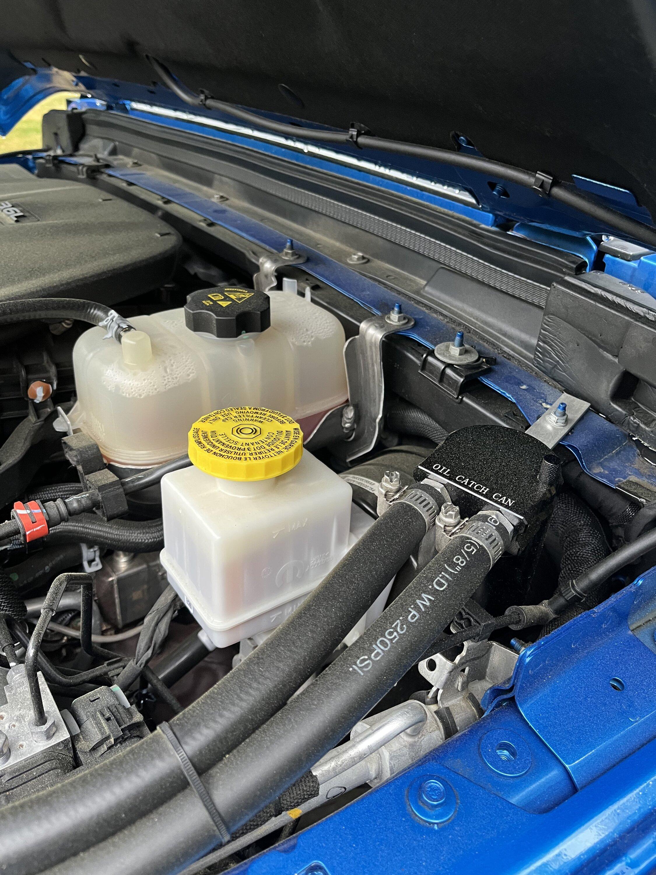

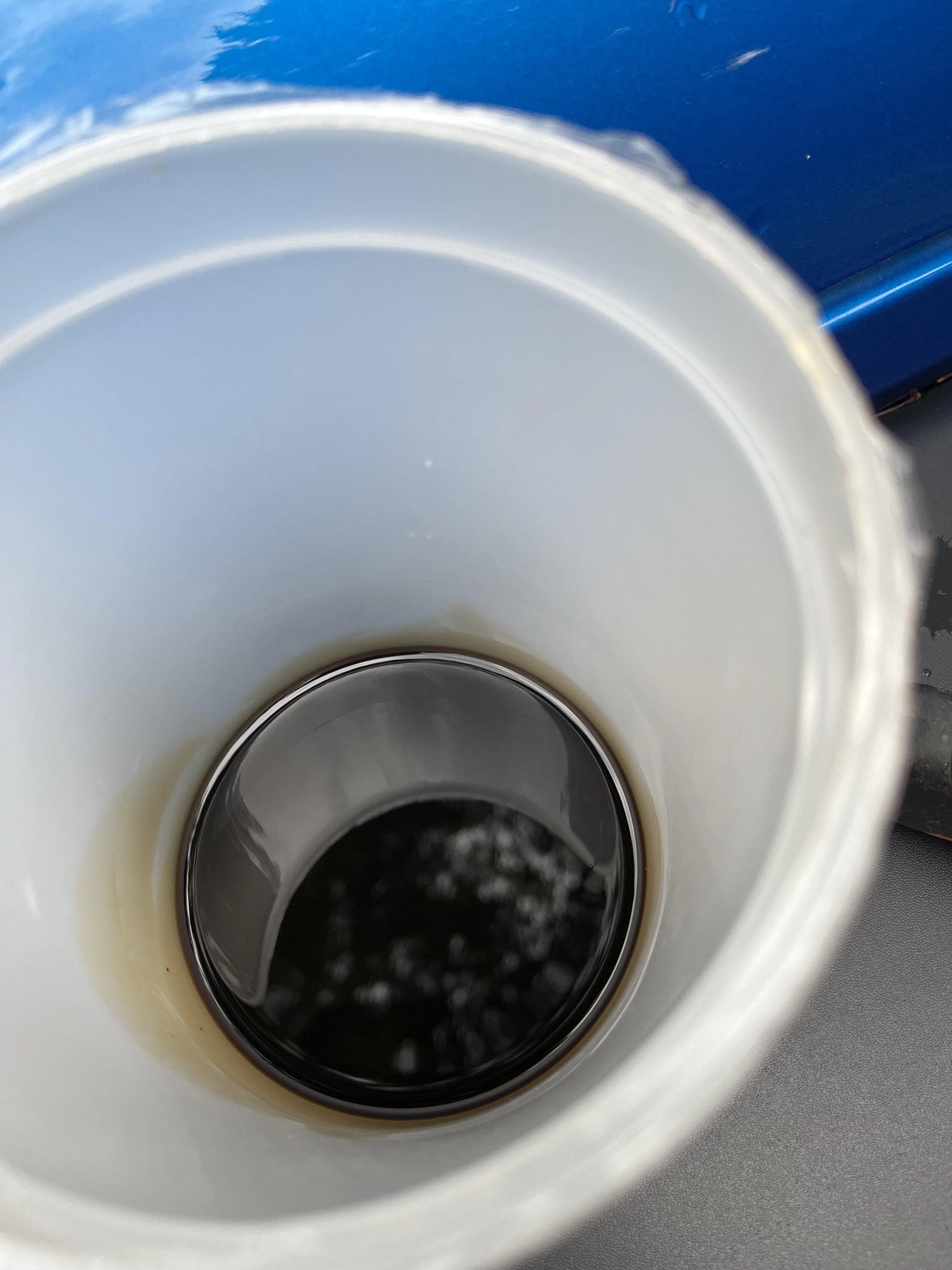

Just emptied mine, was about half full after 1700 miles, pretty dark oil.
Jeep Gladiator Oil catch can - feedback? D80FFA8A-7518-47DB-B4BA-ABCF972B0E51
Jeep Gladiator Oil catch can - feedback? 0BBF7F69-4E40-420E-9715-244A46EC27F7

Take care about generics. Catch cans in bad positions have a tendency to "overproduce" results.
Throw a thin catch can in an area where it's likely to create condensation and you're going to be emptying it very often, except what you empty will look a whole lot more like chocolate milk than engine oil.
Contrary to popular belief, oil and water can mix with enough agitation and can suspend to a point where they no longer separate. That's what the "chocolate milk" in a catch can is. Don't get duped into thinking you're saving your engine from 8 ounces of potential sludge every 2500 miles when most of that sludge is water being pulled out of air that was never in your engine to begin with.
From my limited research, mishimoto is both a very thick can, and located in a proper location to reduce condensation. What comes out of a mishimoto during spring-fall should look exactly like used motor oil, and there shouldn't be much of it. You'll still get some chocolate milk in the wintertime.
Yeah, that's what I posted several months ago.
If it looks like it came from Starbucks, it ain't oil. It's an emulsion and mostly water.
If it's working properly, it will look exactly like you just took it out of the drain pan - the exact same color and consistency of oil in the crankcase.
Tan = water.
