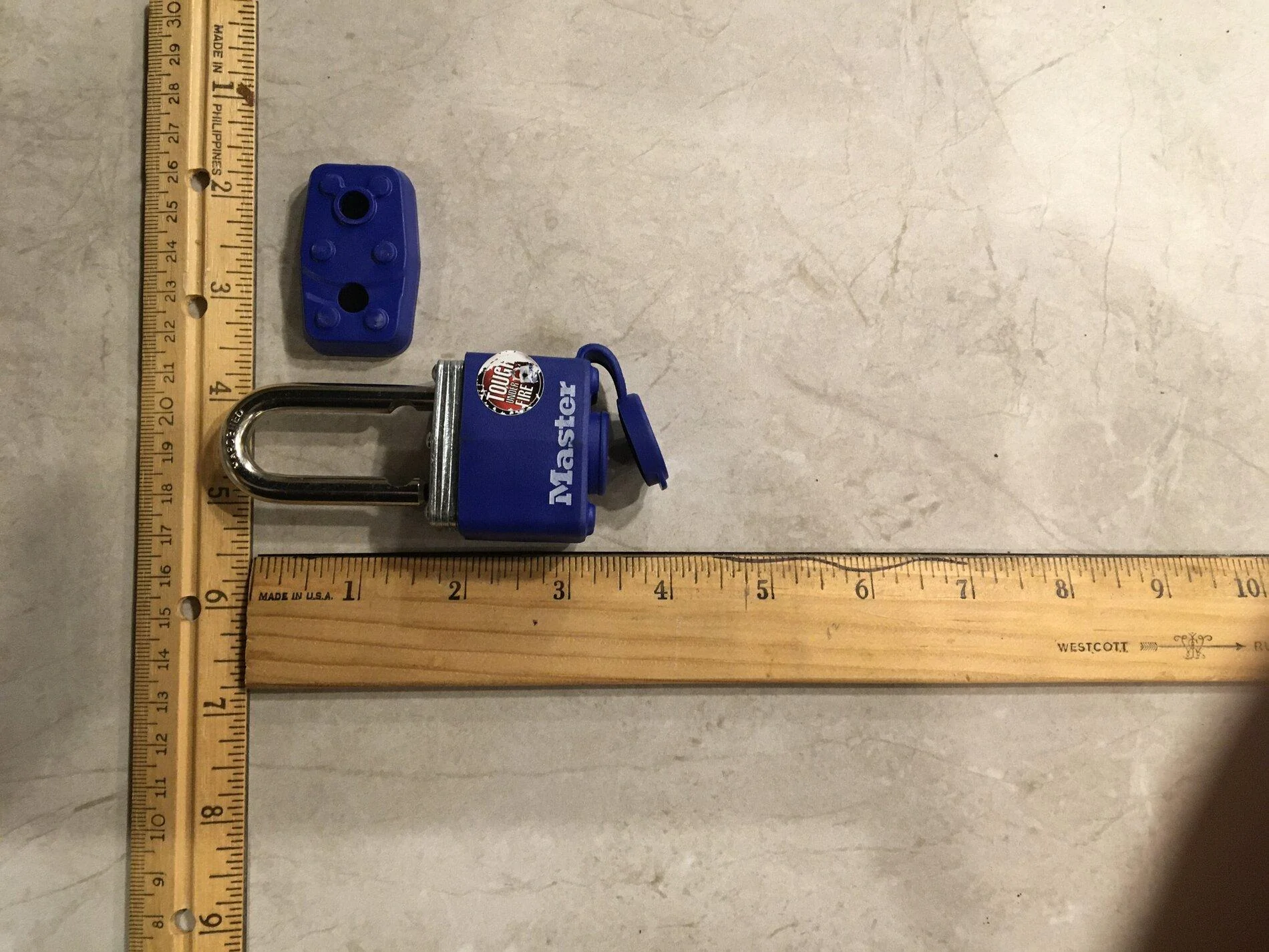

Do you have any suggestions for padlocking these things? I’m struggling to find one that fits well. I see you have a padlock on yours, does it work well?
i picked up a three(3) lock Master Lock set at Home Depot, keyed alike. they worked quite good, but work much better getting thru the hasp and around the cable that secures the box to the bed D rings, after I removed the upper plastic piece.
Jeep Gladiator Tool box? 5BC2681D-F5D7-48F0-BCC2-826848DB1651

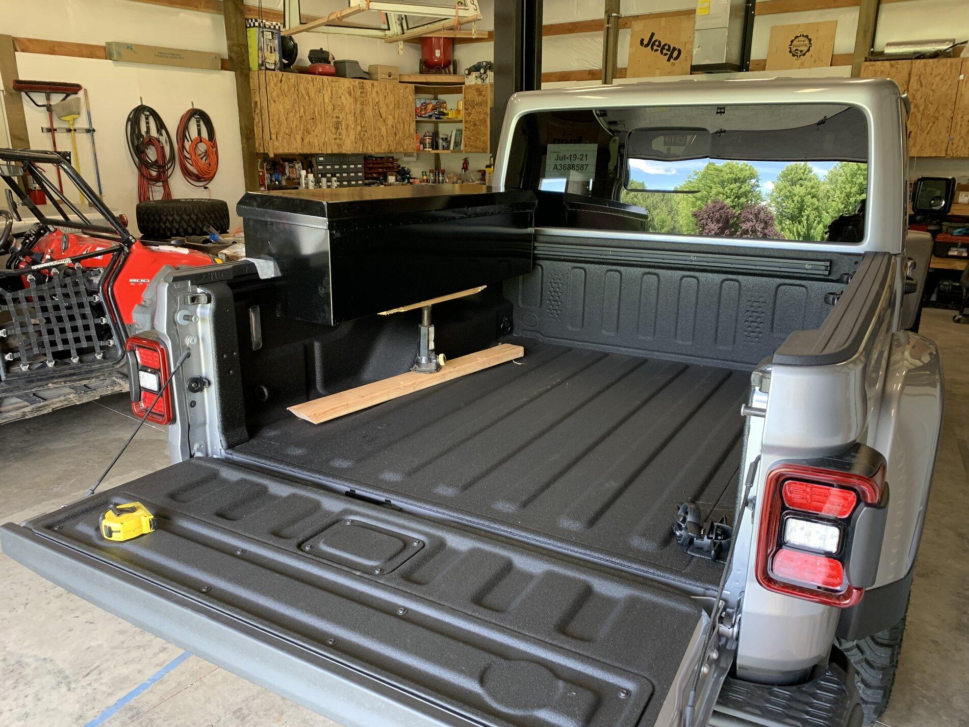

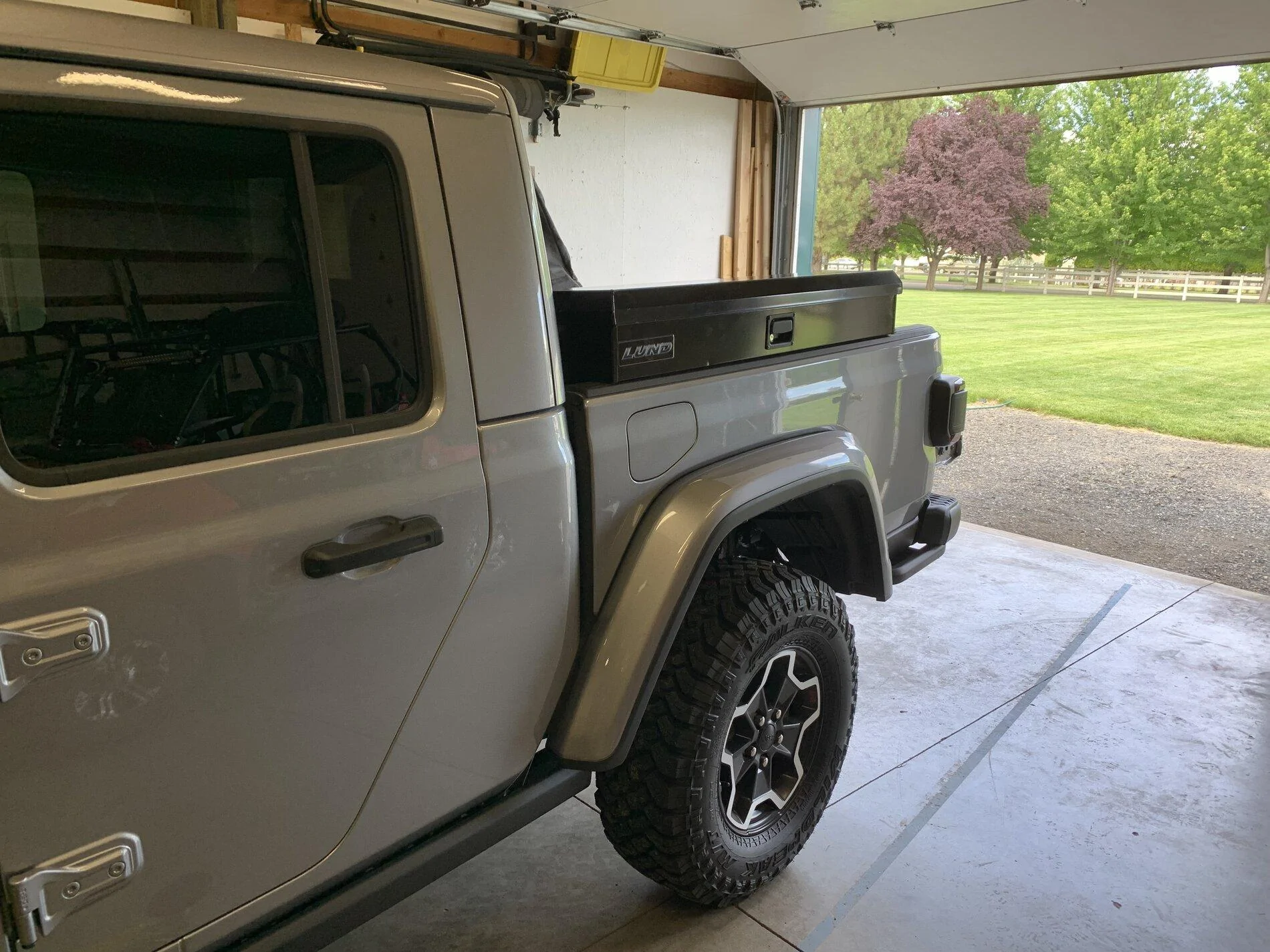

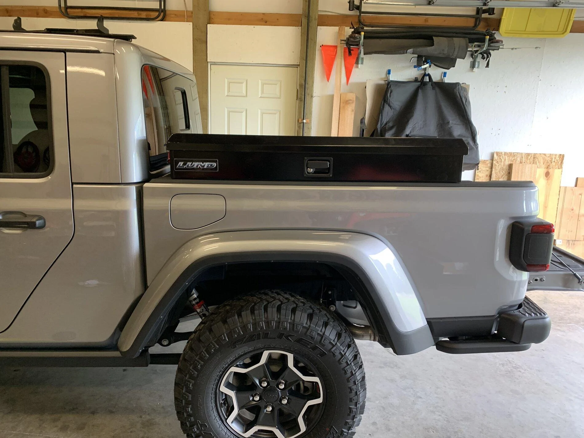

Jeep Gladiator Tool box? IMG_1898
Jeep Gladiator Tool box? IMG_1899
Lund 48" side box. Forgot to snap a pic after I built the stanchion, this was just during mockup with a jack to hold it in place... Used (2) t-slot nuts to secure it to the Trail Rail and then a center stanchion to anchor it to the bed floor. Super handy because I can access everything I need from the side rather than having to reach across or over anything.

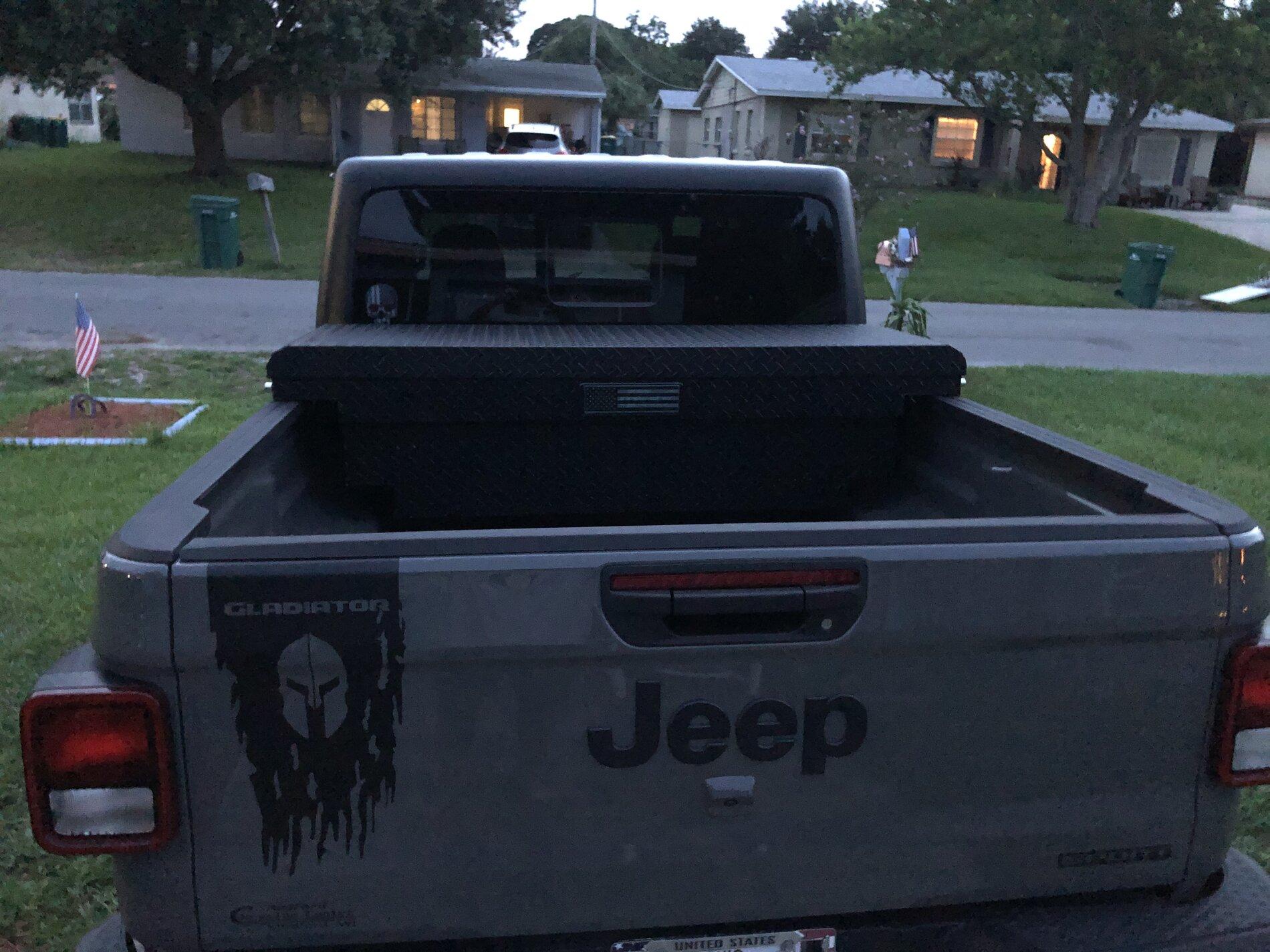

I got the craftsman and painted with herculiner. I love how it fits/looks.
How much room do you have from the inner tailgate panel to the front of that box?

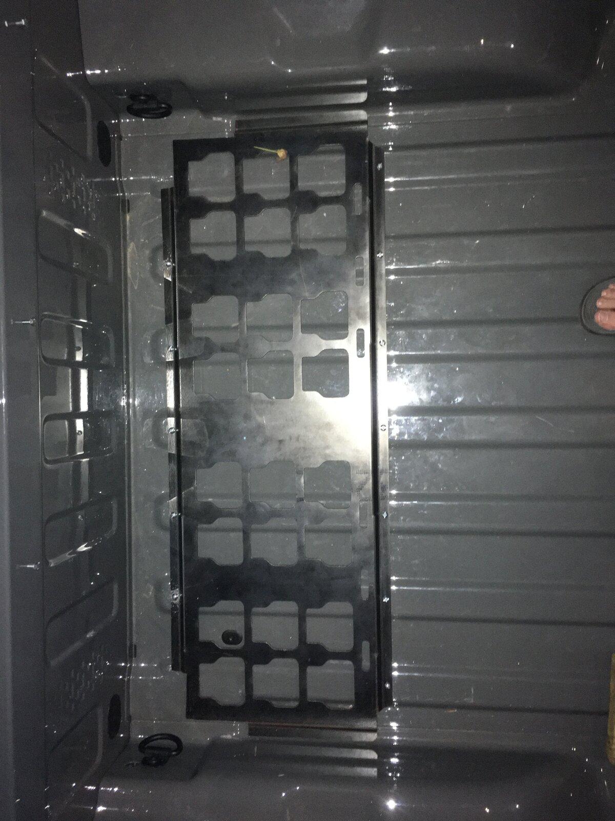

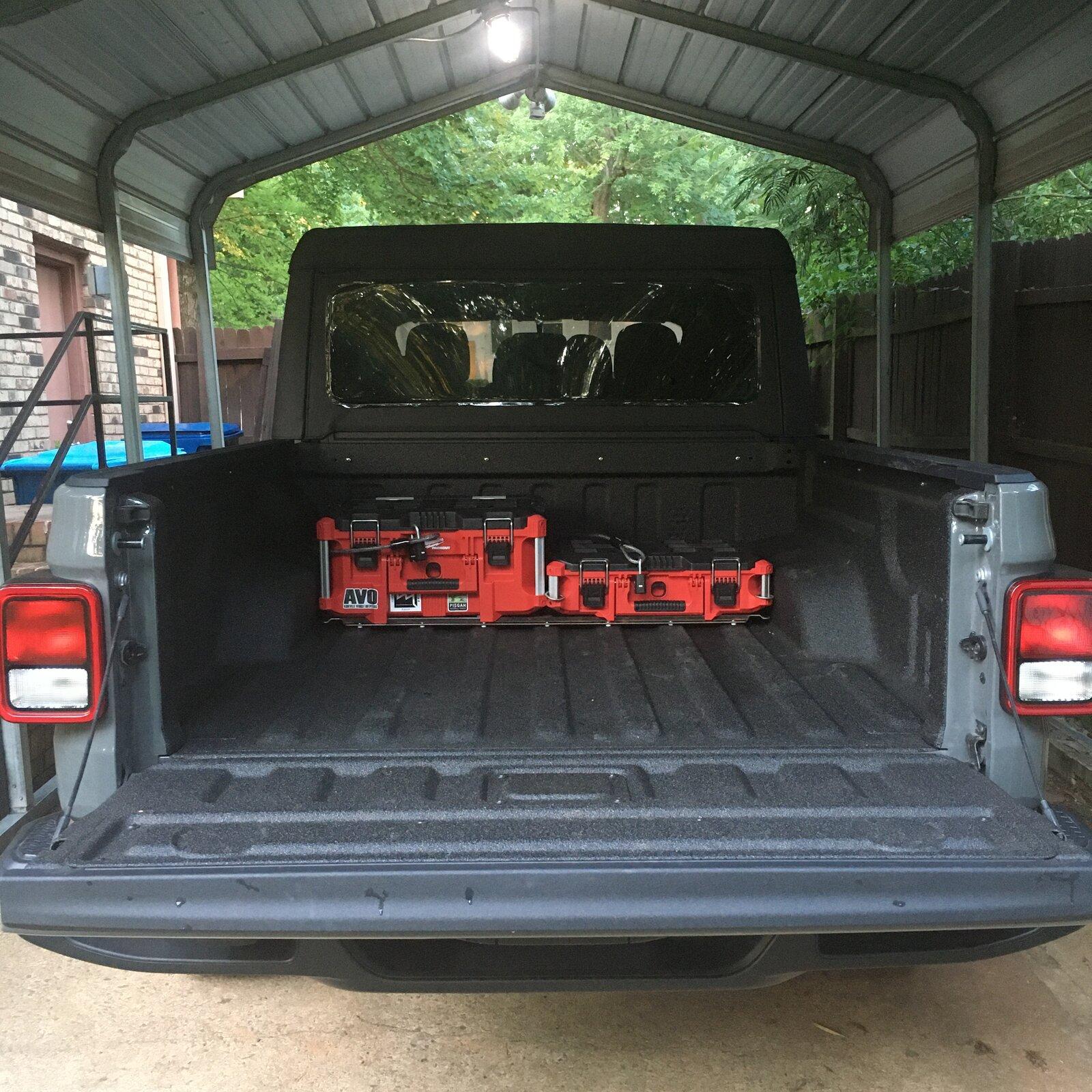

Custom Milwaukee Packout plate. Will hold 2 full size Packouts, totally modular, removable, and expandable. I still need to sand and powder coat.

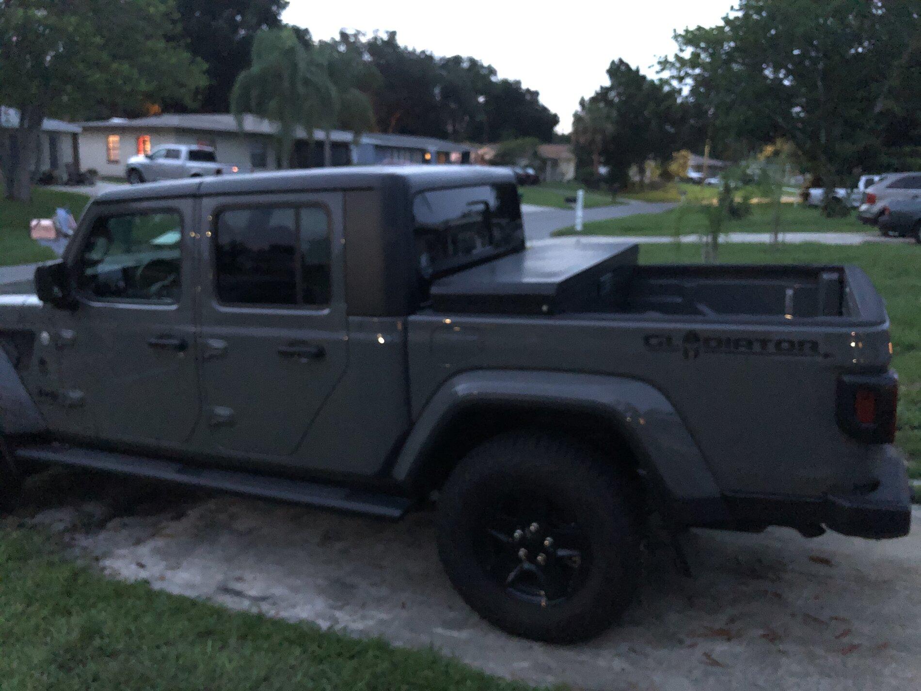

Husky from TSC. Pulled it off my Tacoma when I traded it for my Gladiator. Fit like a glove!

This is awesome. I have these in the same place, but am strapping them in instead of mounting them to the plate. How did you make this? Any chance you would make and sell me one?

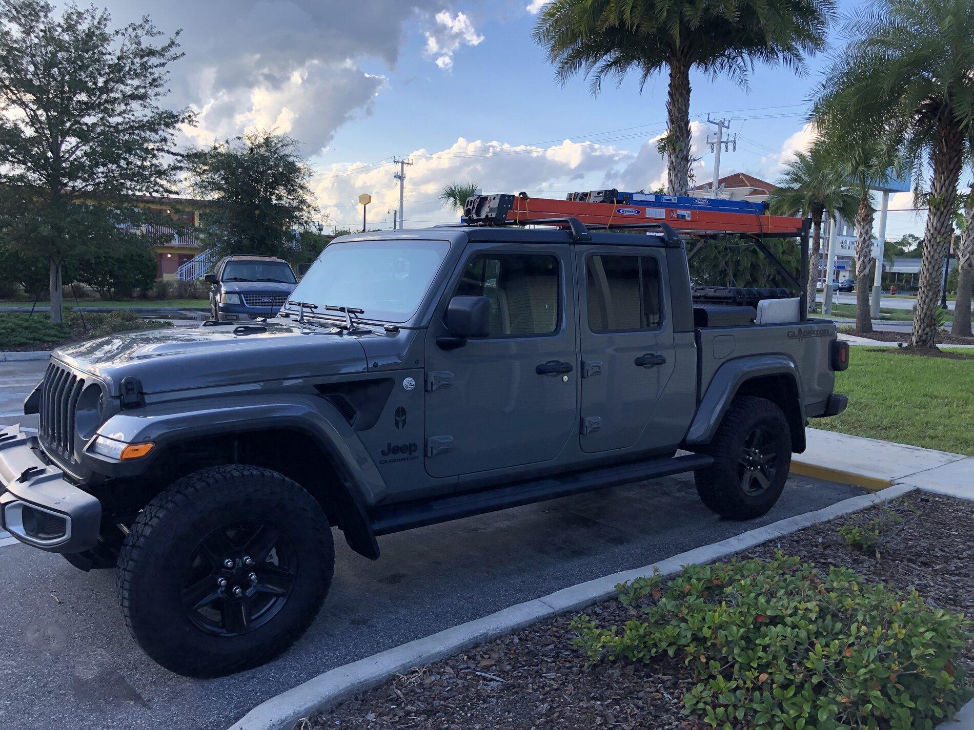

Added some mobile boxes, a rack and air lift 1,000 to stop the pogoing on the highway.

I had it made by a CNC shop in NY. I sent him measurements of the bed. The Packouts just touch when installed.
One modification I would make when if you have him build you one: have the base raised 1/4”. There is a small bump up in the back corner of the bed that I didn’t notice. I added 1/4” plastic PEX under the plate to get it tall enough.
Here is a link to his Instagram account: rdr_cnc

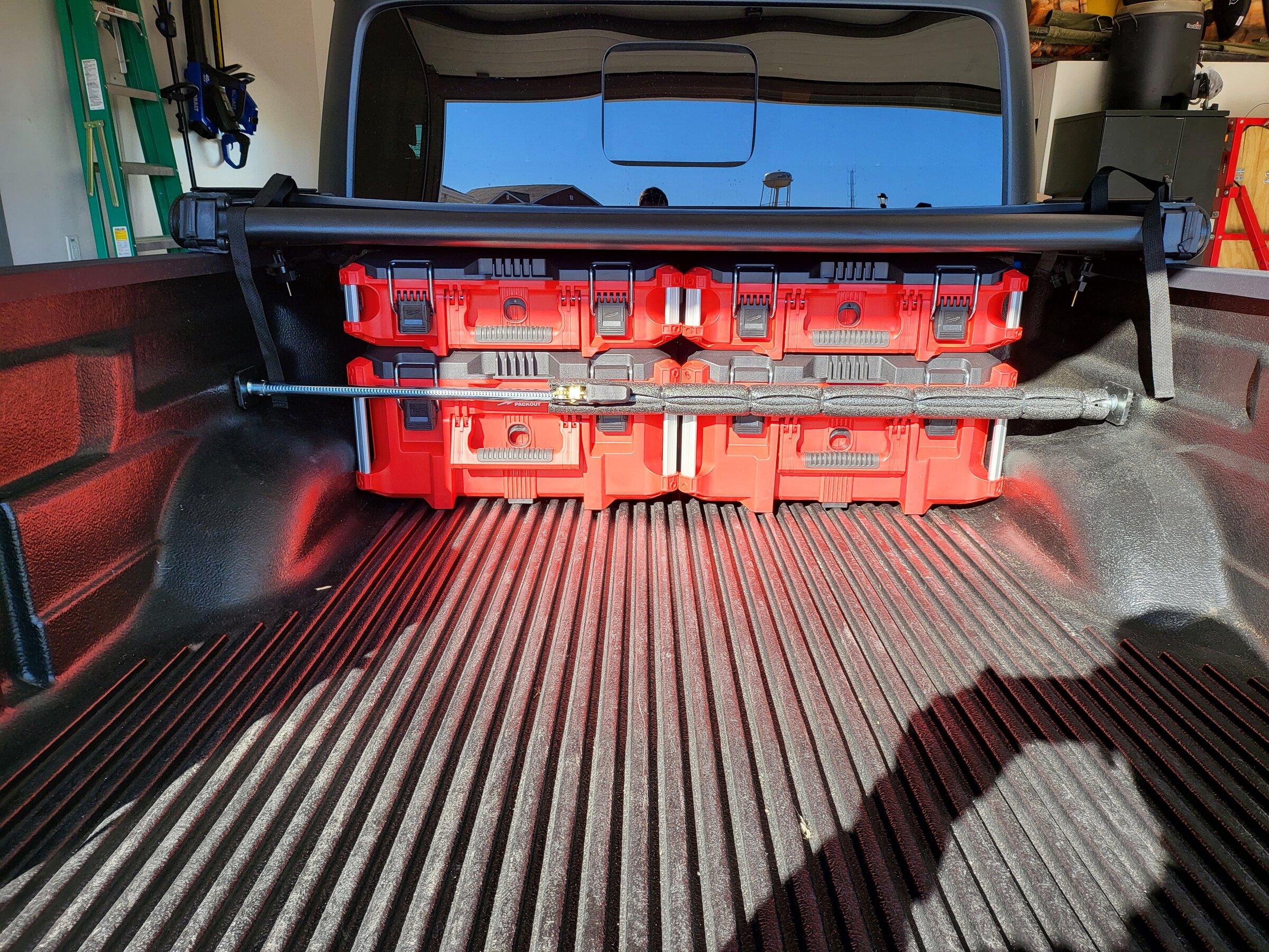

Milwaukee Packouts secured with a cargo bar wrapped in pipe insulator for protection. Works great and fits like a glove with a drop in truck bed liner and trifold tonneau cover.
Jeep Gladiator Tool box? 20211211_124651
