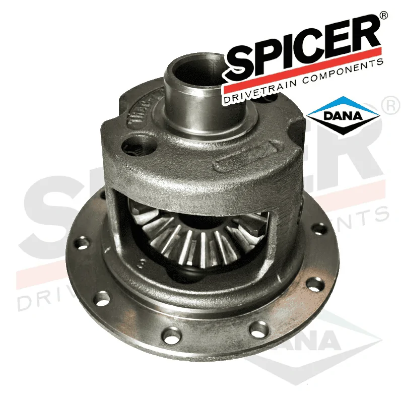

nuke
Jeep Gladiator Torsen/TrueTrac helical limited slip differential? 1637635538730
Trac Lock Dana-Spicer

mrmo
Mrmo
Jan 26, 2021
56
863
545
East Tn
2022 Gladiator
nuke
For real? Ive used Spicer driveline parts in hi-performance applications for years w no issues. I prefer the Auburn limited slip myself. Got one in a 9" w 4.30 gear set, 600hp w slicks, inspections once a year, no indicated wear, and i do not baby this vehicle.
Is a newer Dana 44 just like the ones from the late 70's? I built up the front 44 in my 79 Bronco, w 38's and a big block. Never one issue and i run it hard too.
Wheelin98TJ
Ryan
Jul 27, 2021
3,732
4,395
Devils Lake, MI
2021 Jeep Gladiator
Bean Counter
Dana Trac Lok is a hard pass for me too.
It's not a good performing limited slip. And having clutches means it will need a rebuild.
