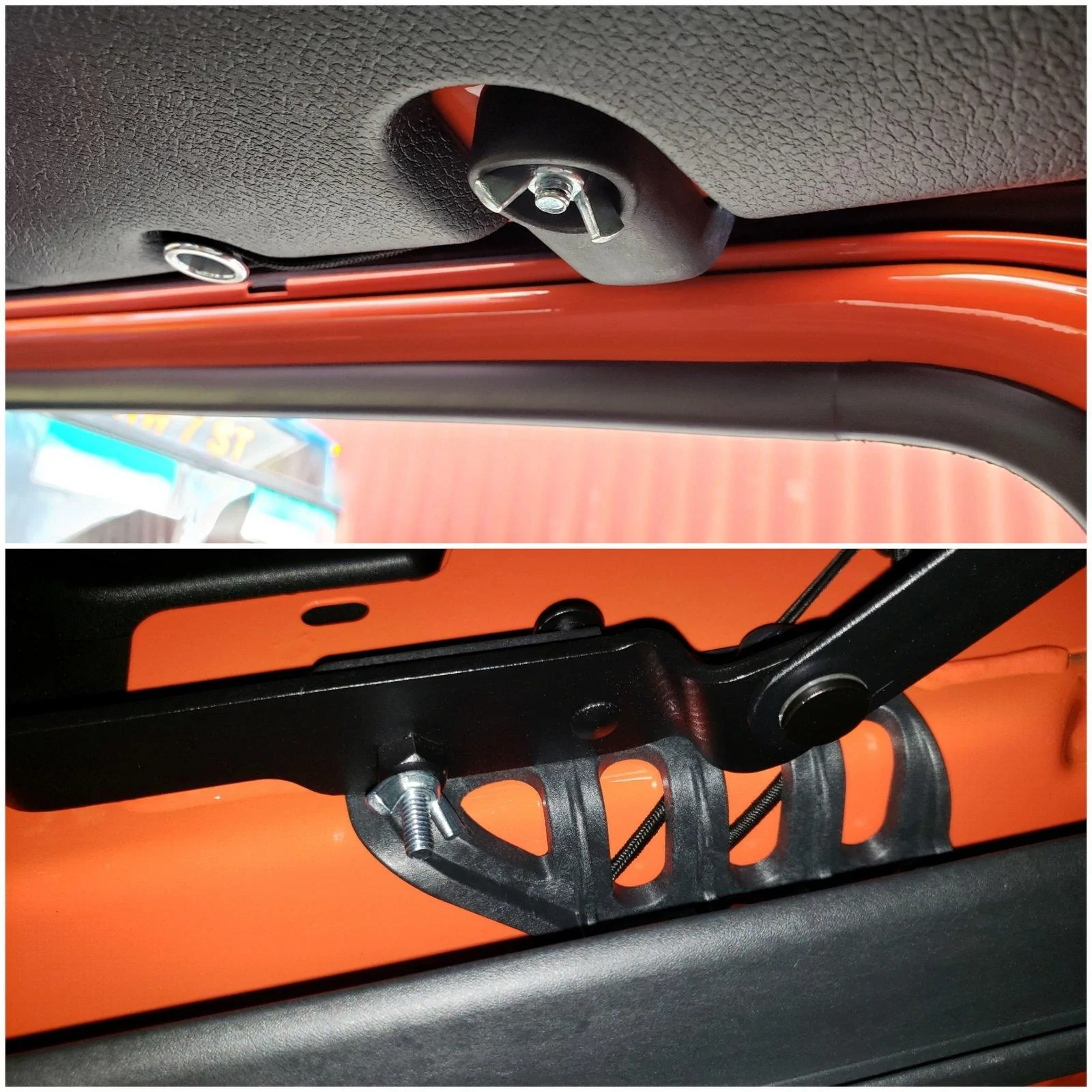

Bought a new soft top today and need to copy your hack for this weekend. Went to local hardware store and bought (4) 1/4 x 1.5" with wing nuts for the top cover and (4) 1/4 x 3.5" for the roof holder.
Why 1/4" because fits in the hole without damaging the thread for after trip by the one from Amazon.

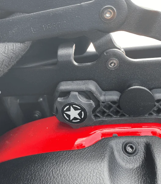

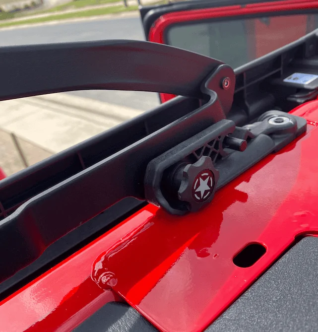

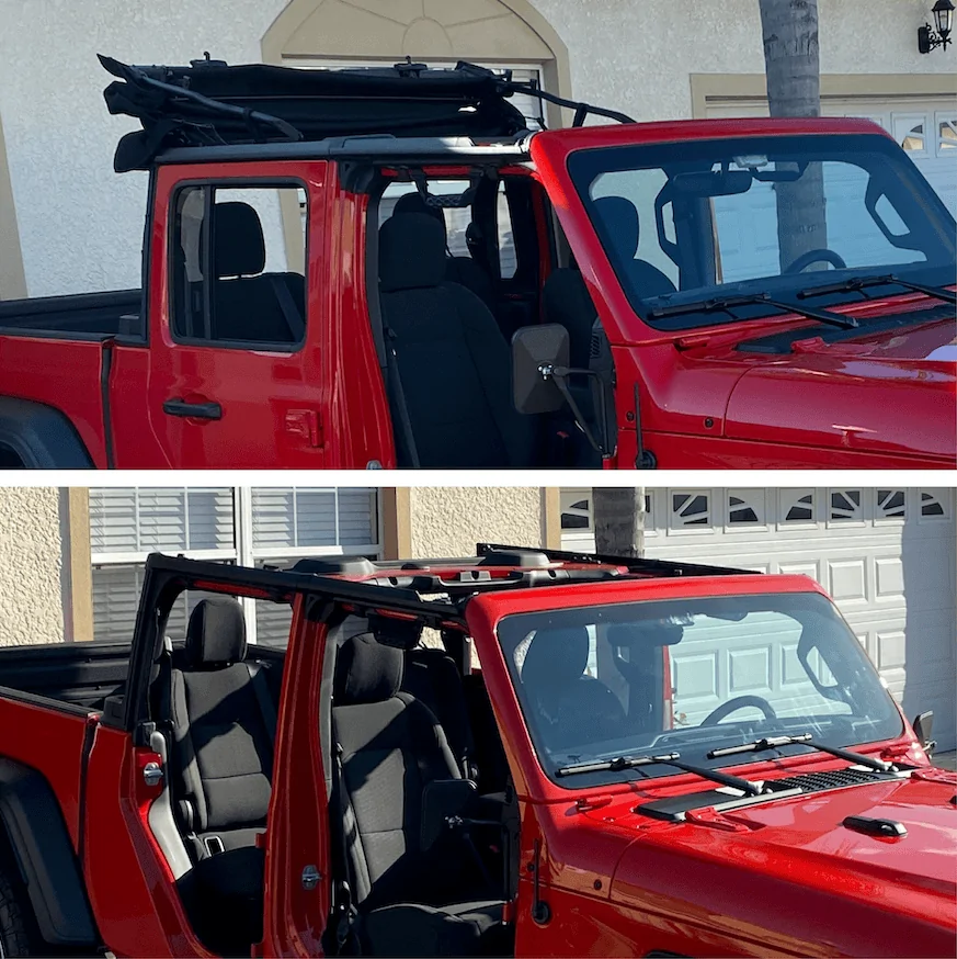

I don't regret going with the soft top option but I REALLY hate the fact the top lays on the back when opened.
The top is actually very light and only held on by four bolts.
So, I purchased a set of Quick Release Thumbscrews for a hardtop (6 in a package)
https://www.amazon.com/gp/product/B01N5O6JC0/ref=ppx_yo_dt_b_asin_title_o00_s00?ie=UTF8&psc=1
Then I used them for the top (4). - You are still going to want 6 because you are going to want to double up on the washers for the front bolts.
It now takes about 3-4 min to be totally topless.
Here are the photos...

working great, no issues with it fully removing or just folding back like this. only downside is storing the bolts since they really don't fit in the under the seat holder anymore like this.

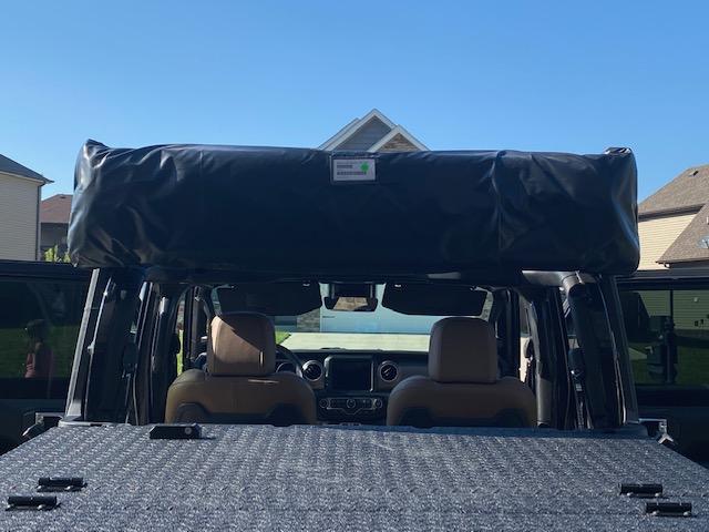

Did your soft top come with this cover? Mine came secured in this from Mopar. I ordered The bolts you showed to take it off quickl. Thanks for posting this. Jeep Gladiator Total Topless Hack (For Soft Top) A365A3E0-F51C-4C5A-9FE6-84C7ACC30DE9

Did your soft top come with this cover? Mine came secured in this from Mopar. I ordered The bolts you showed to take it off quickl. Thanks for posting this. A365A3E0-F51C-4C5A-9FE6-84C7ACC30DE9.jpeg
I got a soft top only it did not come with anything like that in mine. Just two strange velcro straps I never used and lost.

My soft top also came with this storage cover when I took it out of that huge cardboard box that contained all the parts. Those two velcro straps are for wrapping around the top hardware so that it does not cause buffeting on the fwy. They do not seem to be needed. There is also some stretch straps to roll up the back window, but, I read on the wrangler forum that this can cause "clouding" of the back window over time, so, I just take my window off, keep it straight, and put it into the mopar bag in the back of the bed.
