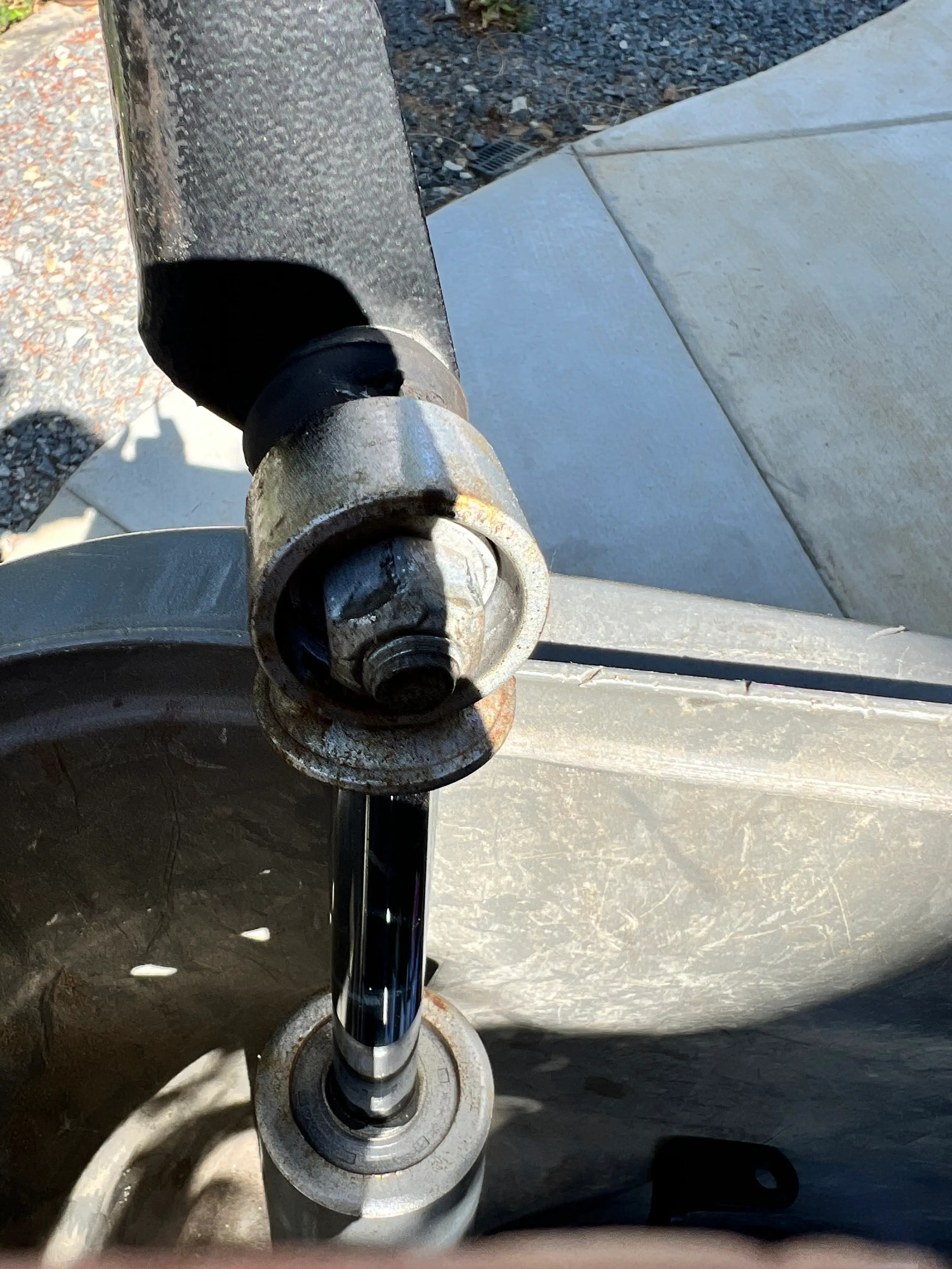

Doesn’t fit, no abrupt sideways blow. First weekend off road was the worst abuse of front end. Hit a big hole at 25 mph (collapsed drain pipe) knock the front end out of alignment badly. Had it realigned. They did a poor job, put rough country upgrade steering stabilizer. When I noticed extreme tire wear. Took it again for alignment- then got the death wobble. Upgraded steering stabilizer to double fox. Found the bushing of the rough country stabilizer, pulled out. Installed the Double Fox, alls good- no more death wobble. Then slowly backing up pop goes the arm.

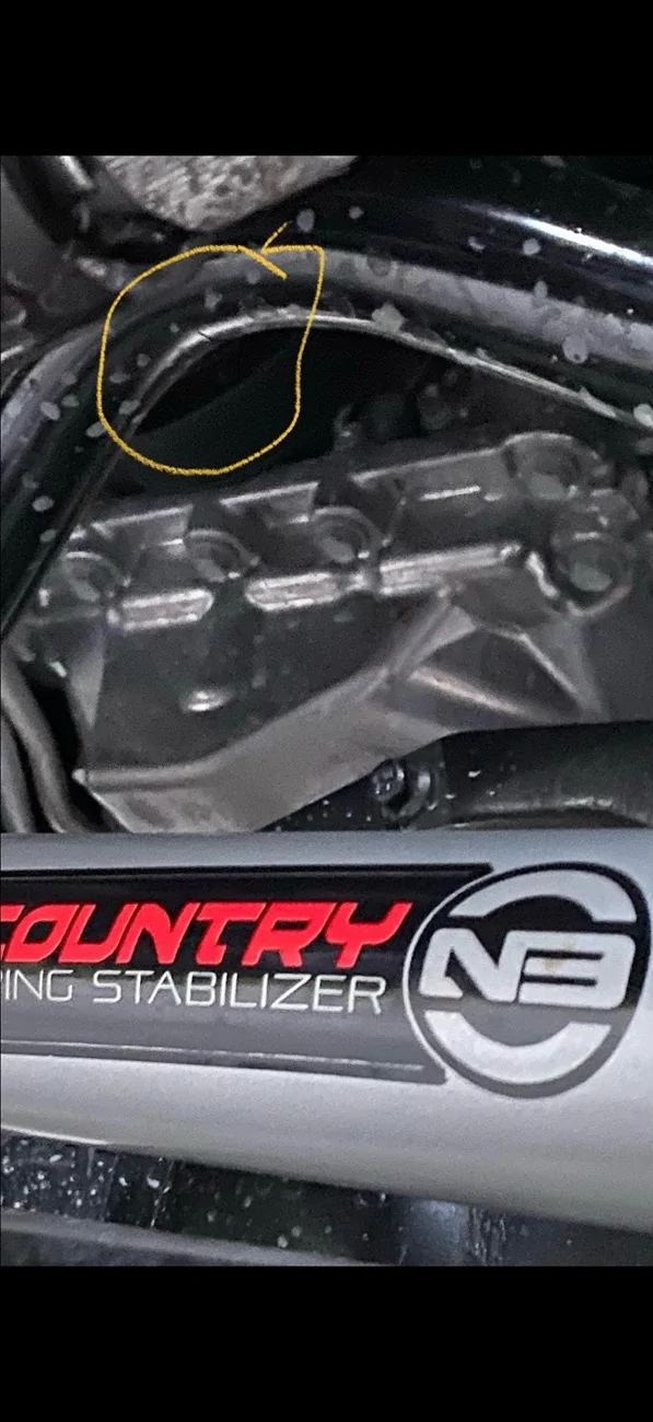

No cut, stress fracture. Took place at the apex of the bend in the tube. On a photo that I posted with the rough country stabilizer I think I can see a small crack where the fracture took place.
Definitely not cut. Looking back at the old photos specifically the one I took after installing the rough country stabilizer I think I see a crack.
Yep I can see the crack.

I'm on my laptop now. I can see the crack in the paint.
But what I don’t understand. There is no rust on the break. Normally you would have some rust in the break area if it started 5 yrs ago.

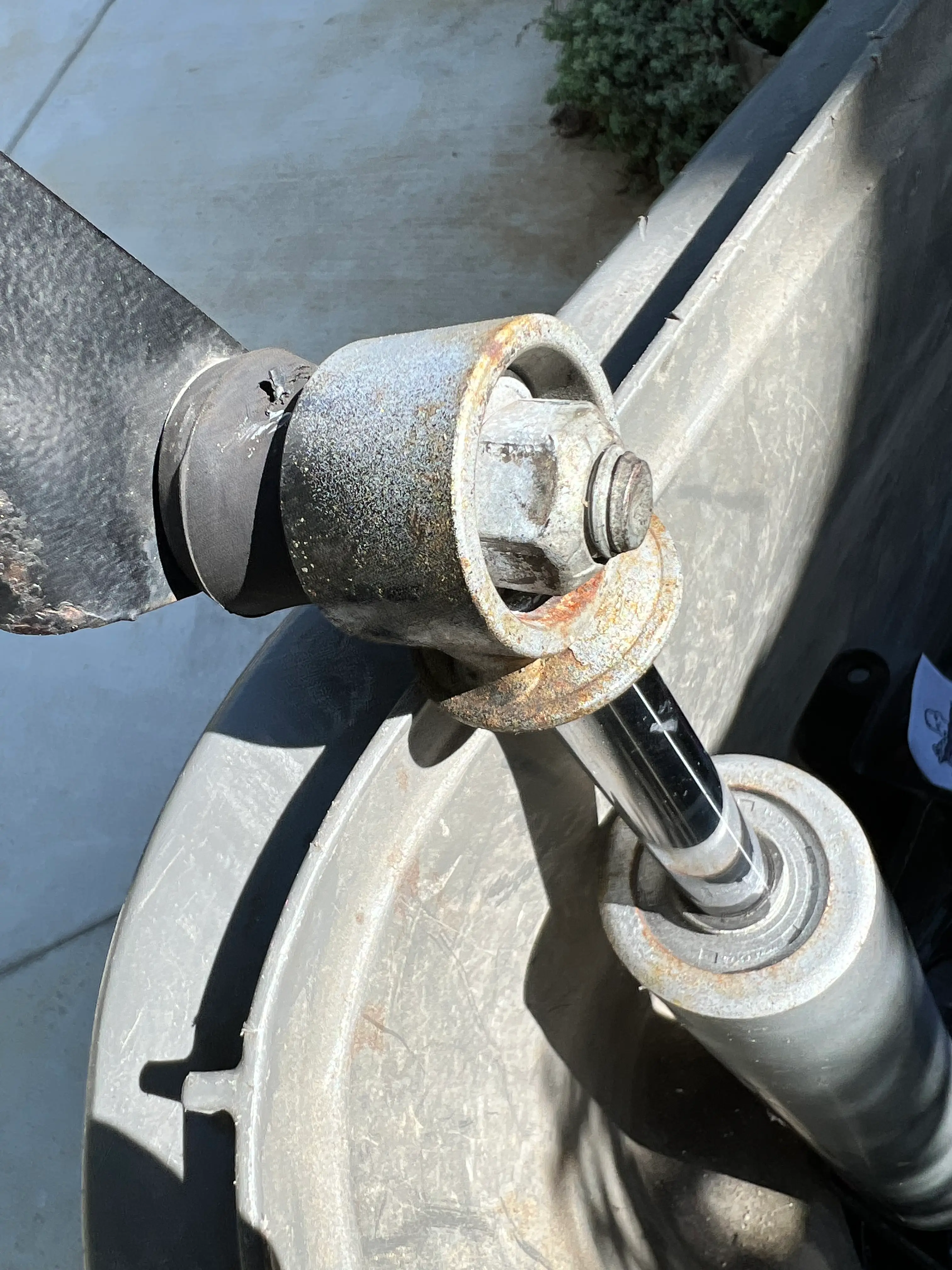

I hit a really deep hole off roading- where an old drainage pipe from the 1930’s had given way near an old Dam I fish near. It really knocked my alignment off. The Jeep dealer did a lousy job at realignment which caused me to upgrade my steering stabilizers. A year later I discovered
Still no answer on that.
I Was told when I purchased the jeep the lift was a Mopar lift so it was able to have factory warranty. He said it was a 6 inch lift, as has been pointed out mopar doesn’t sell one, just a 2 inch.
terrible tire wear. The dealership said whoever aligned your Jeep did a terrible job. I then told him your shop did the realignment- so knocked $50 off the bill. After that visit to realign my truck I began to get the death wobble. So I took it to another Jeep dealer and they said it was the fact that I had installed aftermarket steering stabilizers. I took it back to the place that misaligned it and they said the same thing. So not knowing what else to do (besides sell it) I ordered better Steering stabilizers. And that’s when I discovered (see attached) the bushing on one of the Rough Country failed(or was pulled out while they realigned it?) . After installing the Fox Steering stabilizers I haven’t had a death wobble. Now a fractured front track arm.

2 shops were wrong telling you your death wobble was caused by the steering stabilizers you installed. Death wobble is never caused by a steering stabilizer which is just a shock. A shock cannot cause violent oscilations like death wobble.
Goofy thing is - it's said the stabilizers fixed the DW - no, they mask and absorb it. .the reason, the root cause, is still there.
Sorry, you put a band aid on it - you need to find the cause of the DW.
Find a shop that knows something.
Exactly 💯 % when the front end is correct. The steering stabilizer shock can be completely removed and it will not wobble .
I aint staying not to have it on there it is needed for bridge approaches bad potholes etc.. but it does as ShadowsPapa said NOTHING to stop DW. It is to stabilize steering wheel steer when you hit a big bump.

It seems the shops OP went to also think the stabilizer can cause death wobble. Not only that it prevents it, but it also causes it. Crazy.
...After that visit to realign my truck I began to get the death wobble. So I took it to another Jeep dealer and they said it was the fact that I had installed aftermarket steering stabilizers. I took it back to the place that misaligned it and they said the same thing.
That’s what I thought, but once I replaced the damaged one (rough country) all was good no more death wobble. I think I injured this track bar when I hit a huge hole. And it finally fractured.

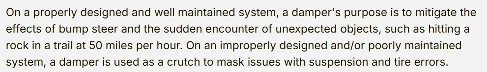

It's masking it. The CAUSES are still there. Eventually, the stabilizer will wear out due to the cause still being there.
It's like painkiller and a bandaid on an infected wound - you don't feel the pain or see the wound, but it's still there, festering under the surface.
Don't be fooled.
Look up the name "Norm Layton" - he said this -
