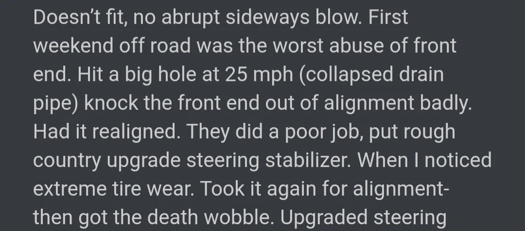

Doing more harm than good? No more death wobble I think it’s doing more good, and no harm. I’ve read every article I could find about DW. I found the bushing off the Rough Country. I removed that and replaced with top of the line Fox stabilizers. I’ve been Death wobble free for over 30 thousand miles. This fractured arm is a result of the initial injury. We’ll find out in a few days when I install the new Synergy and take it from there.
So, I know you think you know what you are talking about. But I promise you, you don't have a clue. Yes. It may have stopped the death wobble. BUT it did not fix it. You still have a death wobble issue that's being masked by, not one but two steering stabilizers. If your steering is set up correctly, you technically don't need a steering stabilizer at all. If you truly think the death wobble is gone. Then remove the dual stabilizer or at least run one stabilizer and report back.

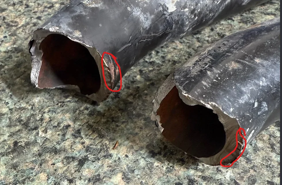

I was expecting more rust, deeper into the crack.
Valid point, to me that shows that slight damage can occur and overtime weaken it. I am shocked at how thing that DOM is. Man am I glad I went with forged. Since install of the forged track bar I have hit some flat doozies. And no damage held up strong .

There it is, 25 mph is not good.
Not a racing truck.
Might have bent the frame. And no matter how many steering stabs you put in, it won't be right.
