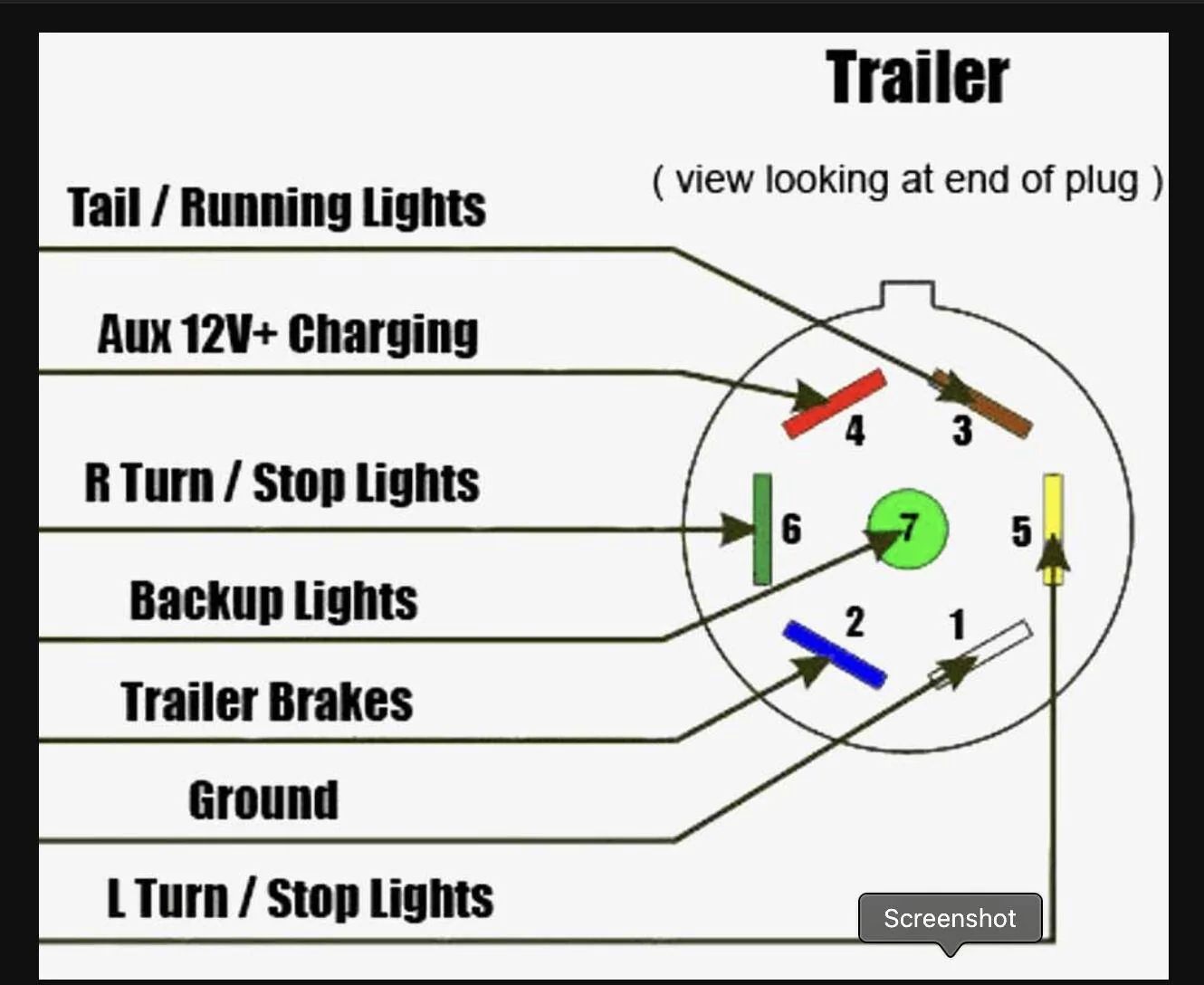

What I find interesting is that there's a plug/contact for 'Backup Lights'. Who has backup lights on their trailer? Mine doesn't. So, why the contact labeled as such 🤔 🤔 🤔

In believe most new light kits you buy have a newer 5 pin plug set up.
The additional pin is usually a blue wire and is used for reverse lights.
Having them and using them I find useful..
Most don't have them because it's not required by federal law - however, many companies are starting to add them, and for a while, you have been able to buy campers with backup lights.
Venture RV includes them standard.
I have a 2021 Venture Sonic and it doesn't have them so maybe they're on newer models 🤔 🤔 🤔
Could be. Looks to be, from what I find, that more are going to add them - with the big demand for cameras, more lighting and so on - maybe they've done some consumer research.
I know if I was buying today - I'd be willing to pay a bit extra for GOOD backup lights on the rear end of a camper.
Your 21 is already 4 years old (uh, not wanting to make you feel bad or make it look like it's yesterday's news or anything! That's not it.......... but maybe some stuff has happened in the last couple of years?

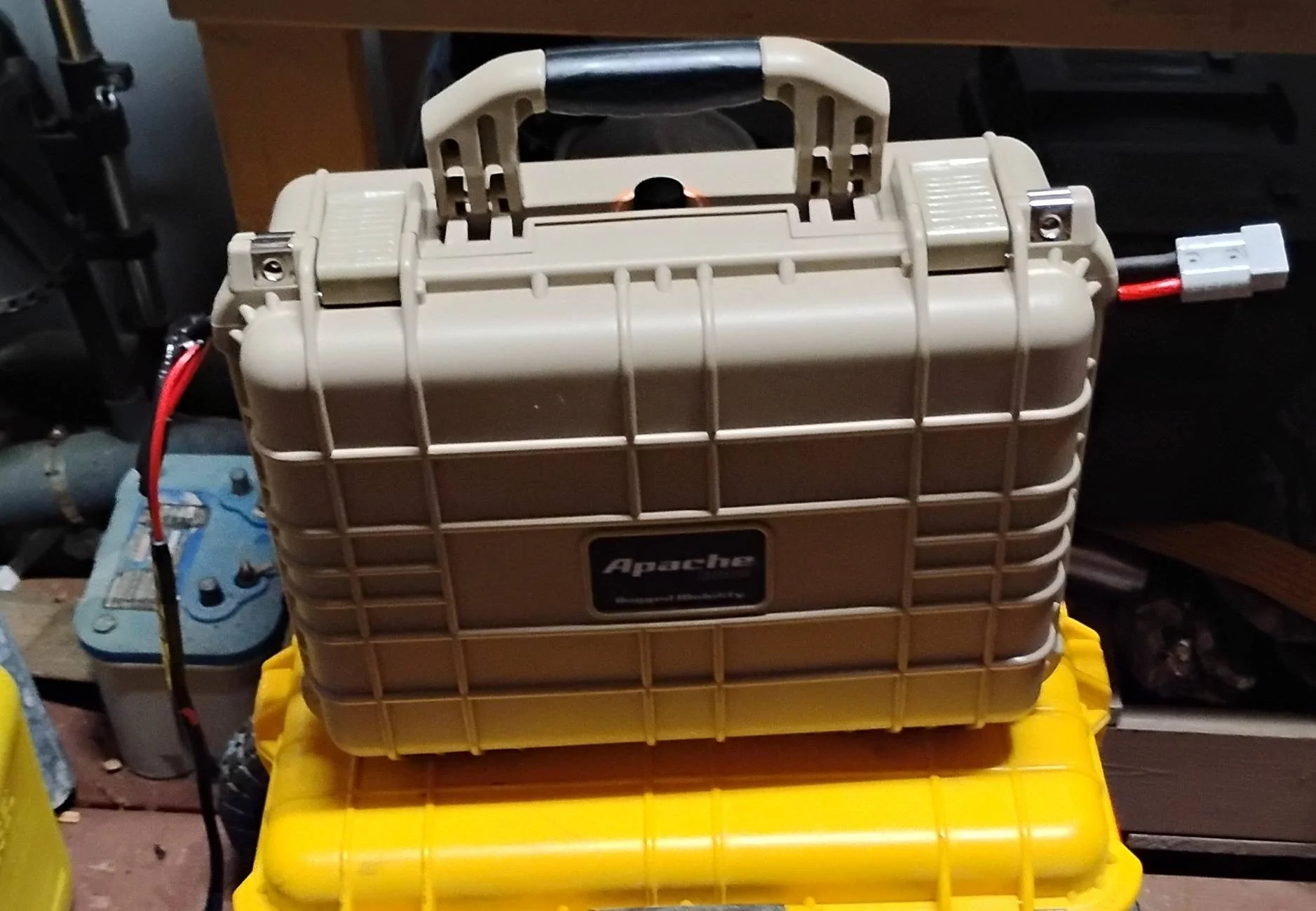

Main concern is to just plug in the pumps and run some camp LEDs
I have a few LED lights and a water pump in my Gladiator along that line.
Earlier today I was "making a portable battery system" using the original batteries I had in my Gladiator on the solar system.
Jeep Gladiator Trailer plug adapter for extension cord IMG_20250411_224314379~2
2 36 amp LiPo batteries now in a H.F. case to protect them from water to use on boat and camping. Saving some weight from the blue Optima in background.
