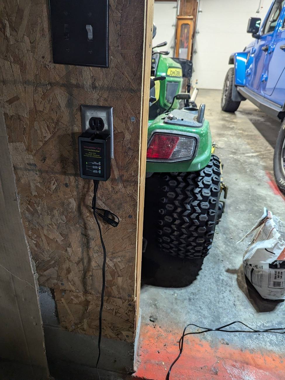

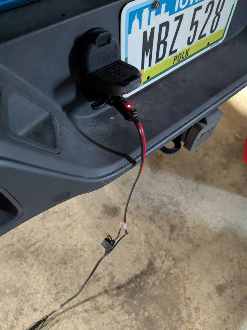

I think you said you just plug in a trickle charger to that 7 way power outlet to charge your battery?
A BatteryMinder 1500mA plugged into outlet and a cord running to the trailer connector.
That's pretty slick. I like it a lot. I'm going to have to do that. I have Battery tenders all almost all of my equipment... that looks like the way to go on a JT.
