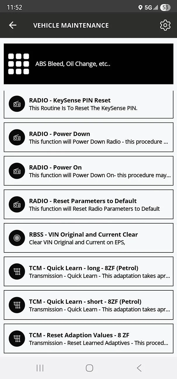

It's this last one on this page of the Jscan app. Adaptive values reset .the 2 above are the ling and short "quick relearns"
I'll keep digging but that may be what the JSCAN users were talking about in their group months ago.
There's a whole lot of stuff it can do.
One thing of interest to me is - show all 4 wheel sensors and you can quickly tell if one is bad or wrong. Good for those who have traction control and similar errors or issues.

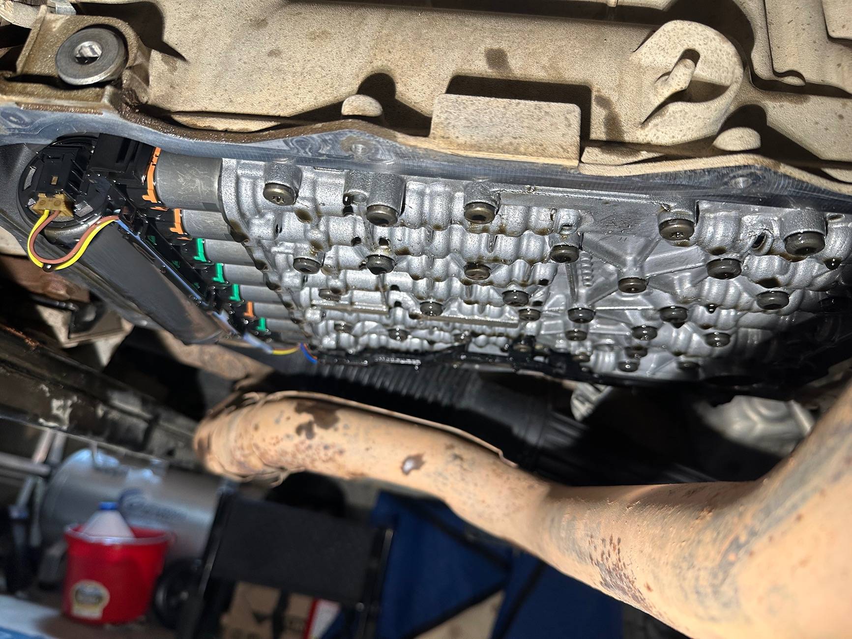

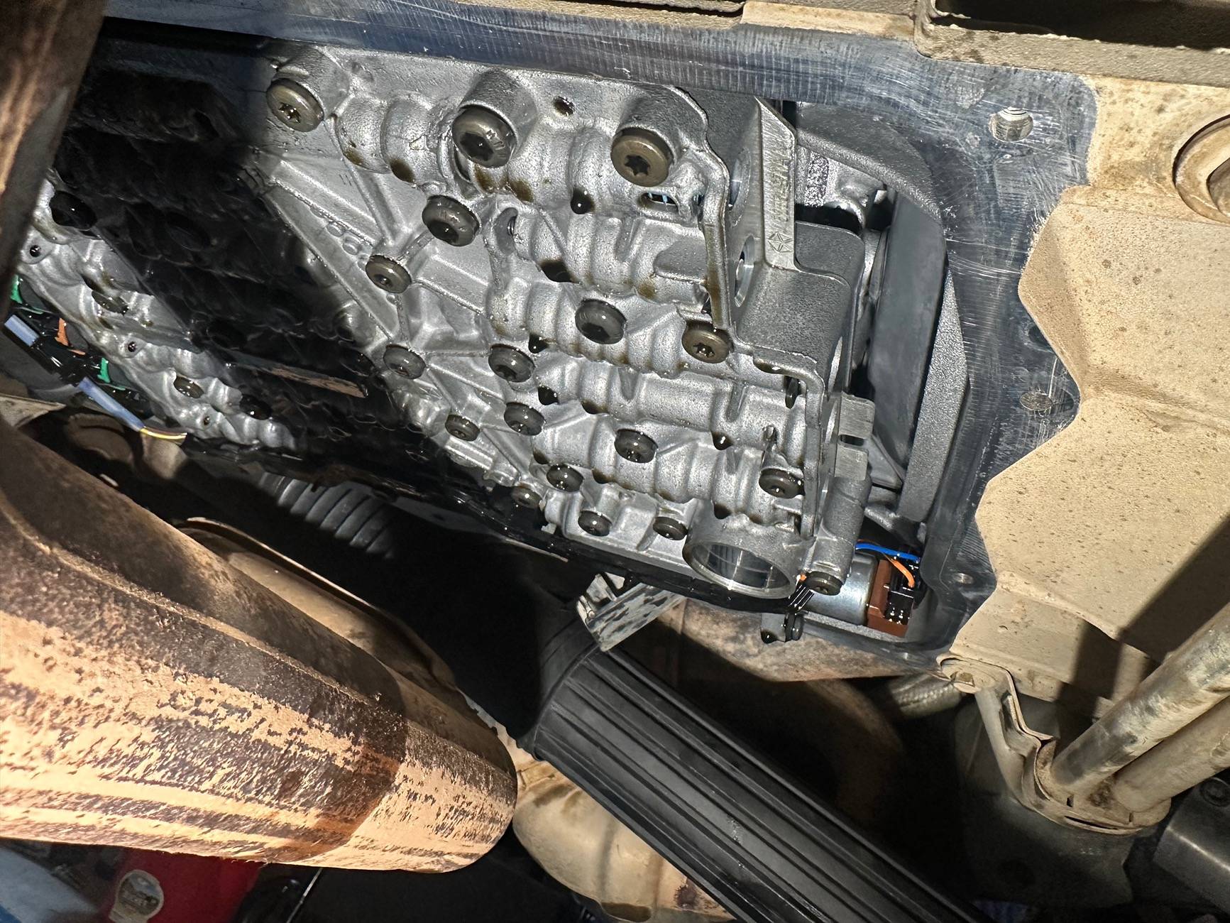

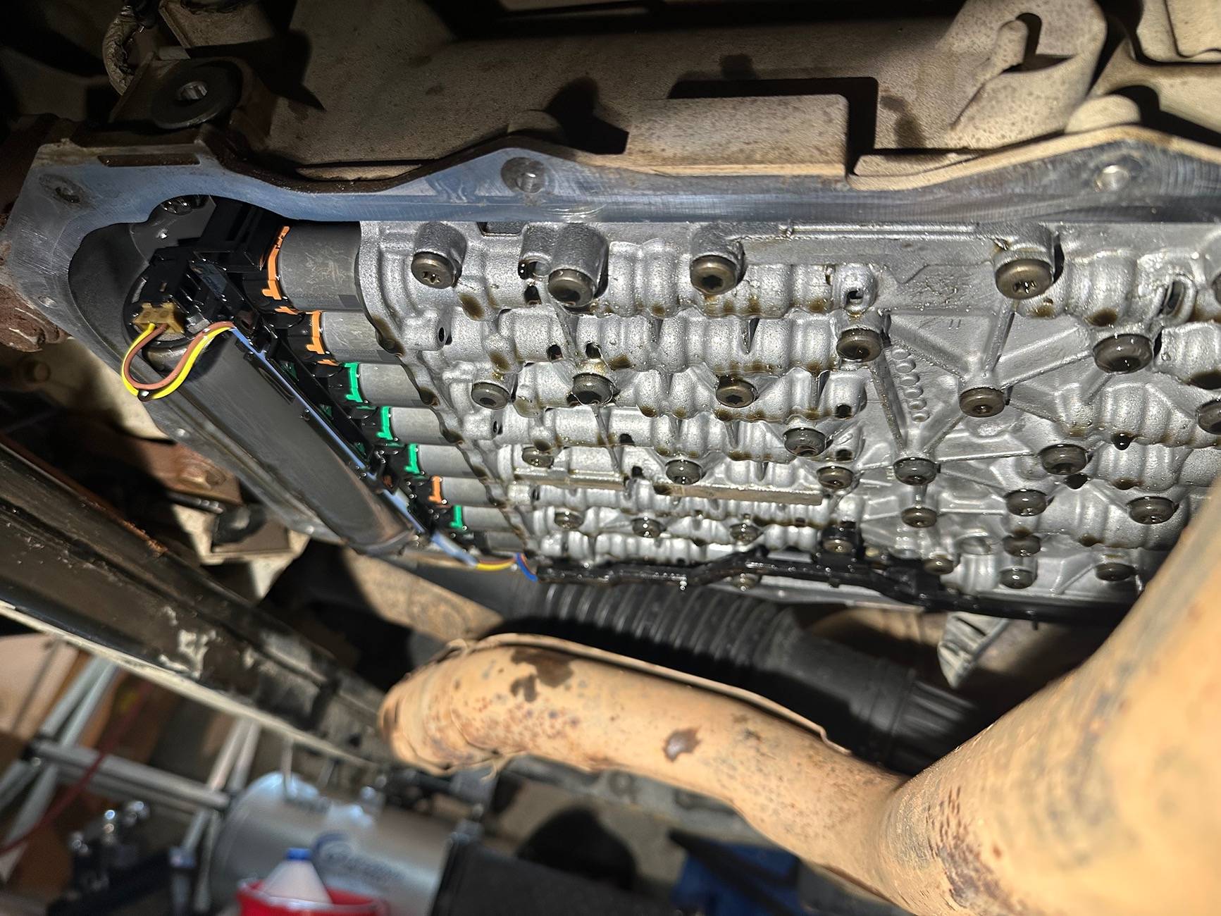

Where was the tranny leaking from? I have potentially a slow seep from the rear or mine. But it could have been the pan gasket. Time will tell as I’ve cleaned it up to see if it returns. New pan and gasket as well. Way out of warranty, but still curious as I’ll end up fixing it myself at some point. Thanks.
It was a weird situation.
It APPEARED to be from the rear of the pan - so Jeep said "replace the gasket".
And if that didn't help -
"Replace gasket AND pan"
And if that didn't help - contact JeepCares and talk to the service manager and let them know - hey, driving it home 25 miles and parking it in the garage, getting out and looking under it to find there are already drops on the floor isn't ok.
Several people went through the same thing - sure looks like a pan leak, drops come from the bolt heads and rear edge of the pan, that sort of area.
But in the end, we suspect it was really a porous case!

Thanks. Mine definitely had a pan leak. Just enough to create seepage and dust collection. Not enough to drip on the ground. So when I replaced the pan, I used a new mopar gasket. The new mopar gasket is an entirely different design than the one I removed (2021, late 2020 build). I’m watching it quite closely to see if it continues. The mating surface looked perfect on the tranny itself. No imperfections I could see. I’m hoping the gasket design change is due to the original design leaking. But with everything else I’m working on, it hasn’t moved out of the garage since I did the pan drop. I hate not having driven it after that kind of maintenance, but I don’t have much choice. The gas tank would fall out if I drove it. :)

Here are pictures with the pan down.
Jeep Gladiator Transmission throwing check engine light. IMG_2248
Jeep Gladiator Transmission throwing check engine light. IMG_2249
Jeep Gladiator Transmission throwing check engine light. IMG_2247
Can't hurt to take a GOOD, known straight edge to the pan and the case pan mounting flange if you ever take it apart.
The case looked perfect in my opinion. I cleaned it and I think it’s all that was necessary. I think the gasket either failed, or the pan warped due to temperature. Either way, those two things are resolved.
Just for good measure, I obviously hit every single Allen bolt shown with my mid torque impact. And just held that trigger down like a psychopath. I figured it was fine.
