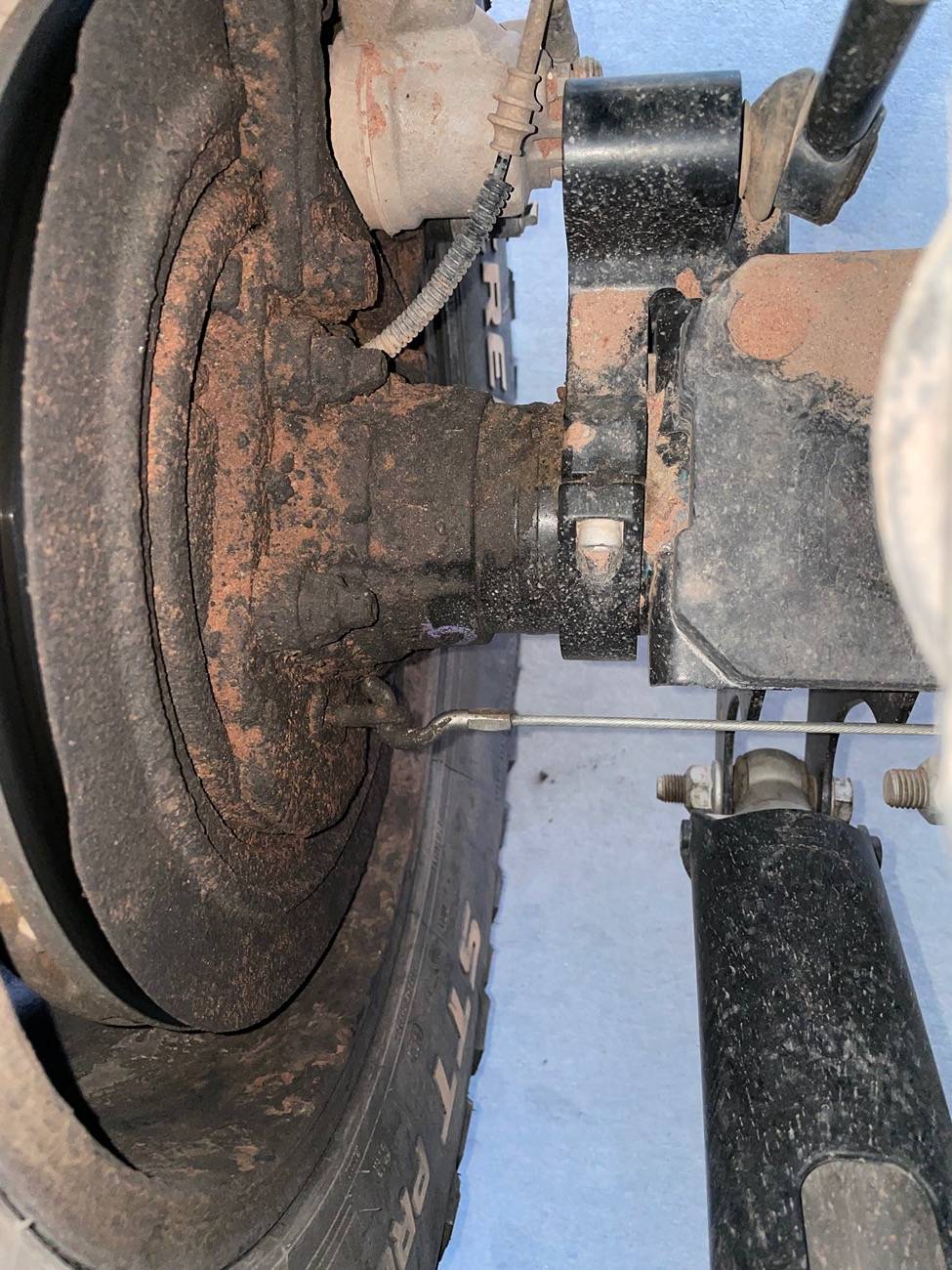

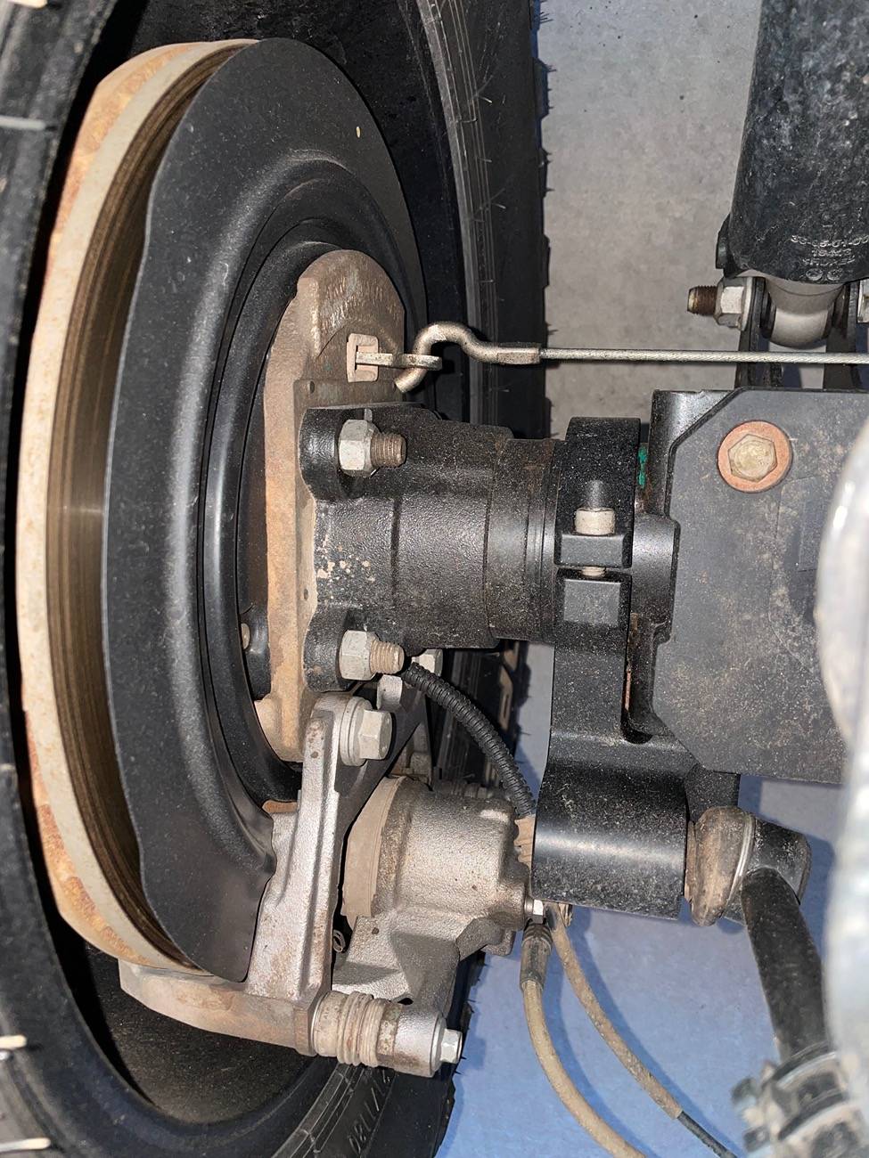

Update they replaced the transmission with a completely new one not a rebuilt one. I’m not sure the exact time it took to replace as I went on a 2 week vacation right after this and I also had them fix a separate issue, the corrosion issue on all 4 doors, hood and tailgate. The whole thing took ~5 weeks. Then I had it for 1 day as I was poking around under the truck just to see if anything looked out of place I noticed that the inside of my wheels were really clean except the rear passenger side and it was filthy! Turns out there is a known issue of the rear axle leaking on the passenger side! So I took it back right away and they are fixing this new issue under warranty. They were embarrassed they missed this and honestly I don’t know how they missed it. Pics are right vs left inside of tire. Ugh! I’m not sure what to do it’s one issue after another on this damn truck but I love it so much and I have so much fun in it. I know I will not enjoy another vehicle as much as this one if I get rid of it. I’m torn.
Jeep Gladiator Transmission throwing check engine light. IMG_7211
Jeep Gladiator Transmission throwing check engine light. IMG_7210

I am with you on this. How bad could a Bronco be?? The list of issues on my JT is getting longer than my desire to keep it.
