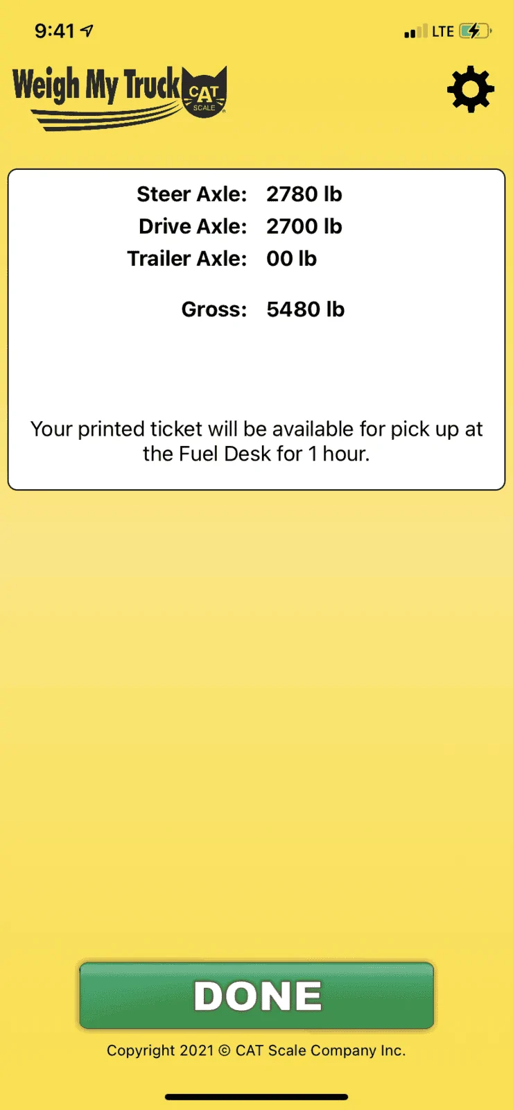

So I picked up the new trailer today (Keystone passport sl 221bh). In summary I am relatively pleased with how the JT handled the load, and the whole family especially the kids love the camper, and after a dinner in the driveway inside it we are 100% confident we chose the right trailer. Subjectively I was comfortable towing the trailer. Considering it was a very cold and gusty (20-30mph) day, I thought the JT did excellent. Stopping power was no issue with the curt spectrum controller and brakes on both trailer axles. Power was adequate and nothing more. That being said I definitely still have a bit of uncertainty.
Before getting into specifics, understand that my truck is a mostly loaded Rubicon auto with a 7k tow rating. GVWR is 6,250 lbs with a payload rating of 1198 lbs. The stated max hitch rating for this configuration is 700lbs.
I weighed the truck on a CAT scale before picking up the trailer. Other than my dad-bod self the truck was loaded with only car seats, builtright bedside molle panels with fire extinguisher, axe, shovel and traction boards, an arb single compressor and a swingcase toolbox with minimal tools. I filled the gas tank immediately before weighing. Here are the results:
Jeep Gladiator Travel Trailer Debate- Experienced Opinions Wanted 3299678F-57C9-410E-999B-DCC4B8982E53
As you can see this leaves me with a real world payload of 770 lbs in addition to myself.

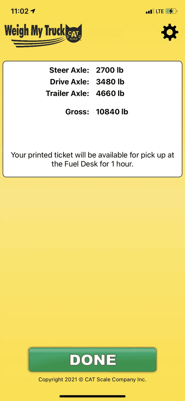

After picking up the trailer including 1 12v battery and 2 full 20lb propane tanks, hitched with an E2 weight distribution hitch I returned to the same scale. Here are the results:
Jeep Gladiator Travel Trailer Debate- Experienced Opinions Wanted 1121D2E9-2A5C-48C2-9CD0-24426BA3A22D
As you can see I am transferring 700lbs to the truck via tongue weight. This is good news as I thought for sure given the mfg spec of the trailer of 685lbs tongue weight I would exceed the 700lb hitch rating after adding propane and battery.
However if you look at GVWR I am nearly at the max- 6180 of the 6250 rating. I have 70lbs left, and this is before loading any gear into truck or trailer.
I do think I need to make some adjustment to the weight distribution hitch, as you can see by the scale readings I am still losing 80lbs off the the front axle with the trailer attached.
At this point we are clearly going to have to drive 2 vehicles anywhere we haul the camper. Not too big of a deal. However I would like to be able to also take a few kayaks, or possibly a canoe. The 70lbs left of payload just doesnt afford much additional capability. I guess I am mostly surprised by the weight of the truck itself with only a few accessories (keep in mind tires wheels etc are all stock, and I only weigh 200lbs). A bumper and winch which I was set on is most certainly out of the question.
So am I being overly analytical with these weights, should I just send it and not worry as the truck did seem to handle well? Or is this definitely big truck territory- like 3/4 ton since most 1/2 tons with any offroad capability or features dont have significant payload increases. I really dont want to give up either my JT or the wife’s JL, and hate the thought of going back to trying to live with a 3/4 ton as a daily driver.

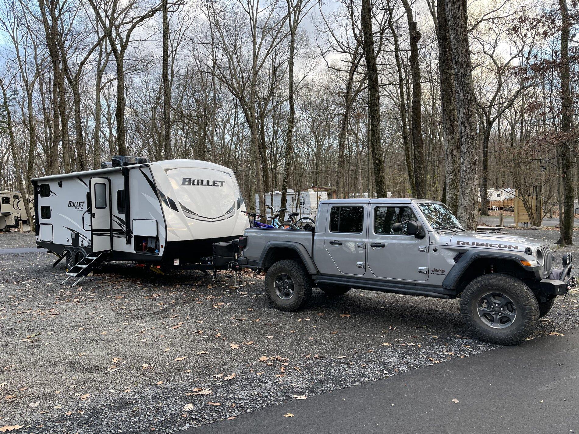

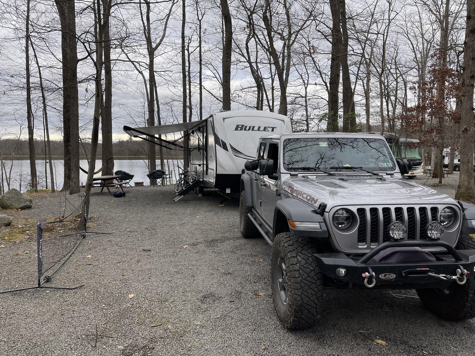

I tow a Keystone 243BHS with my rubicon with 37” tires and 4.88 gearing without issue. It’s not a speed demon but I tow nice and slow and it works great. The 243 has a full front bedroom, double bunks and a slide and is 5200lb dry with a 580lb hitch weight. I am sure when we load up our stuff we are over 6000 and I take a family of 4 plus my dog and we tow all over the place. Although in the mid Atlantic we are mostly flat.
Looks awesome-any chance you have weighed your set up? Curious as to how much payload you have? Seems like if I load up like that I will be way overloaded on payload/ gvwr. The 221 BH I bought has a large 10'6" slide that is 2/3 ahead of the axles, seems like thats the reason for the higher tongue weight.
I haven’t weighed it but it seems to tow without issue.
