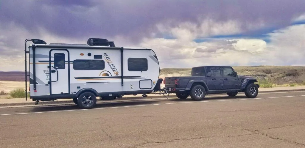

I thought I'd add my recent TT towing experience, just to add to the thread's body of knowledge and the discussion here.
Background information: my rig is a 2021 JTR w/tow pkg and I pull a 2021 Rockwood Geo Pro 19FBS. The trailer is 20' from stem to stern and with my stuff in it, weighs ≈3,500#. I do use a weight-distribution hitch. I use the Curt bluetooth brake controller. This is my first big trip with this setup. Previously I had a much smaller TT from Riverside Retro.

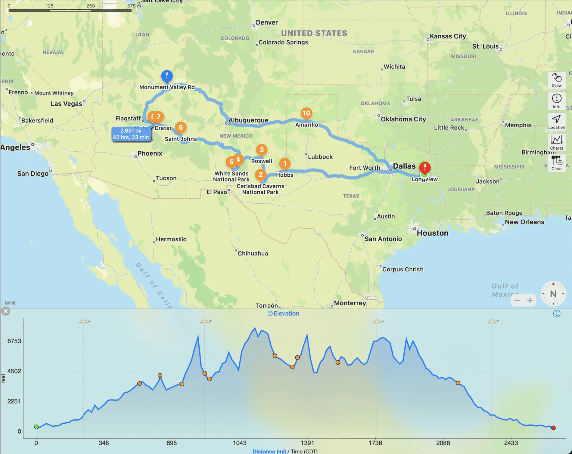

Last month I went from where I live in NETX to Hobbs, NM; Carlsbad, NM; Roswell, NM; Alamogordo, NM and White Sands National Park; up to Meteor Crater National Park, Petrified Forest National Park, and [standin' on a corner in] Winslow, AZ; up to Monument Valley, UT; to Amarillo, TX; and back home. Total miles driven was right at 3,000. I averaged 8 mpg (ugh!).
Here in NETX, we're very close to sea level. Several times out west on the trip we were >7,500' in elevation. I've included a map with the elevations so you can see just how much we had to climb out that way.
Impressions: the JTR pulled the trailer fine, albeit with ghastly fuel economy. The truck and rig were stable, easy to steer, and comfortable. In those places where the terrain was flat, the transmission spent most of its time in 5th or 6th gear. If there was any up-grade at all, 4th gear was where it stayed ... and stayed ... and stayed. At no point did the engine come close to overheating. Oil temp and transmission temp were both fine, too. The transmission did get up to about 217°F when pulling up long, uphill grades, but that was still within acceptable limits.
Recommendations: Anything much bigger than what I was pulling is going to be an uncomfortable, tough tow in the JTR if you're going to be climbing up hills or mountains. You'll get to the point where you're afraid the tranny is going to fall out of the truck because it spends so much time in 4th gear LOL. Clearly it can handle the towing, but it really has to work to get you there. The fuel economy is what will really give you nightmares. If you fill up your tank, immediately start looking for the next gas station!

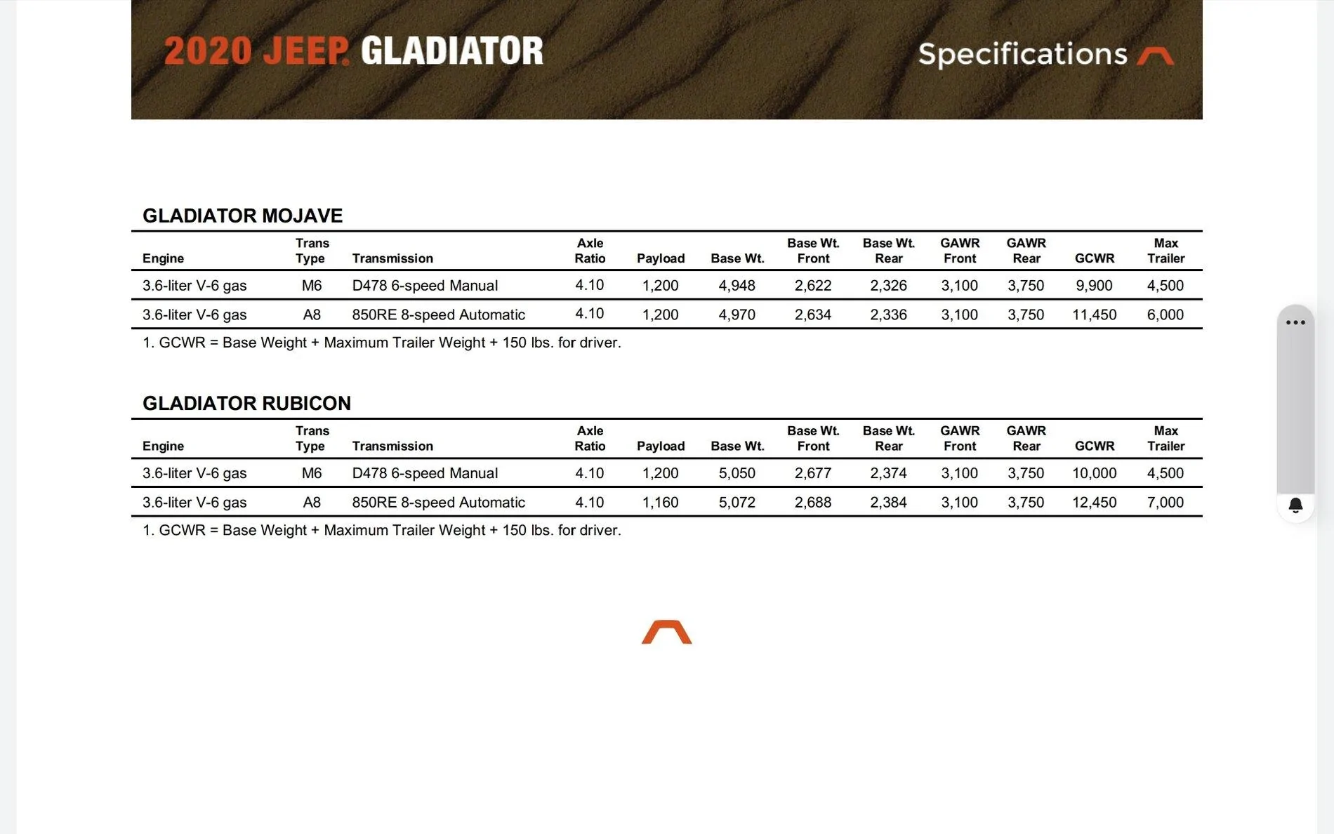

I want to throw some gas on this fire. Something that has not been brought up yet is GCWR. Gross combination weight rating. The op says he is 290 pounds over but is he?
This is a screen shot from the 2020 specs so it may be different for his set up. His weighed combination weight is 11640. 800 pounds under the listed GCWR.
So by those numbers and the fact he isn't over on his axles says he is well within the limit.
Yes, I too was a collision reconstruction officer. I did fatal collisions. People that got in wrecks because of their vehicles were grossly overloaded by say thousands of pounds. Or had poorly maintained equipment or bald tires. One investigation had a semi hauling 26000 pound spools of sheet steel secured with 3500 pound chain.
I hear it all the time but I wonder if anyone can find even one instance where an insurance company fought a claim because someone was over by 300 pounds. I don't even know how they could really prove that after an accident. The whole truck, trailer and occupants would have to be transported to a certified scale. I know, we had to transport a school bus on a Landoll trailer to an evidence garage. With the axles hanging off. Was a very difficult process and only done because it was a school bus. But I digress.
Long and short, I think he is good and actually I believe he is legal.
