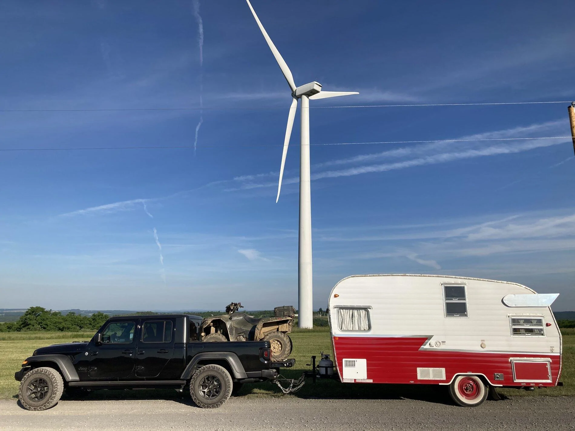

I purchased the JT with the sole purpose of towing a TT. We like to mountain bike and hike. The group we go out with always stays for the weekend. I got my gf in tent twice last year and she said No more.
There are other options. Last year we used Outdoorsy.com a couple of times to rent campers. You have to arrange a campsite and trailer. The trailer owner will tow and deliver the camper to the site, set it up and take it down for you. It worked out well for us the 2 times we used it last year.

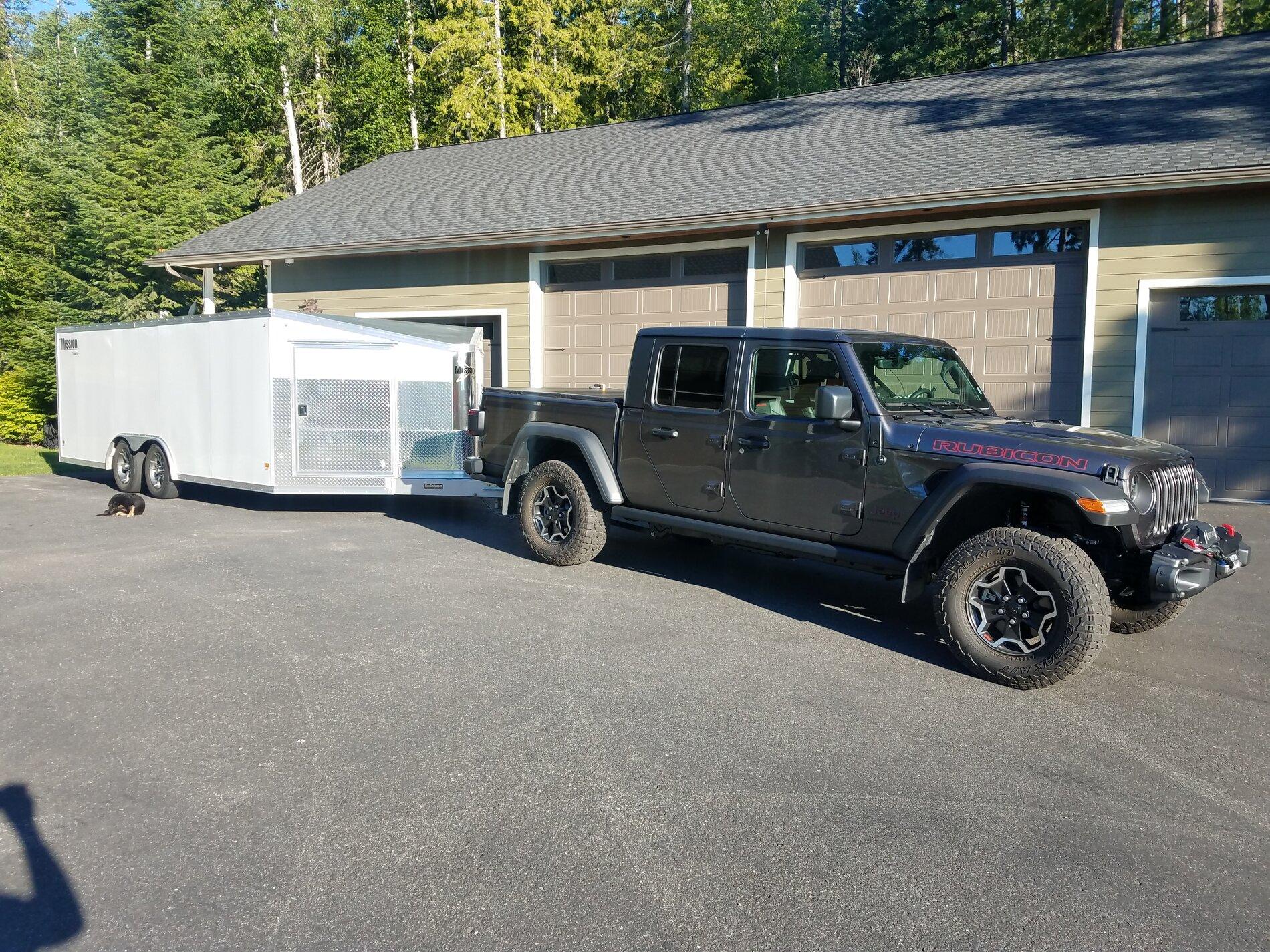

I've owned a small Rpod 179 for the purpose of pulling behind my older Wrangler since 2017, 400lbs tongue and 3350 totally loaded. It (the Wrangler) did ...."ok". After purchasing the Eco Gladiator I preformed a test pulled with my loaded car hauler, 4850lbs with 500lb tongue. Jeep is mostly stock with a 1" level lift spacer and rear coil bags. I was blown away with how well the Gladiator passed the "test". The hauler is within a few lbs of a travel trailer I've had my eye on for awhile now but the wrangler would have been way under spec'd. So, yesterday I ordered a loaded Lance 1995. A bit spendy but a fantastic option for the light Gladiator trucks IMO as the come dry at 390lbs hitch and 4265 gross unloaded.
Lance Lance 1995 Travel Trailer - The 1685's bigger brother features walk around queen bed. (lancecamper.com)
Test pull
