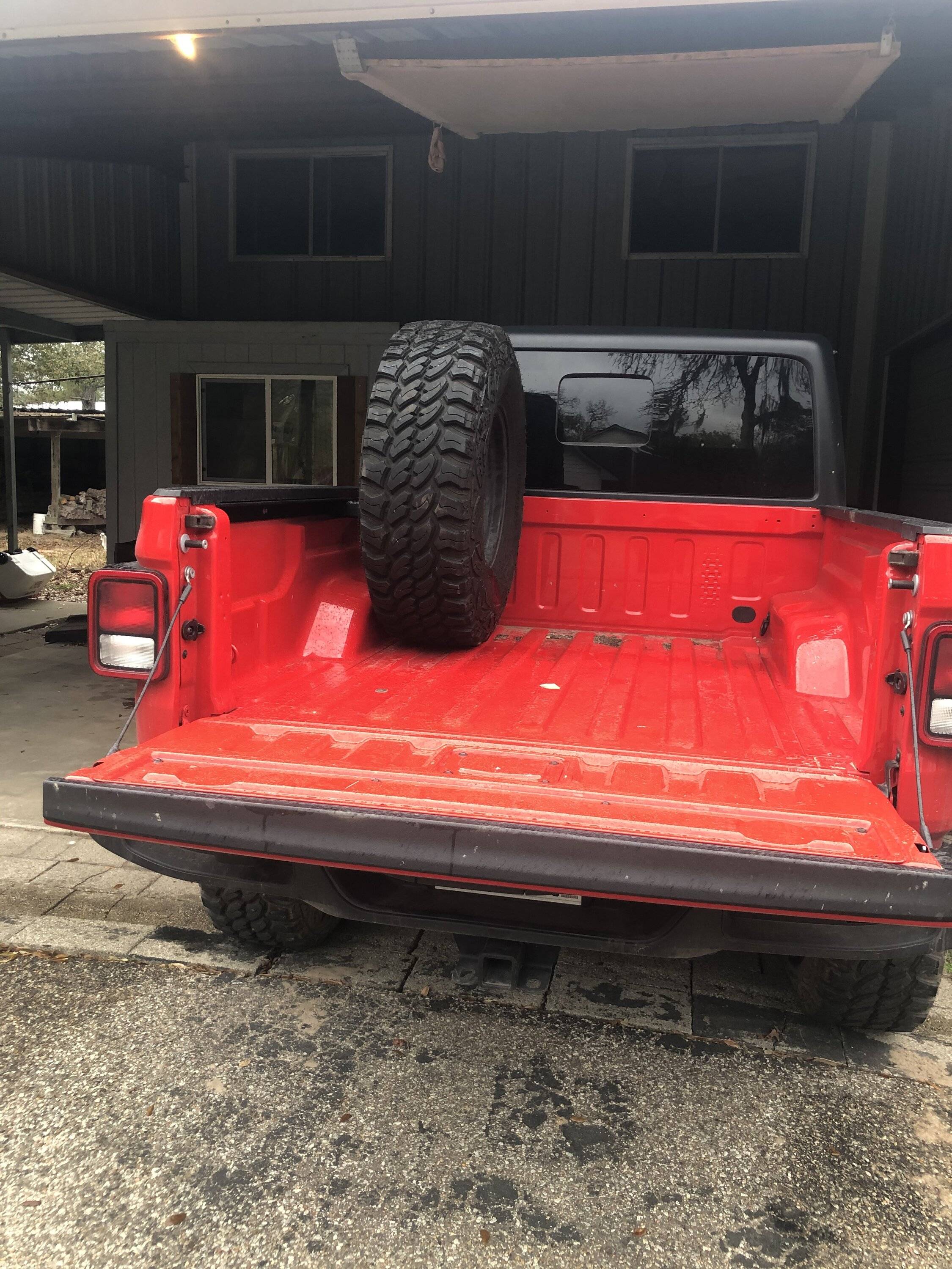

I have to admit, I kinda knew the bed was made with thin material. But c'mon hahaha I also figured for the fucking price of these things, it would or should I say SHOULD hold up better than this!! After getting the truck new, I installed the lift and tires only to figure out that the 37" wouldn't really fit under the bed anymore without making a few tweaks. So I made my own mount at work so that the tire would sit in the bed! Looked great and worked great. With traveling to the armpit of Texas ( Midland-Odessa ) for work I wanted to make sure I had my spare. Fast forward to today and well, I can't really get mad because I'm the one who tried to save money by making my own shit but I also should have known better in the long run.... Does anyone know off the top of their if a body shop can just cut this strip out and weld in a new one?? Before y'all even say it "Why don't you just call a body shop??", Work is crazy for me so when I get time for myself, I prefer to sleep when on the road. Figured I would look on here to see if anyone has possibly made a similar mistake or accident. Or if anyone has any recommendations on another route to go. Thanks for time!!

it worked great and didn't take up too much of the already small bed. Still have enough room for a snap-on roll cab loaded with tools and other stuff I need to travel with. the only bummer was it made that one D-ring a bitch to get to.
Did you really to to hold up 100# worth of wheel and tire with a single M6 into sheet metal?
Dymanic loads do be doin' that.
