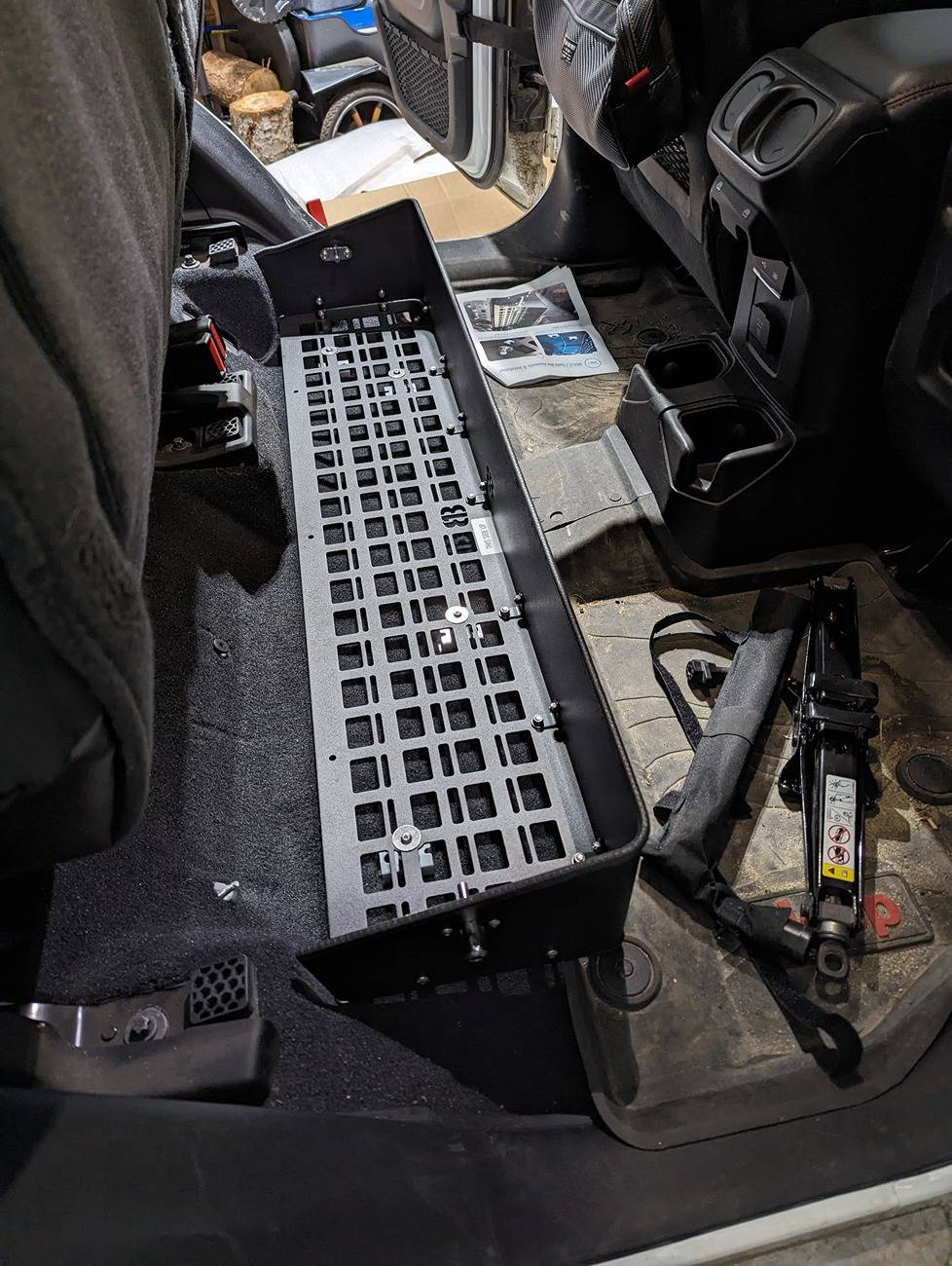

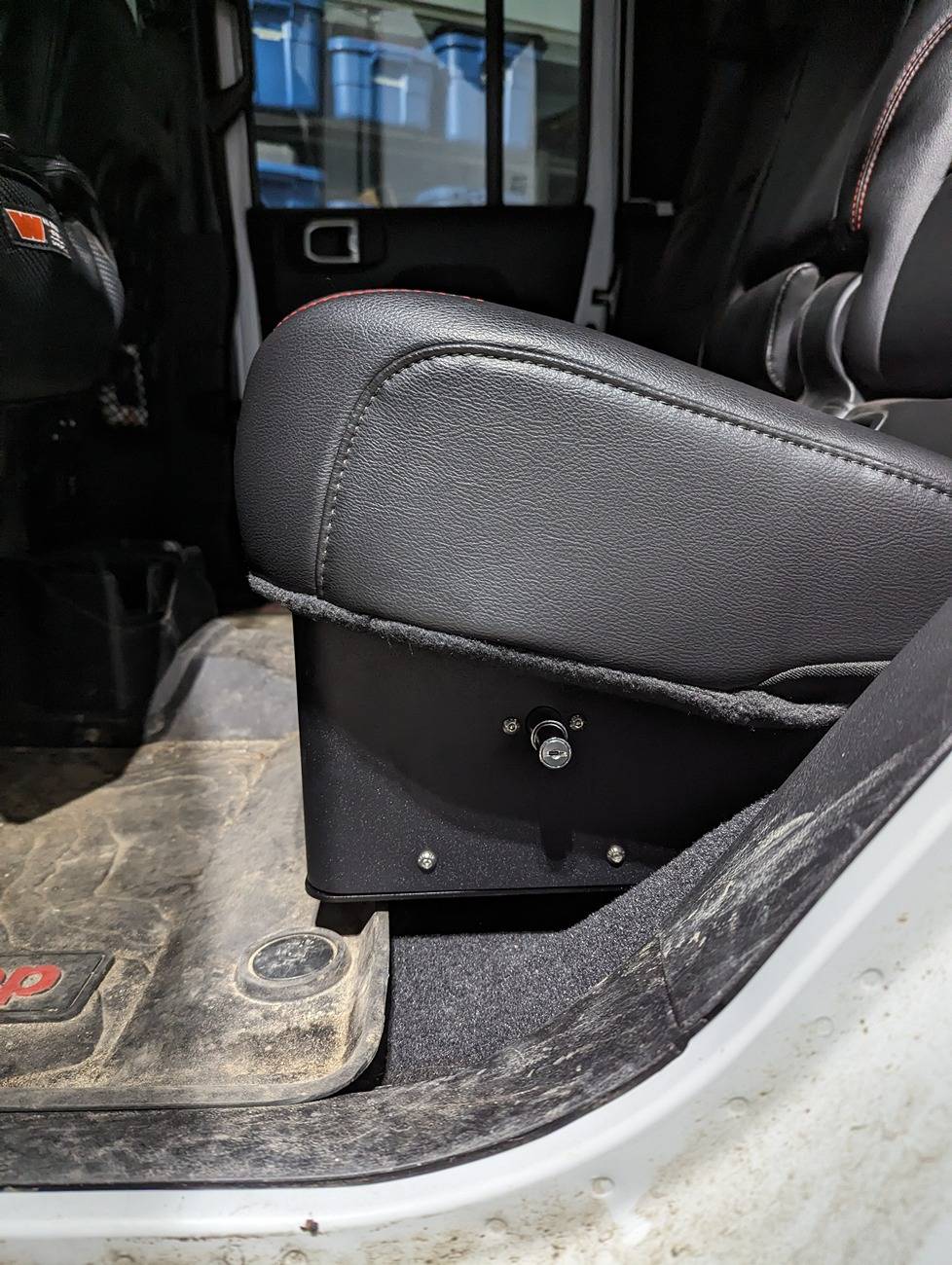

The other thing I suggest is, put stuff under your seat. I am building my electrical under the rear seats and then im running stuff to the BED. 813.Fabrications has a lot of amazing products on his website, he also hangs out here in the Jeep Forums since he owns a Gladiator. Here is what I got and what im planning to do.

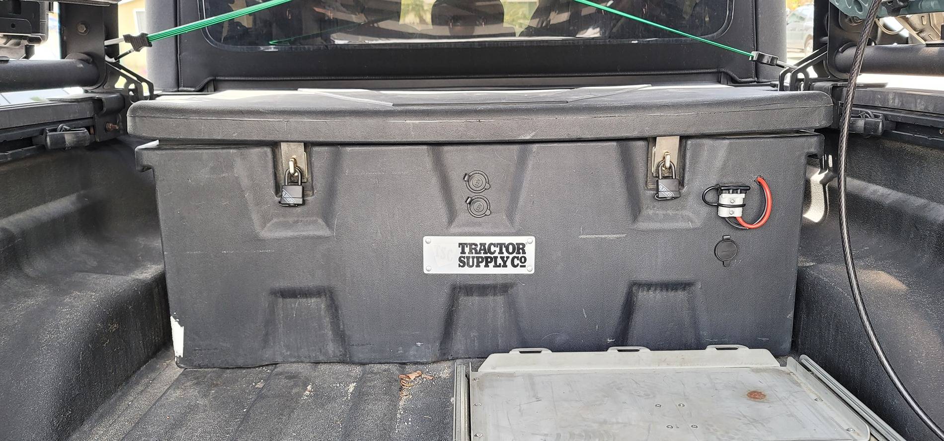

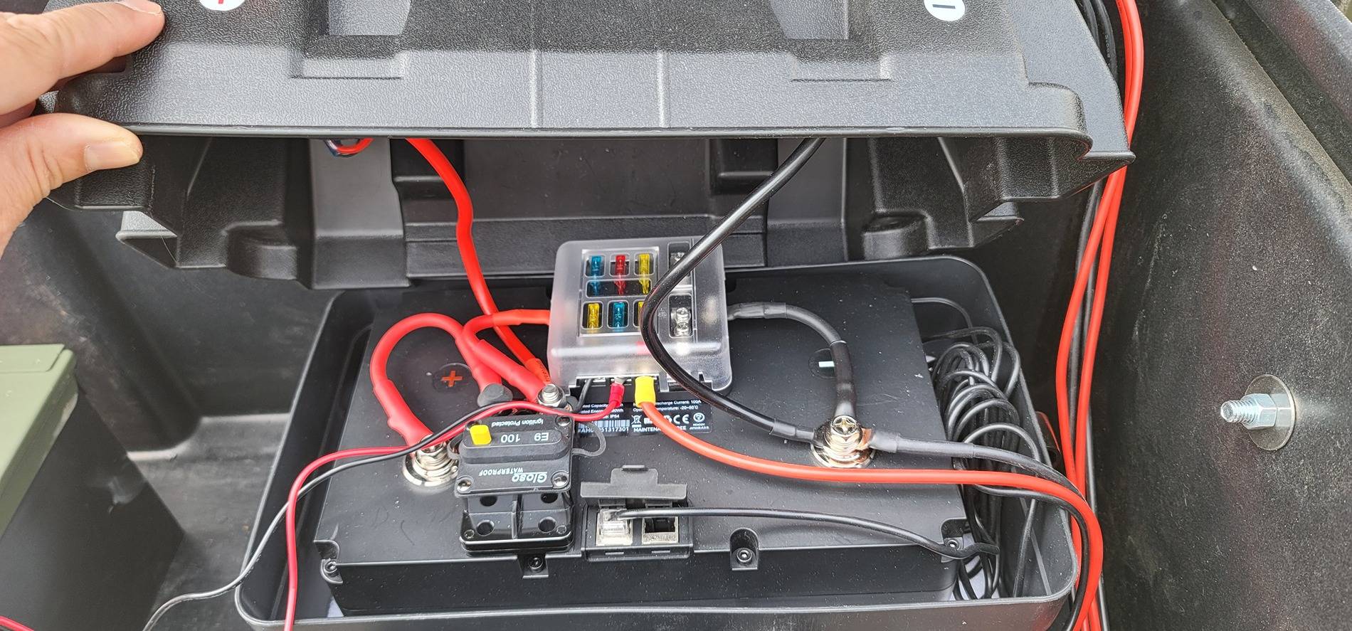

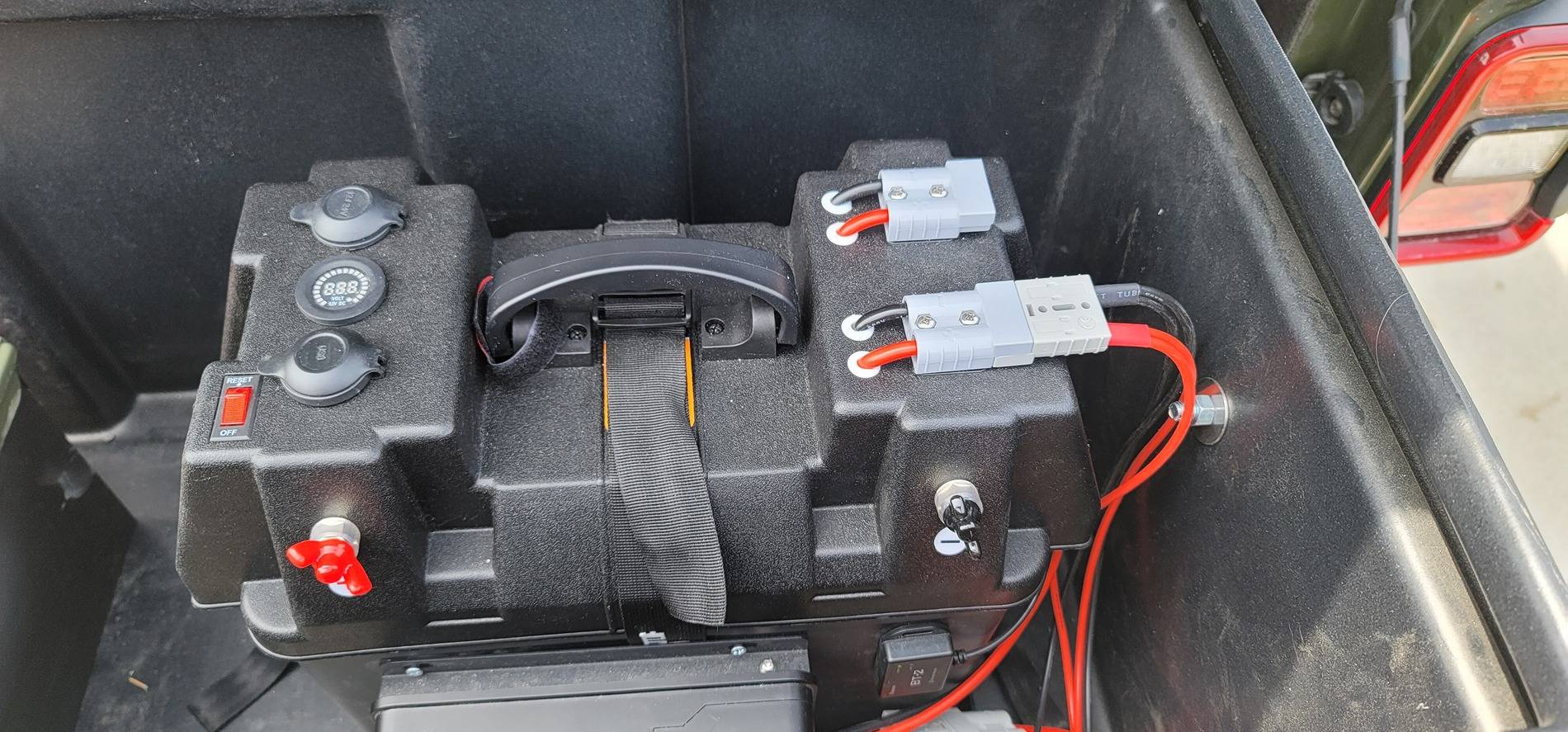

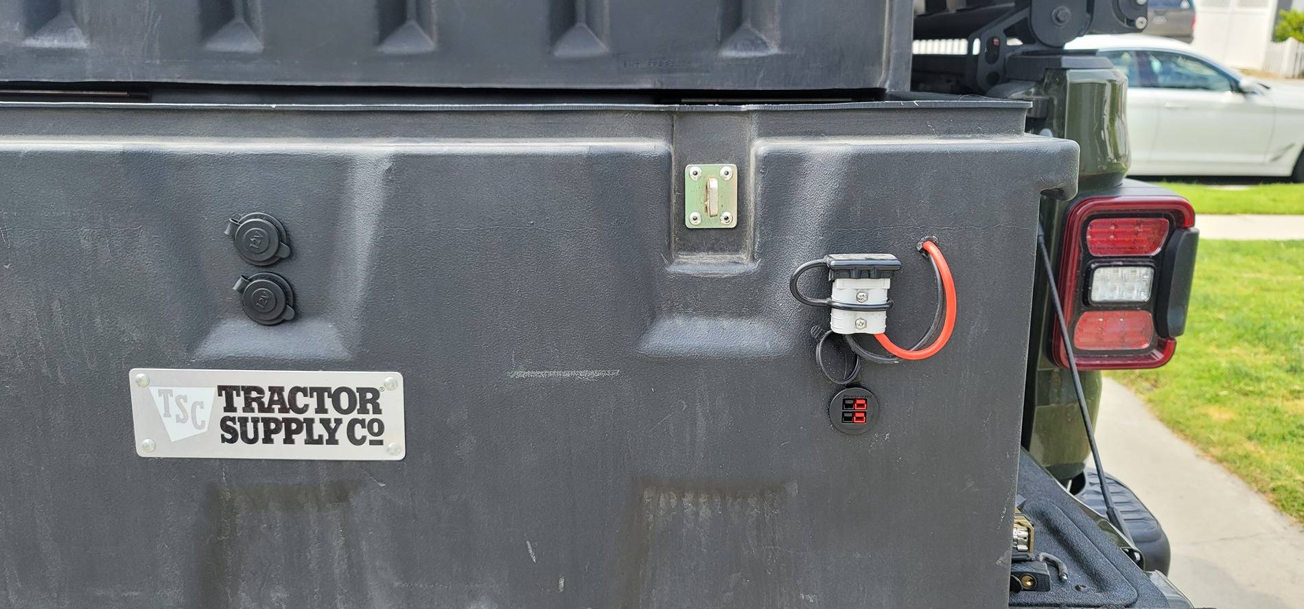

I use both victron and renogy. Renogy makes an affordable dc-dc/mppt controller. Kickass also has one prewired with andersons for easy connections. I've built a simple system for mobility reasons (but will go with a more permanent solution since I've gone to a more dediated build out of the truck). It's just stuffed inside of a portable battery box with built in 12v/usb connections and anderson connectors. Wired my controllers and other connections with andersons as well for easy disconnect. My original setup had a tractor supply tool box for some added weather proofing and theft deterrence. Ran it like that for about 6 months before adding a rack.

In addition to the space under the rear seats - the plastic panel behind the rear seats conceals a ton of useful space for connectors, fusebox, ground bus bar etc. And the space taken up by the driver's side tray/pocket behind the seat is just about perfect for a large house battery. You can probably fit a 300 Ah battery back there and still be able to use the seats.
You do have to remove the plastic panel to make use of that space. And everyone is correct, you WILL break some connectors off removing that panel. (I'm going this direction as I need the space on the floor for other things with my particular seat-delete / dog habitat plan) I expect I'll fab up my own replacement cover from light plywood or coruplast.
