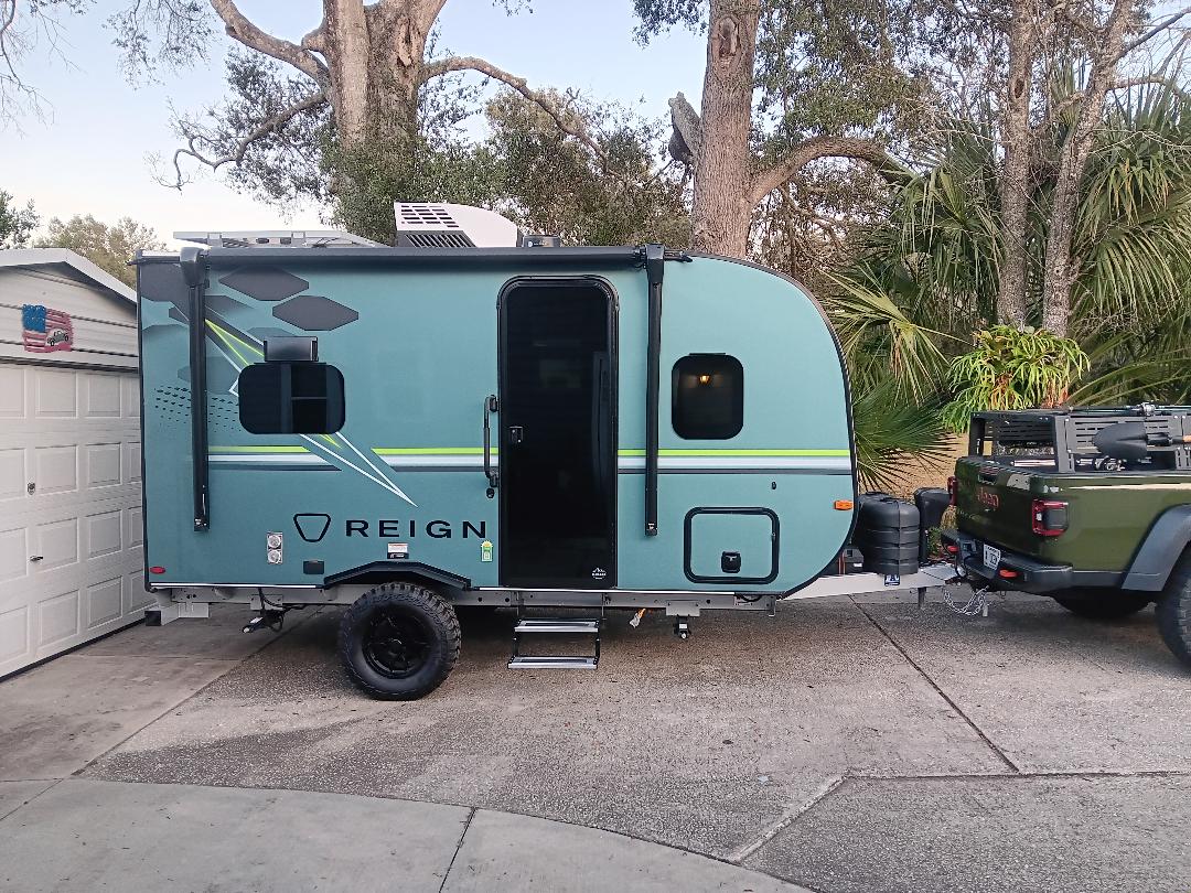

Sold my Aliner Scout. It wasn't fulfilling my requirements, and I needed something a little bigger. Knowing going bigger I was going to be adding weight, which was the main reason I bought an Aliner, to keep the weight down. So, I set out to keep the camper under 3K lbs.
2026 Keystone Reign 13RB. 2970 lbs. Couple of key points that drew me to this one.
1. Automotive Aluminum Skin. Painted in automotive grade paint.
2. No wood. Composite roof, floor. Aluminum framing.
3. BAL Huckbolted frame, not welded. Powder coated
4. Dry Bathroom.

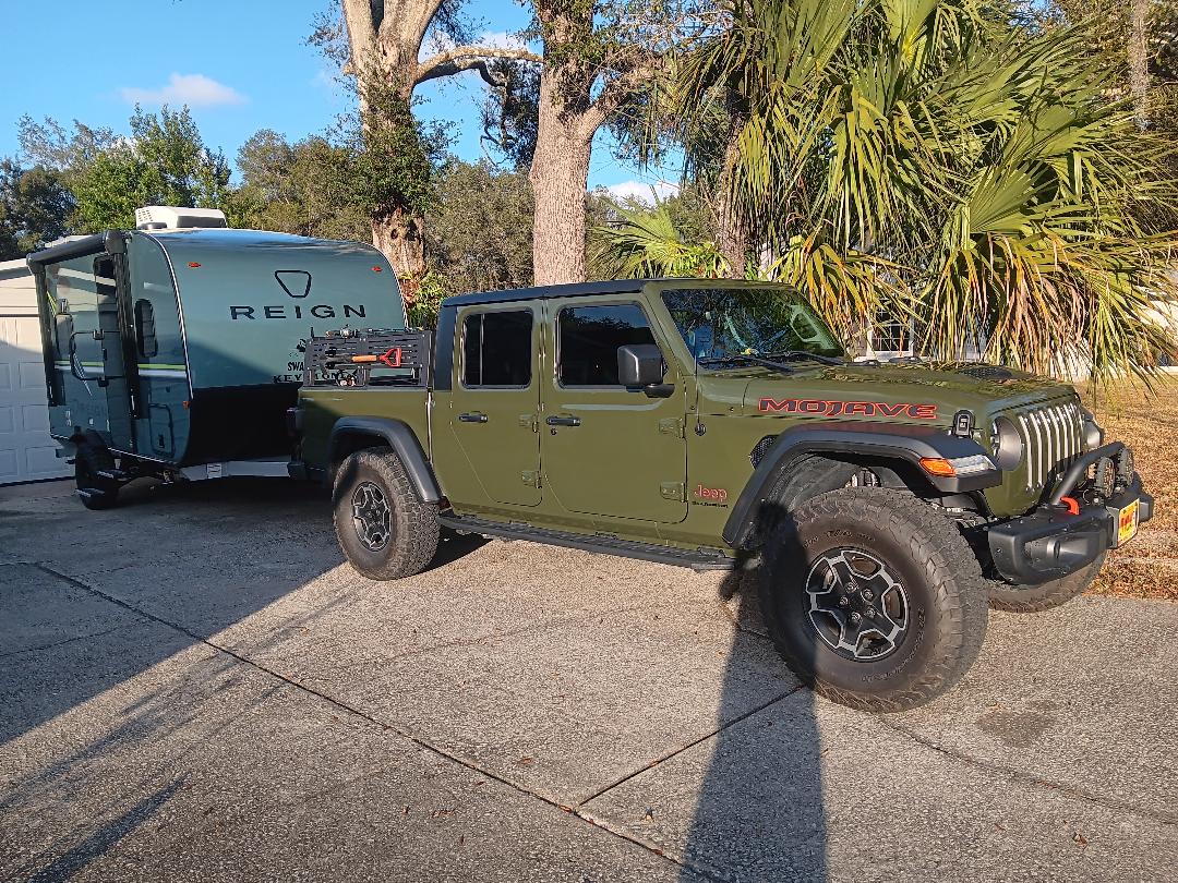

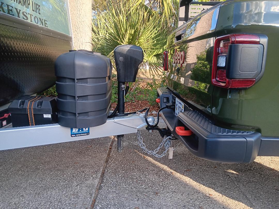

First trip was 175 miles one way. I decided to try and manual shift the whole way. It felt better, but the gas mileage results were the same. 10 MPG. Rear end sagged 2 inches. I took out one of the propane tanks to cut hitch weight. If I remove the Rebel Offroad rack I'm sure the drop would be minimal. No WDH or sway control. Is it needed? Not sure. Overall I enjoyed the tow and felt safe in all aspects of the trip. Interstate driving at 65mph and passing or getting passed by a semi I did get some wiggle in the rear.

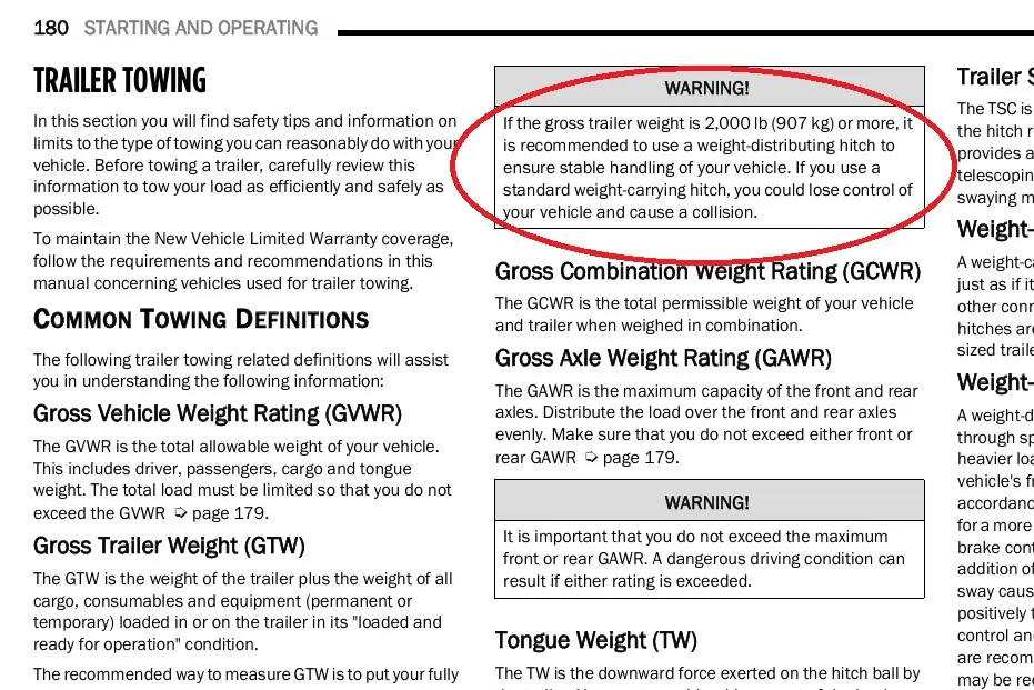

WDH is what you need your hitch weight should not be that bad but if your rear is sagging your front is probably getting light. Awesome choice, it is hard to stay at 3,000 pounds and have a dry bathroom.

Looks great, mojave suspension is softer I think, might cause more sag? WDH will help.
You will 100% want sway control in a crosswind, and you'll also want to transfer some of that tongue weight to the front axle. It will ride even better once you get a good weight distribution hitch dialed in.
