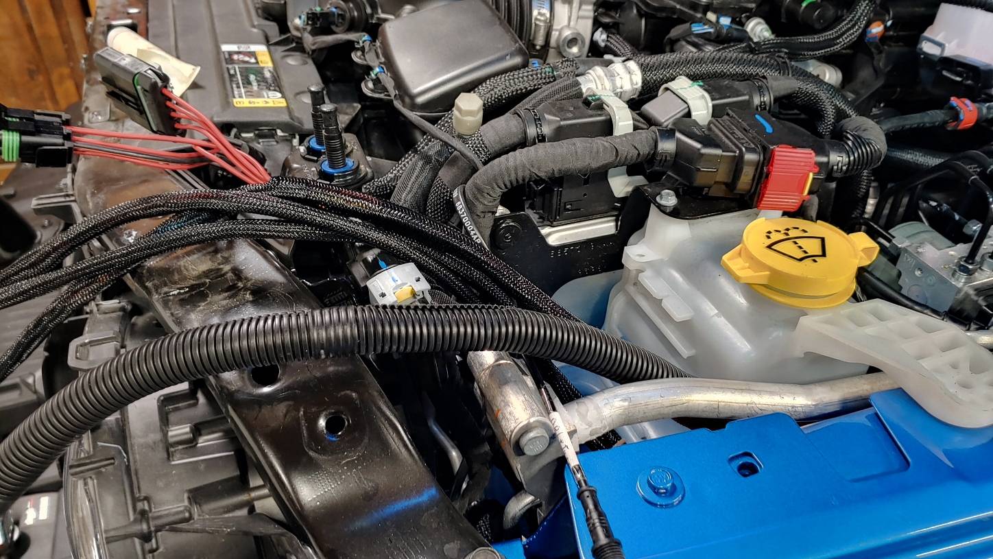

I power wash my engine bay every 2nd or 3rd time I'm at the car wash.
All it takes is some dielectric grease to keep water from abuse out of the connectors.

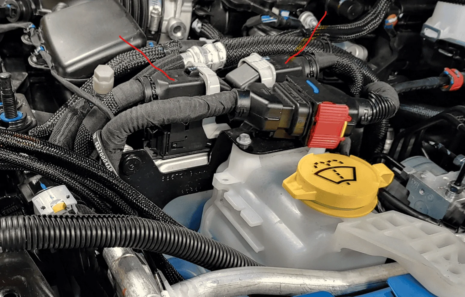

Jeep Gladiator Waiting for the tow truck.. My 2023 Gladiator Mojave has all of 3500 original mikes.  We take a weekend getewayand around 250 mi the engine warning li PCM-GPEC-compar
GPEC2A connectors right behind the hood switches - on the engine side of the module with a NA market Jeep
Jeep Gladiator Waiting for the tow truck.. My 2023 Gladiator Mojave has all of 3500 original mikes.  We take a weekend getewayand around 250 mi the engine warning li 1715552617120-ri

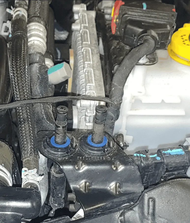

GPEC5 connectors clear up on top of the module - deep water, some nasty stuff, to get those soaked ->
Jeep Gladiator Waiting for the tow truck.. My 2023 Gladiator Mojave has all of 3500 original mikes.  We take a weekend getewayand around 250 mi the engine warning li 1715552784775-49
With all of the bracing and brackets and framework and other stuff - not sure how you'd get those wet - but I suppose it happens.................
