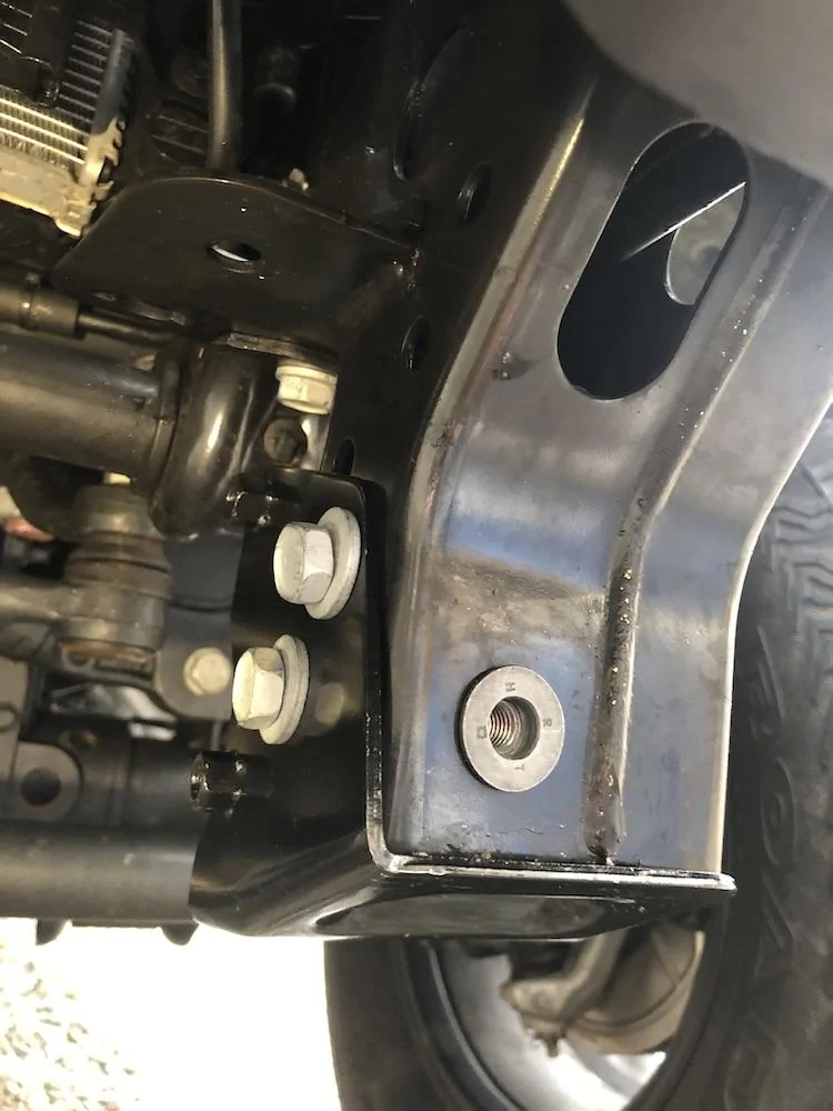

Thanks for the write up on this Rick. I am attaching a picture of the driver frame rail on my Sport S that doesn't have this additional angled bracket. It seems this is going to be needed to get the factory JTR skid plate installed on a non-rubicon model.

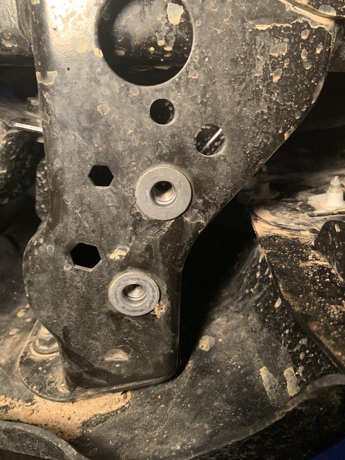

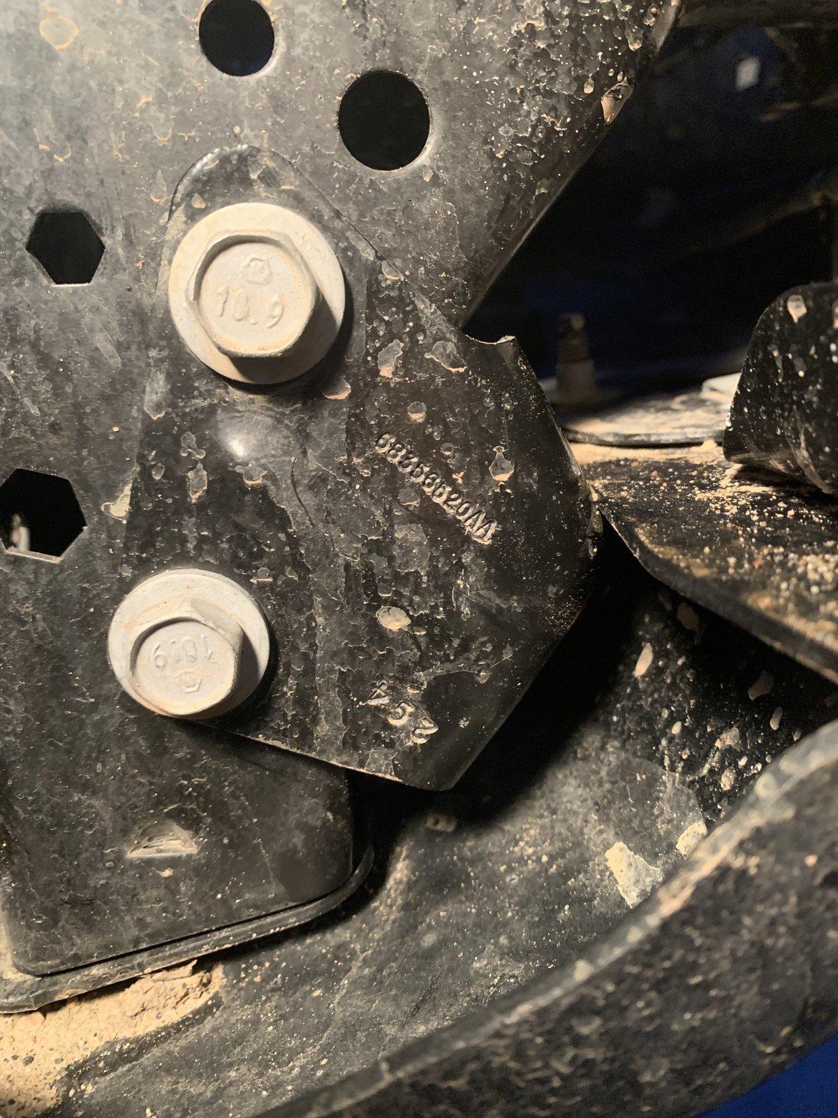

Here is the info on the additional brackets mentioned in my previous post.
They are part numbers 68356520AA (passenger side) and 68356521AA (driver side).
Here is a picture of the passenger side bracket on:
Jeep Gladiator Installing Stock Rubicon Skid Plate on Sport LeftWith
And here is a picture of the bracket off:
Jeep Gladiator Installing Stock Rubicon Skid Plate on Sport LeftWithout
An important thing that I learned when looking at this very closely was that in the first picture, you can see the bracket in contact with the (steel) bumper.
When I pulled the bracket off, I noticed that there was a considerable amount of stress at the contact point. That is, the bumper was jamming hard into the bracket.
This helped to explain why I had such a hard time getting the skid plate bolted on... I think it's because the bumper was having a hard time getting close enough to the frame... because these brackets were impeding it.
It also helped to make clear that these brackets are not needed for the combo of the steel bumper and the 82215183AB skid plate.
This weekend, I'll likely pull the skid plate off and re-torque the bolts on the front bumper, just to make sure that there isn't any slack in there.
BTW: While I got the bracket bolts out easily enough the rivnuts didn't come out. I didn't make that much of an effort, but I'm happy to take advice on that.

btw: I think that the rivnuts are 6511076AA

The rivnuts don't come out. They create a threaded bolt hole where there was previously empty space. They are meant to be a permanent install.

I don't have time to look up the part numbers, but there is a total of 4 brackets, 2 on the bottom of the frame horn and 2 on the side of the frame horn as well as the associated bolts/rivnuts
I do have the 2 that came off the side of the frame when I took mine off, I'll have to look for them but I am about to be gone for a couple of days
All the part numbers should be in this thread... copying from above and summarizing
Four mount points for the steel skid plate for the Rubicon plastic bumper...
Forward mount points: 68356520AA (passenger side) and 68356521AA (driver side).
Rear mount points: 68353836AA (driver side) and 68353836AB (passenger side)
(Fastener info in the post from @natepdx)
