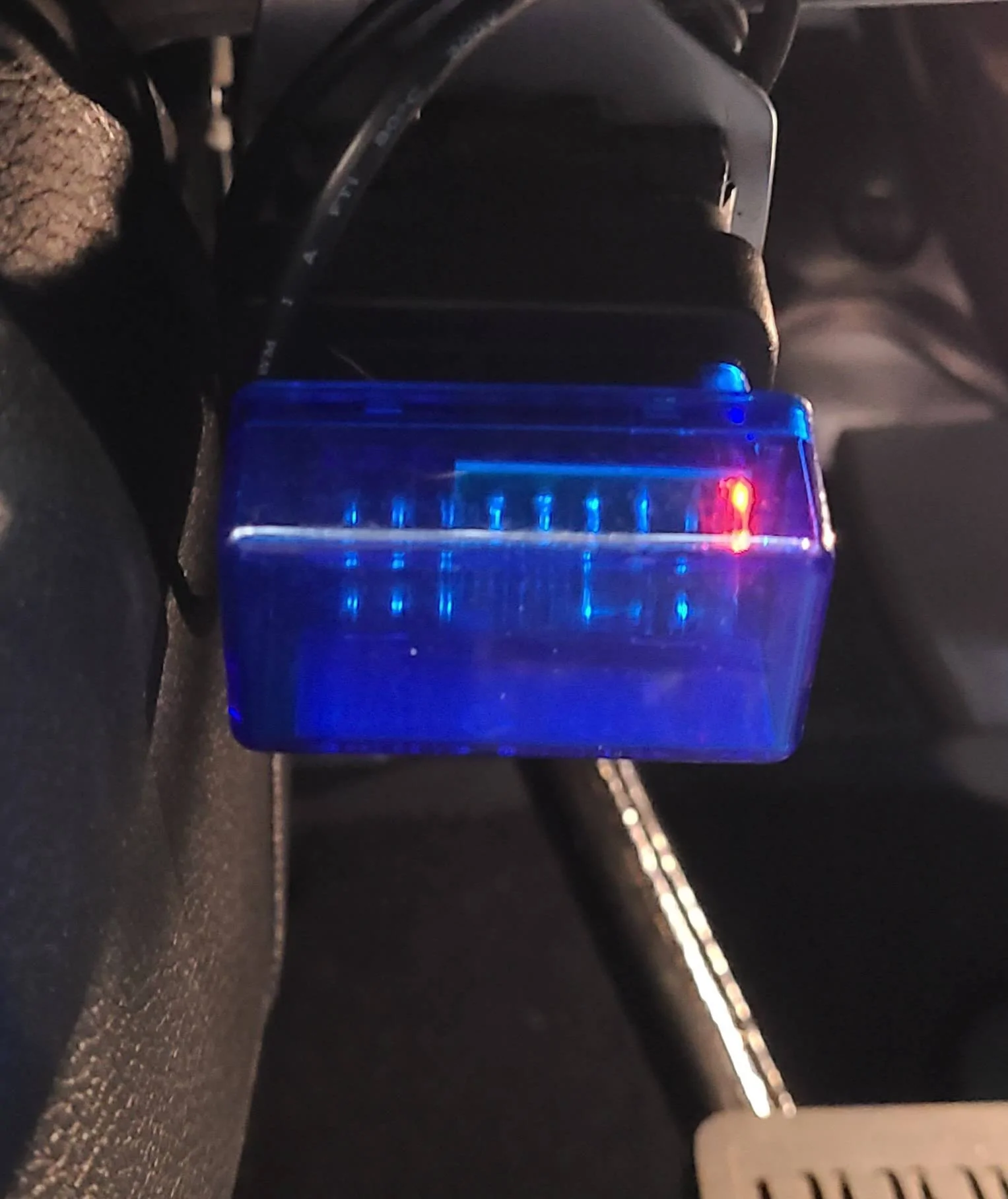

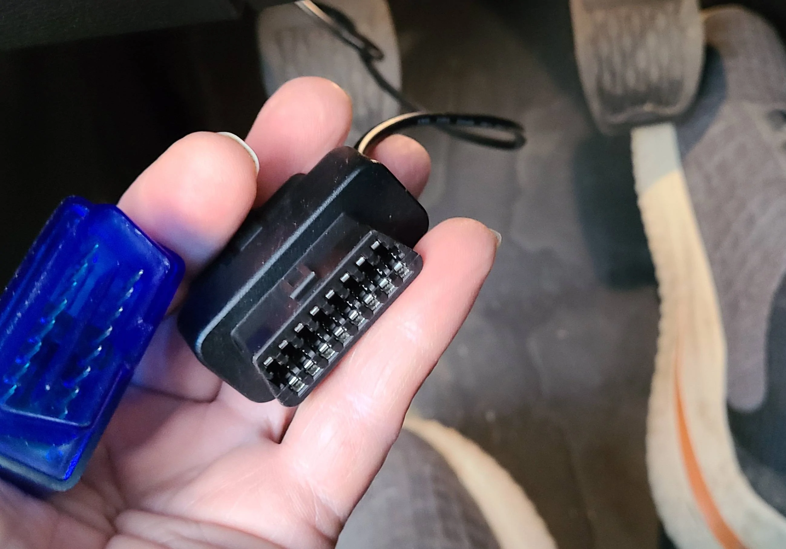

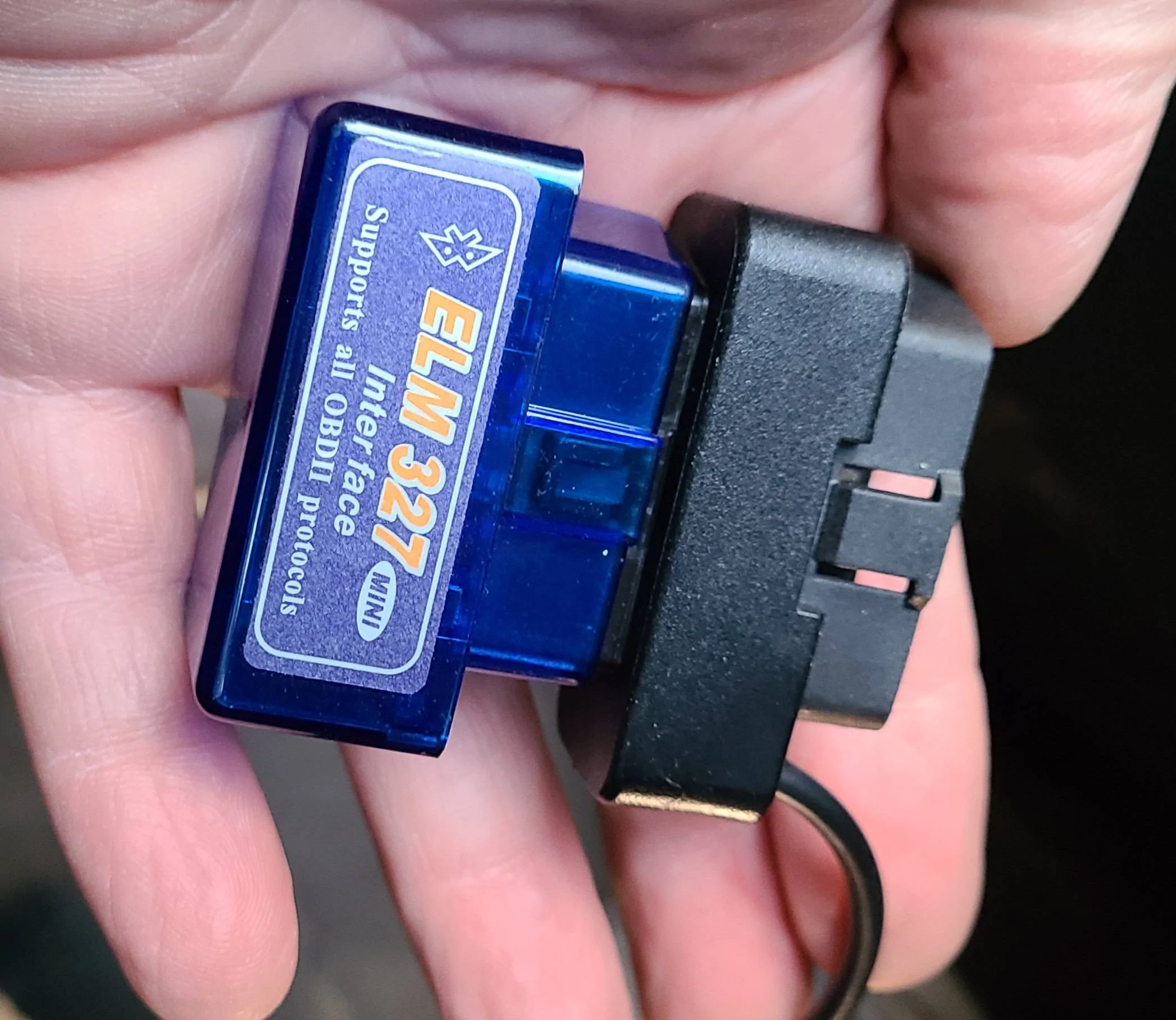

Maybe I'm mistaken, but I thought that I read that this bypass cable adapter was only needed if you used an Apple phone to connect (I'm connecting to a Samsung S20). Anyway, what is this adaptor looking thingy that came plugged into my OBD receptacle from the factory? I've tried plugging my old cheapy dongle in both using it and directly in, with the same results (I can see everything that's going on, but I can't make any changes to my settings).
Bypass cable needed regardless of phone. Checking in with note20 and now an s23 ultra.
As for what the other bit is, i'm guessing GPS tracker installed by dealer.
You can't make any changes because you're not plugged into the security gateway

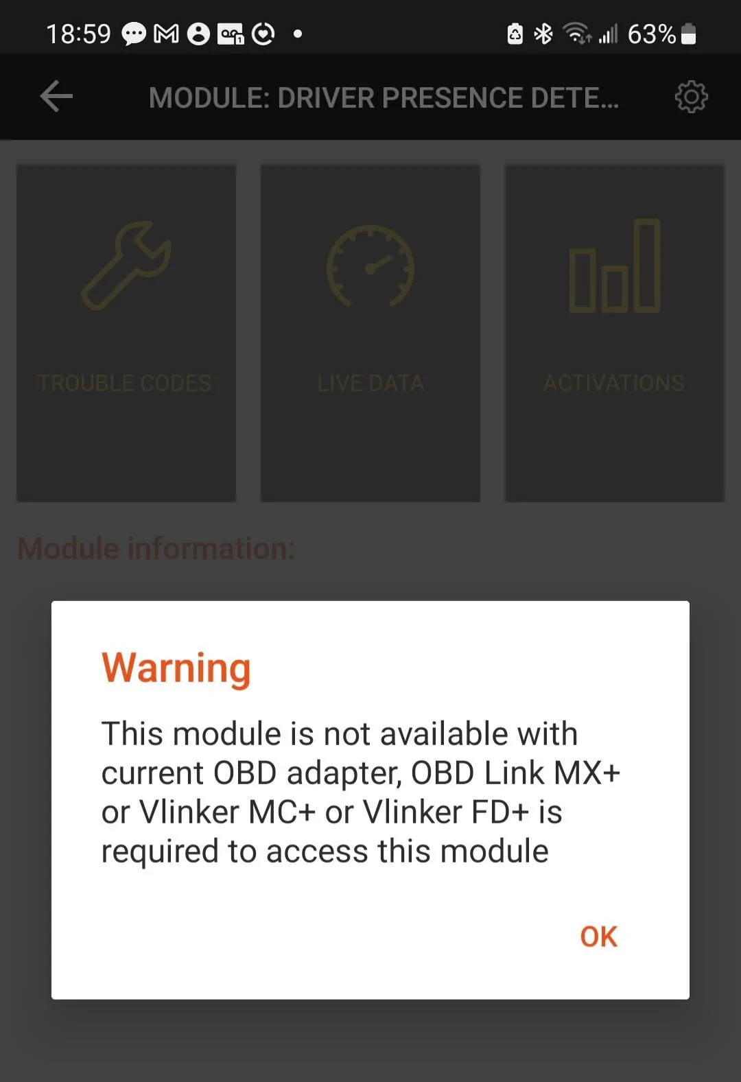

This is message I get whenever I try to change anything in the Activations section, so I still think that I need a new BT dongle (besides that bypass cable adapter).
Ok, I just ordered both the latest version Vgate vLinker MC+ and the bypass cable adapter via AliExress for a total of $54.16 (estimated delivery date: Apr 27, 2023). Thanks all!
