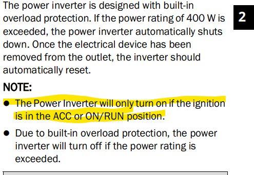

Anyone who gets the inverter, gets an outlet on the back of the console. If the Trail Rail package is added, an outlet is included in the bed with an on/off switch in the cab. The single 400 watt inverter powers both outlets. The inverter only works when the ignition is on. The USB ports will stay on, after the ignition is off, if there are active devices drawing power. Otherwise, they also turn off with the ignition.

The outlet in the bed is not an additional 400 watt inverter. It is just an extension of the cab outlet, with a separate on/off button. It loses power when the interior outlet shuts off.
Whenever the engine is running, the outlet can be used to charge the portable power pack. Otherwise, it is solar panels or another power source to charge it.

The truck's USB stuff shuts off after a while, but the inverter actually requires to leave the truck in ACC or RUN mode! So the inverter is a non-starter.

The inverter only is on when the truck is in ACC or RUN mode - who wants to have the thing in ACC mode all night........ and in RUN mode with the engine not running, it reverts to OFF after several minutes so you can't leave it in RUN mode.

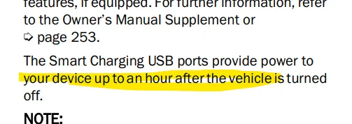

Actually, no - you can't use them to charge anything unless the draw is pretty hefty. They shut off after 60 minutes.
I've been there, done that. I've tried to charge our stuff and my hearing aids and I'd go out an hour later and nothing was working. I had to hit the ign switch and turn it off again to get the USB ports to work again for another hour.

I've proven the book correct a few times, rats - they DO shut off even with a phone and other stuff all plugged in. We lost power for almost a week in 2020 and the Jeeps were our only way to charge our phones and my hearing aids for a couple of nights.
