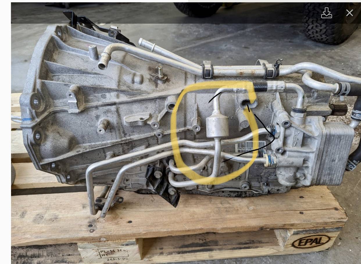

I have read on the wrangler forum that in JL, they have eliminated the thermostat in heat exchanger unit, but no i not been able to confirm the same in the JT?
Would be interesting to know if that's fact or guess.........

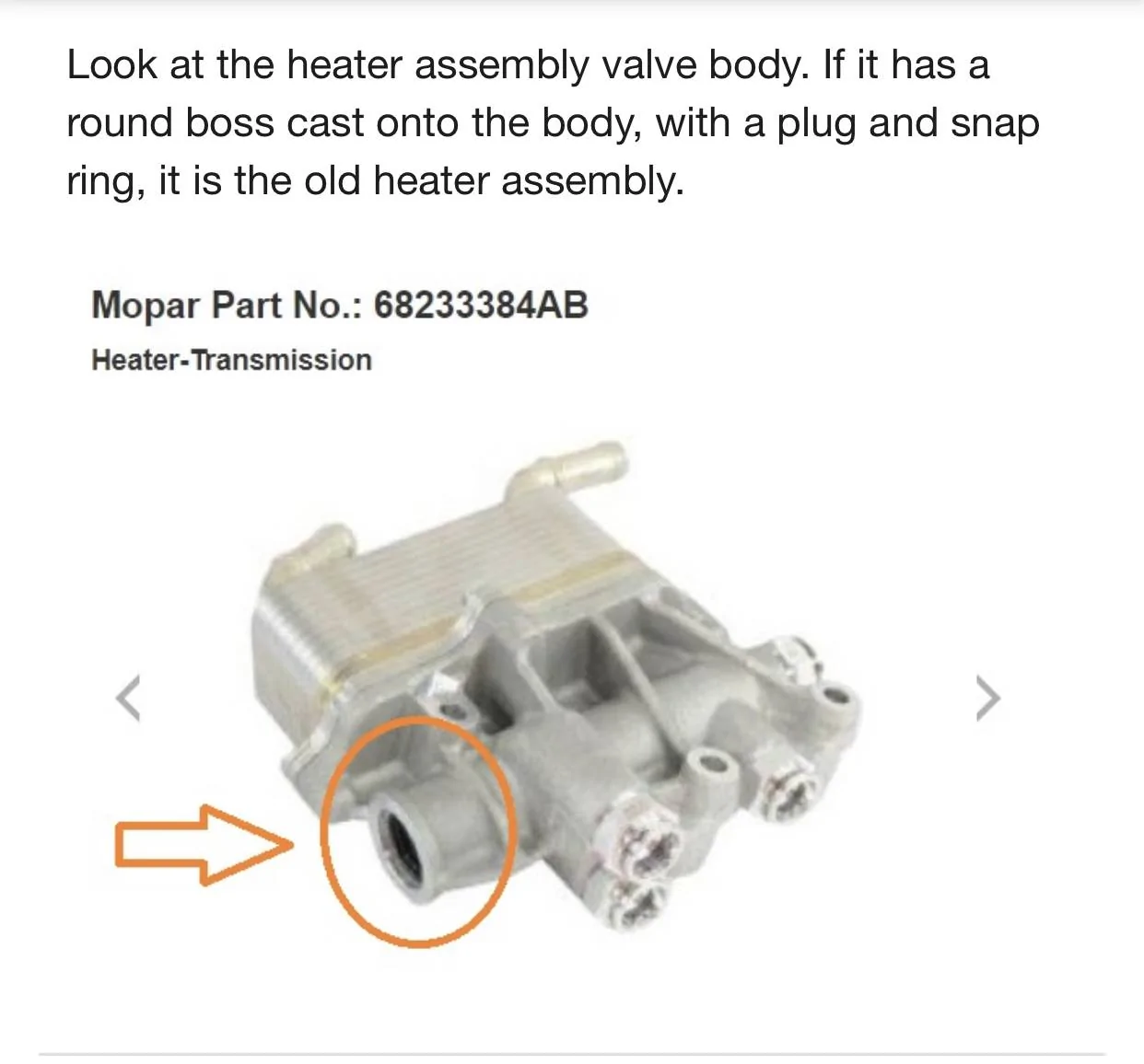

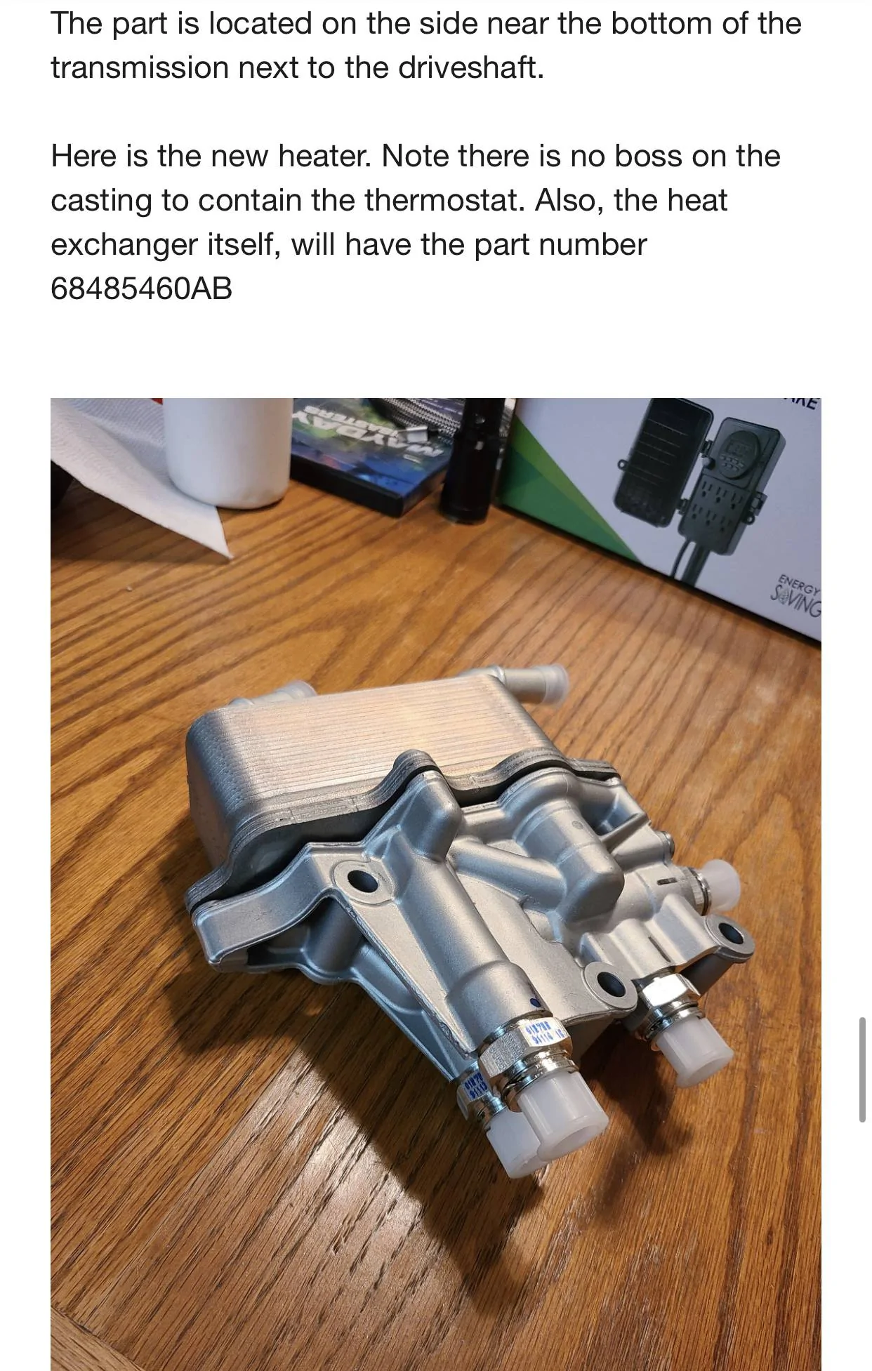

These are the old and the new type of heat exchanger. My 2021 Mojave, built in October of 2020 has the old style.
Now you have me wanting to look at my June 29 2022 build 2022 model year JT........
