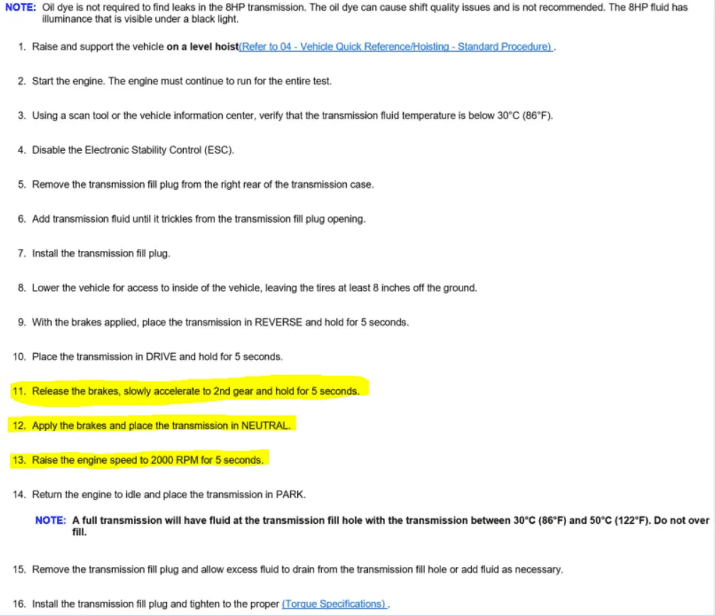

I bookmarked this the other day for future reference.
You may find it useful.
The Jeep procedure includes some steps that are not in the FCP video. I think it is just to make sure that there is no air in the system. See highlighted steps below.
