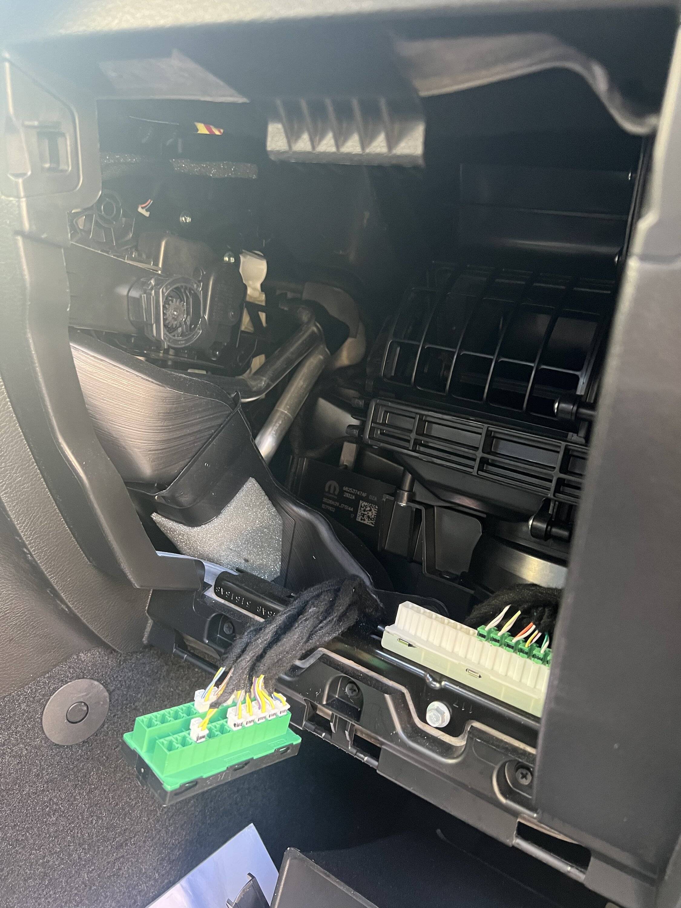

my Jeep Gladiator was stolen and by some miracle it was recovered. However the thieves removed the glove box and unhooked something from behind it. Any ideas? Thanks

Unless the tabs are broken off it should go back on that ledge next to the white colored block.

WOW, you guys missed that huge gaping hole?
Your passenger side airbag is gone, that is where that factory connector goes.

They are called Star connectors. They are used to connect the Can-IHS circuits together at one box, ans the Can-C circuits on the ither box. Pretty common way to steal Rams for the last 2 generations, bypasses the SGW

That's the view when you remo e the glovebox. That is way below air bag
Yeah, understand what they are, and that they are after the firewall, and that's why I wondered if there was a way to quickly connect to add fobs - or other changes.
They have full access to the system and can do almost anything from there.
That's the area that caused my CANbus errors last summer, communication issues and so on.
If I recall, there were changes made about 2018 that made it harder to add "keys" to these.
