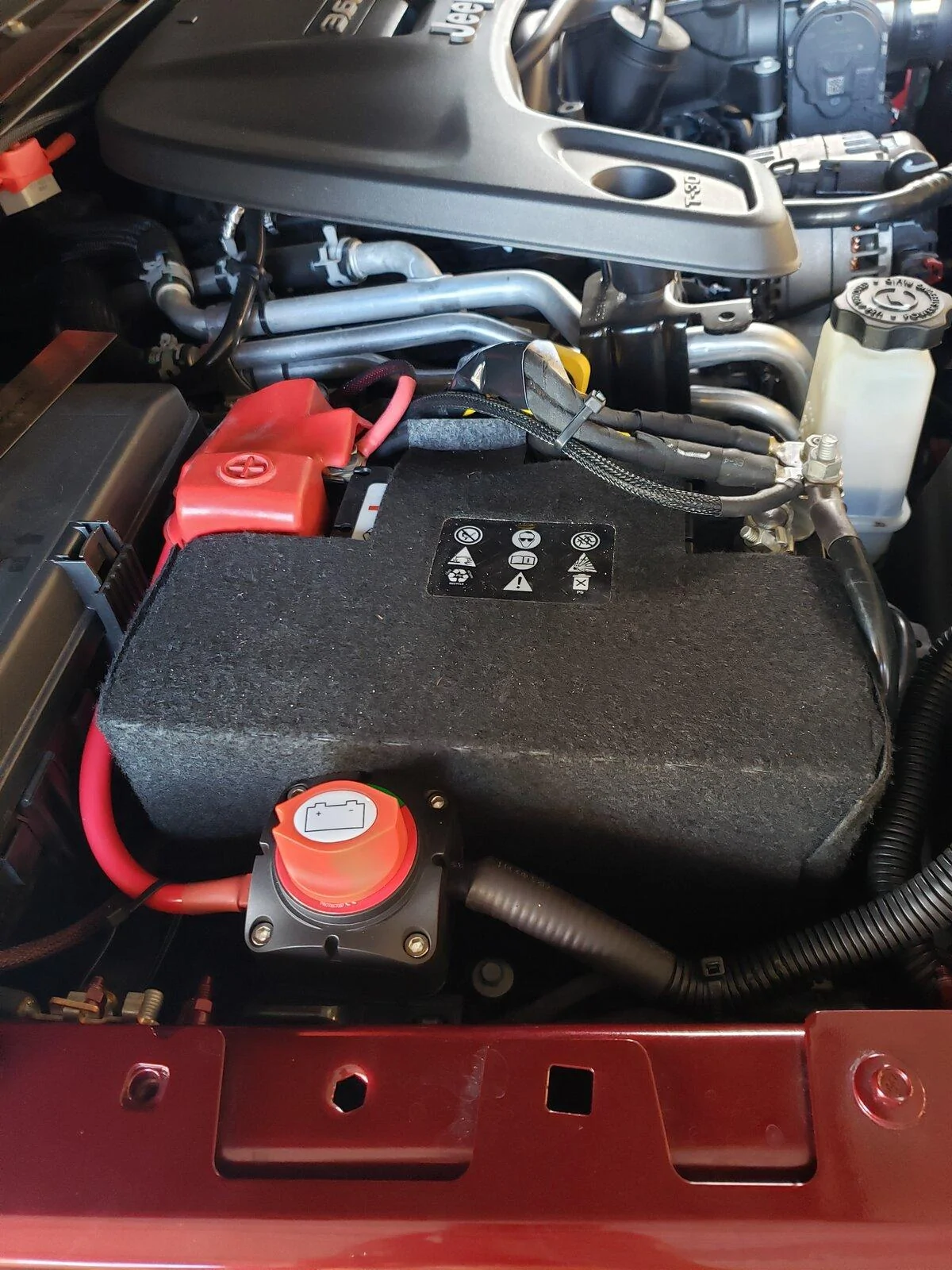

I used Aux 3 with the Warn interrupt and I’m happy with the install. To avoid the long angle iron getting near the ground lugs, I used a single bolt installation with a thick rubber washer to prevent scratches and rotation. After some significant bumps, it hasn’t budged.

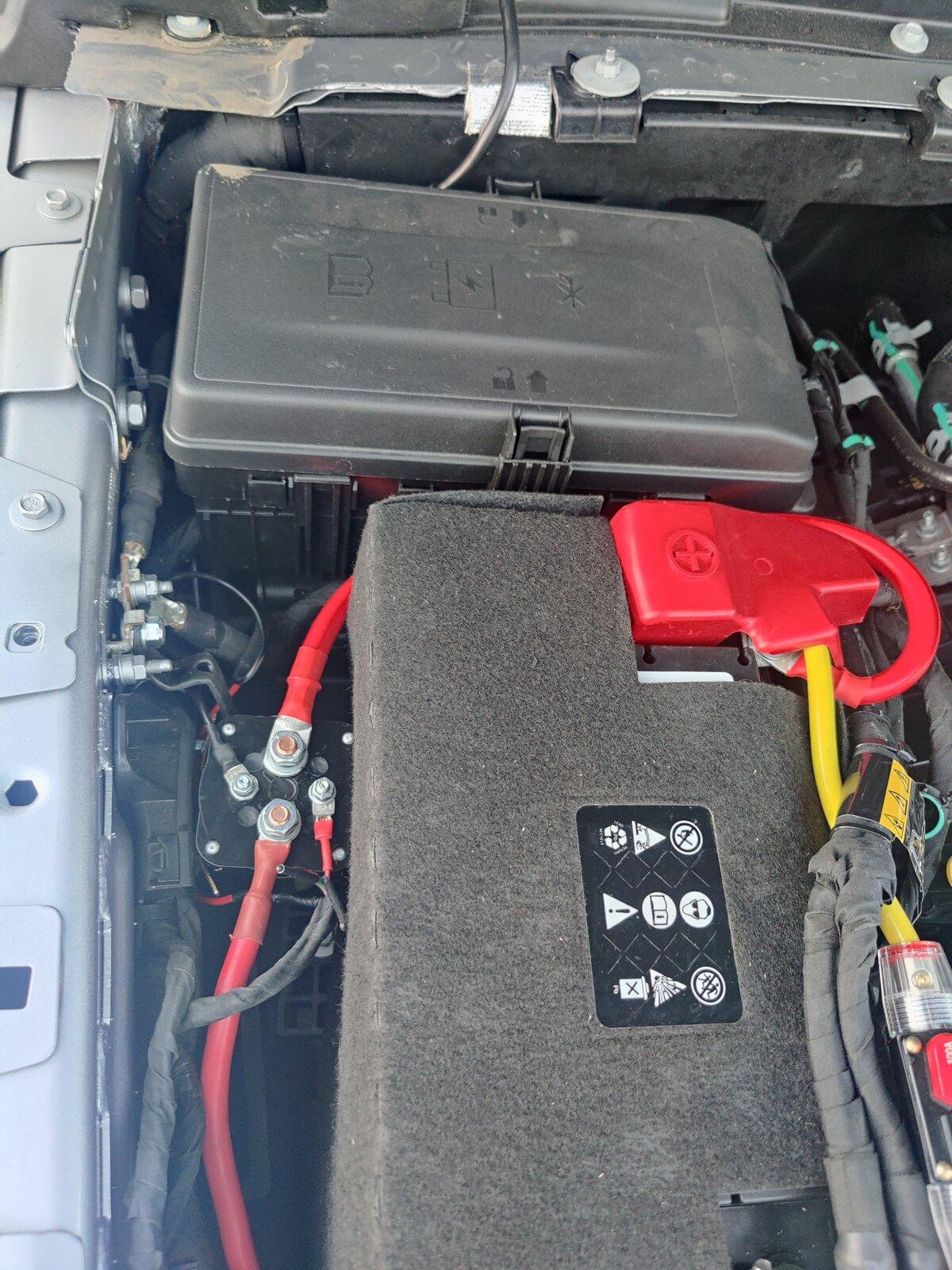

Y'all got me really thinking and I had to put my switch in.

Fits perfectly next to the battery. Connected to 15w aux cable, should be plenty.

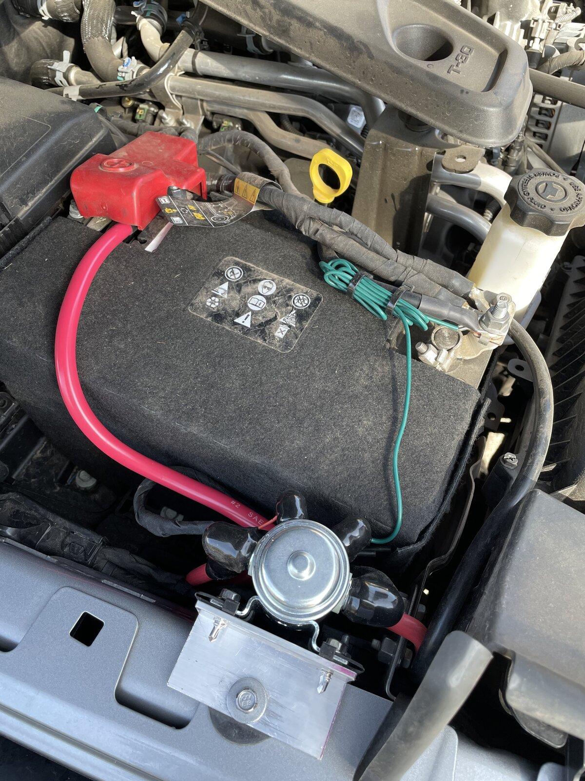

In the past (2019), I had two Warn power interrupt solenoids malfunction in another application. I have not heard of any other failures of the Warn solenoid, so this may be a very isolated problem. However, given that history, I decided to avoid the Warn power interrupt solenoid this time around. For my JTR, the winch is connected to a 500 amp continuous duty solenoid which in turn is controlled by one of the aux switches. The second solenoid is for a DC to DC charging unit on my trailer. The bracket the solenoids bolt to is fabricated from a flat piece of aluminum and bolts to the Jeep using two of the existing ground bolts. There is not a lot of room available, but everything fit.?
Please enlighten the ignorant: I like the red rubber things covering your cable ends on the solenoid side. I assume I can find them on Amazon, but what are they called?
Side question - is that the factory Cold Air Intake on the right side of the photo?
Here you go. And yes, that is the factory air intake.
