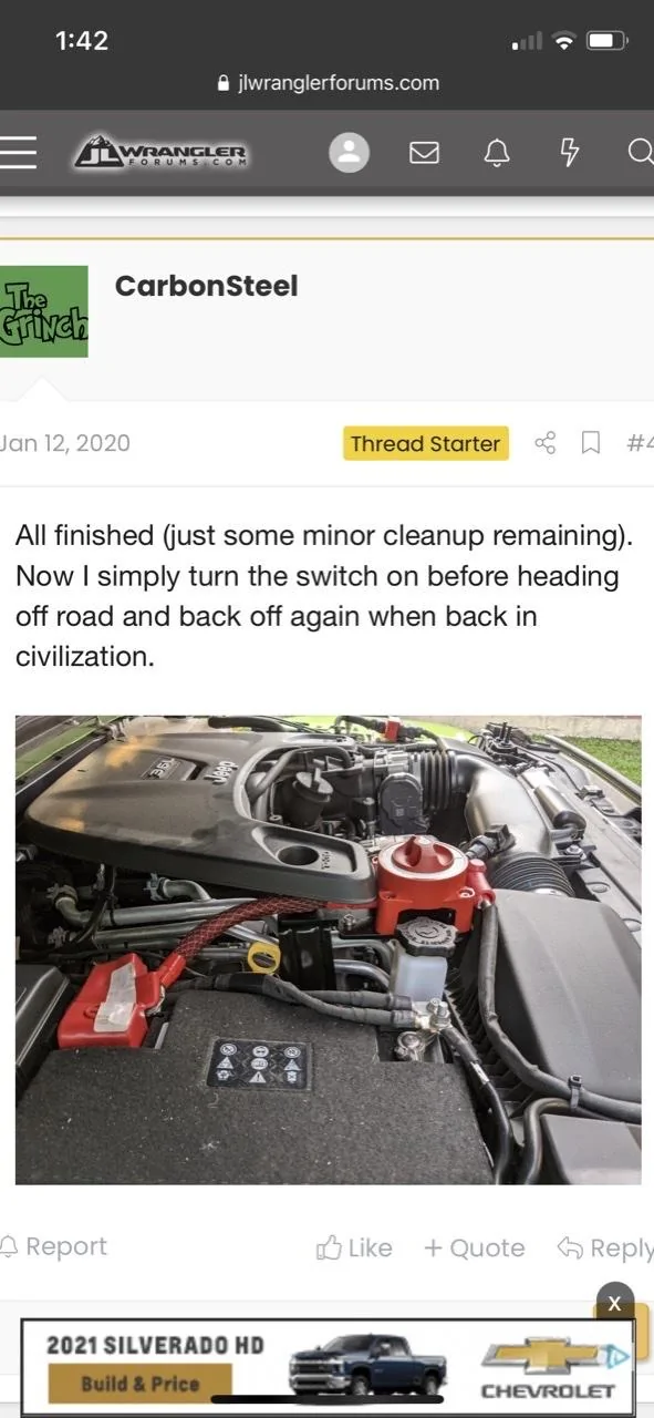

180
29,552
35,150
Not to Necro an old post.. but what type of manual switch is that? I'd love to have a manual cutoff, instead of a solenoid.
~ Casp
I'm sure those are available from various sources - that one actually came with the Apex winch.
Works fine.
