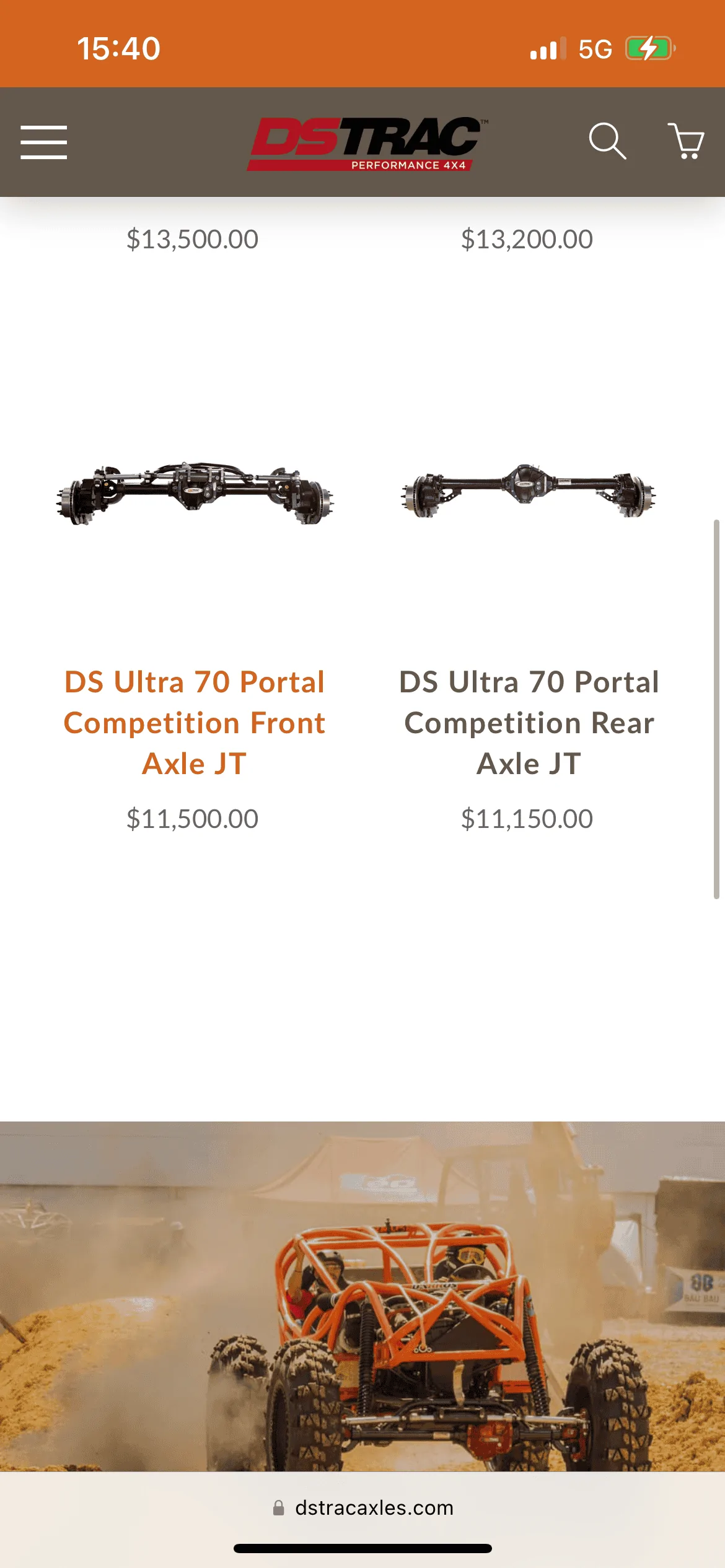

sure they are over 11k each big reason I don’t have em lol, but when you really think about it, it’s not much more than when someone swaps to a Dana 60, gears, and 40’s
With the portals no need to run 40s and that rubber is expensive.

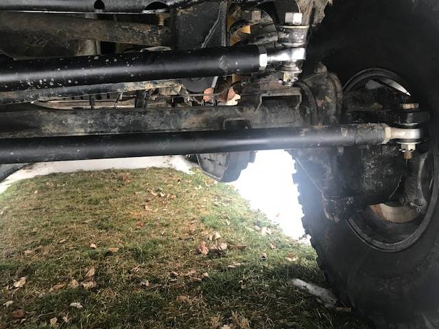

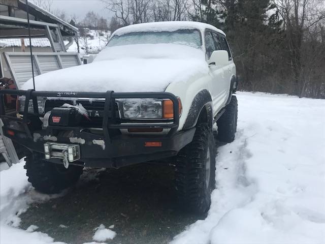

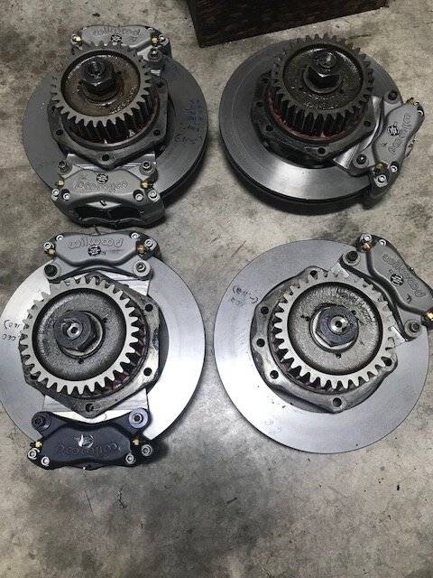

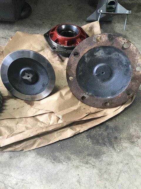

There were two in TN, one was orange and sold to someone out west a year or two ago. The other was solid white, it went through a couple of hands and ended up in PA with me. The LC was beat and trashed when I picked it up. I wheel it occasionallly.

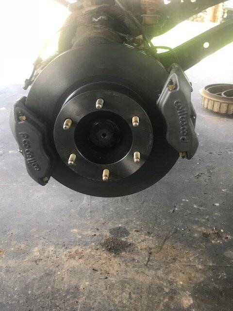

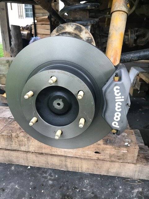

I changed out the old drum brakes to disk brakes, I did a ton of machining to convert them. The axles may be going under my 2006 LJ.
The white one is the one I seen local too me but I haven't seen it since probably 2008 or so. The guy who built it was the head guy in a local off road club called 4x4Grace.

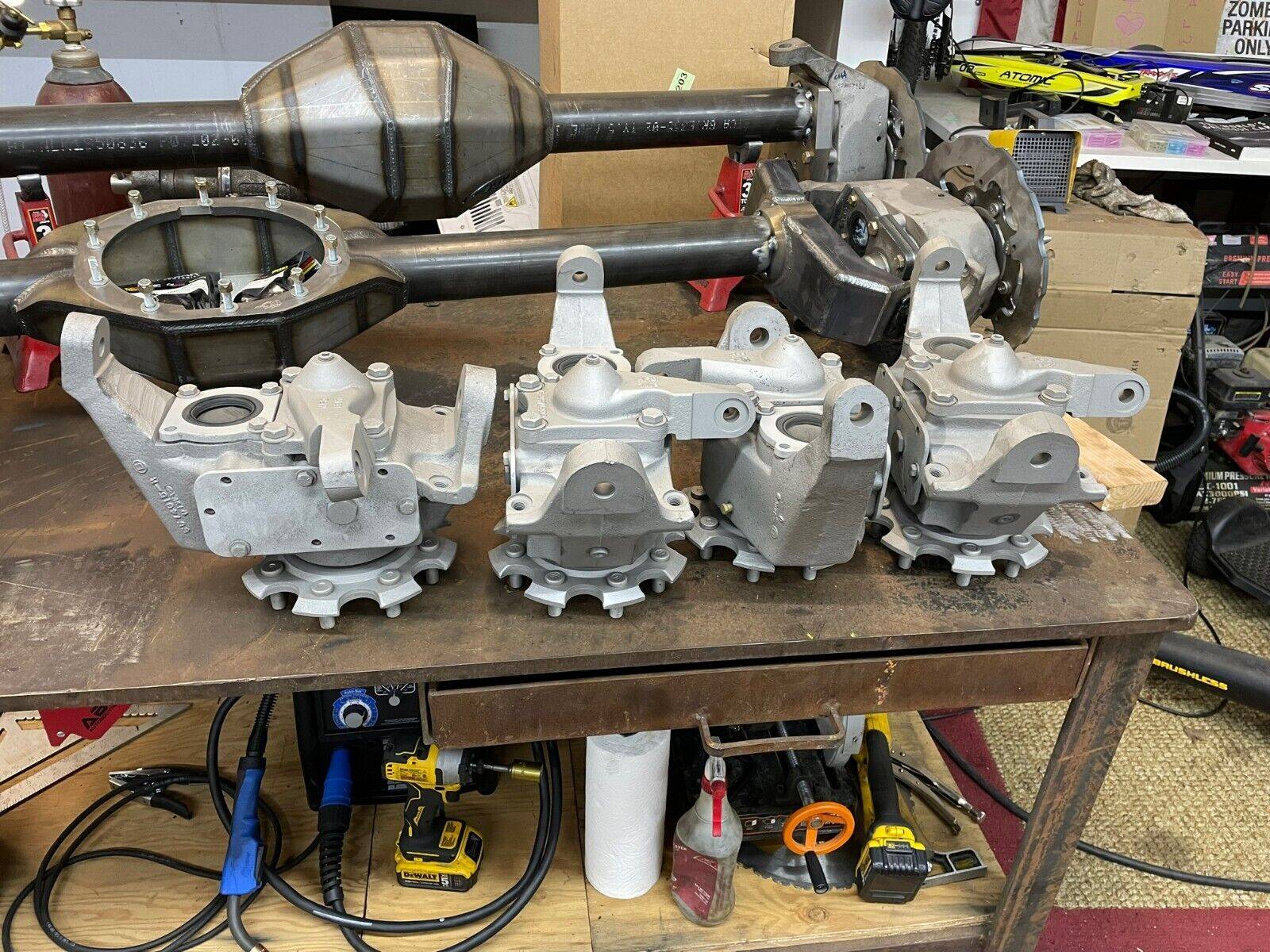

These are cheaper than the bolt on portals mentioned at the start of this thread
Yep, that is the one I have. Has the 4x4Grace sticker on the back. It was nice back then, not so nice when I picked it up.
I machined for disk brakes and redid the steering.

Having owned a portal setup rig, would you consider that rig a daily driver or a trailer rig?
Gearing will be the biggest issue, the portals I have have a final reduction of 6.0:1 so top speed is around 45mph. For me it is a trailer rig, but I did not buy or build it to be a DD. At the same time my 2006 LJ with Dana 44's and 5.13:1's is also a trailer rig. Both are registered and road worthy.
As for ride and reliability there are no issues. The portals came off a Volvo C303 military vehicle so it had huge drum brakes and a very large 8-lug bolt pattern. If I did not have a machine shop it would have been a lot of work and money.
Portals on the market now are bolt in applications. Obvious there is a cost associated with them. As with any build, planning is key.

Just for comparison, 74Weld says theirs are 1:1.22 reduction
DSTrac axles say "Portal Gear reduction 1:1.20"
I'm seeing GWagen kits that are 1.16:1
Really curious if anyone finds those to be streetable

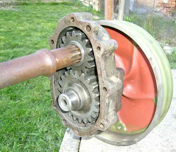

In essence they are VW BUS gear reduction boxes from the 1950's

The HMMWV’s have this same setup, wonder if you could find some scrap parts and make them work? ?
