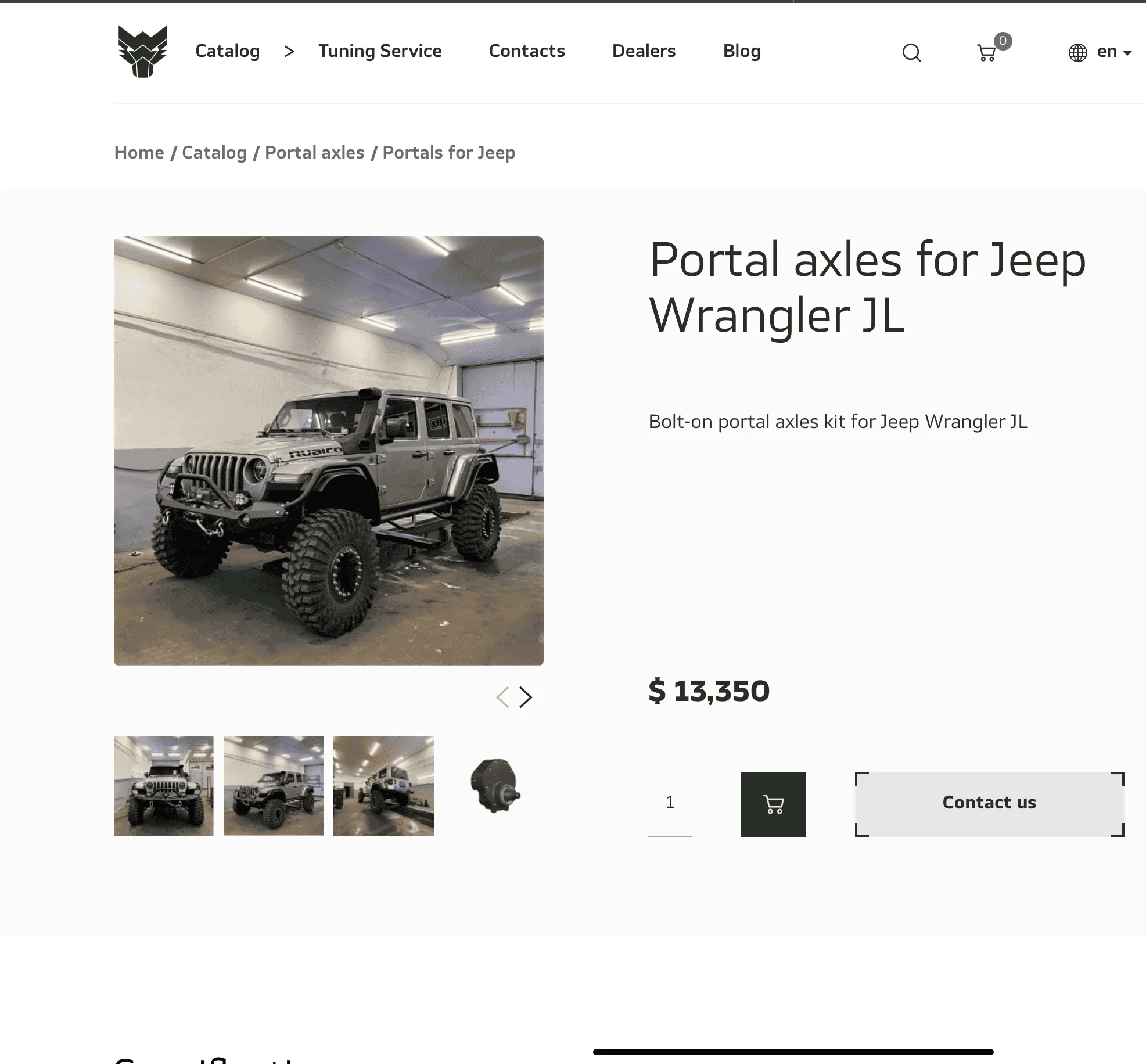

Just for comparison, 74Weld says theirs are 1:1.22 reduction
DSTrac axles say "Portal Gear reduction 1:1.20"
I'm seeing GWagen kits that are 1.16:1
Really curious if anyone finds those to be streetable
Adding WerewolfTech at 1.36:1. But, math is math, I don't understand people saying it wouldn't, given the proper gearing is already present before installation. I'm on 3.73, with 37", 1:1.20 is totally reasonable for me to run with the weight that I have back there (also on the diesel). Another thing I've heard that would make it slightly annoying is that the straight gears would mean the truck can rock back and forth in parking mode.
Not doing it now for pricing reasons: to do things right as others pointed out, it's not just 20k or so for the portal, but more like 30-35k. The second reason is because of bellow:
I will say, I'm a little disappointed that 74weld didn't include a CTIS option. CTIS definitely has reliability concerns but airing up while driving just seems so cool :)
100%; I've asked Quinn about this (74Welds), pointing out that's a big missed opportunity. To which he replied something along the line that having air in it would be terrible for the reliability or something. So maybe I was unclear, or their engineering dept didn't know about CTIS?
I asked a second time a few weeks after and they said maybe in the future, so I guess they know now.
Feels like a full axle set would be best anyways, as I would never bolt this on my DANA 44s and current my payload. Too bad DSTrack also isn't CTIS compatible. The only ones at the moment that are bolt-on and CTIS-ready are the Werewolf. I reached out to them as well not so long ago and said they were in full production. Pretty busy with the war as they prep vehicles for the field there, but can take orders *last time I checked*.
EDIT: For what it is worth, I've asked both 74Weld and Werewolf about those highway fears everyone has and they said that this is not a thing. Both over-engineer their gears, Werewolf has videos where they open 2y old portals that were driven in all kind of conditions and the gear are fine. 74Welds are younger but they say they also do a lot of highway without issues, I would take this with a grain of salt compared to the 2y of Werewolf and the fact that they have multiple vehicles running them (Yotas, Defender, Wranglers etc IIRC).
